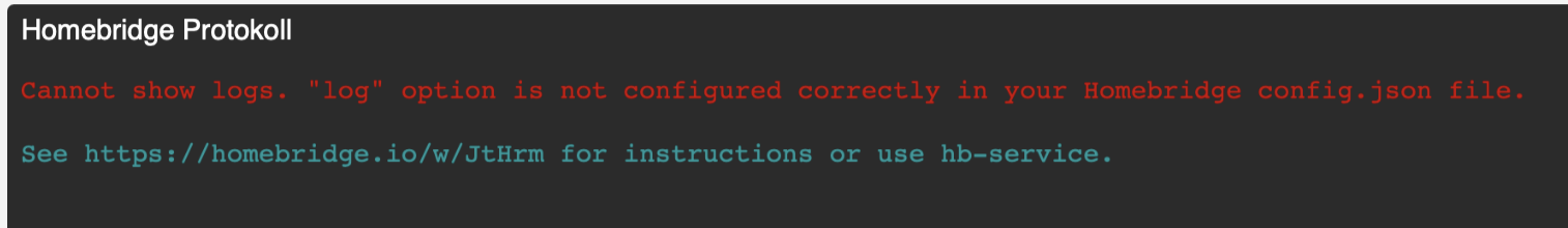

HomeBridge-with-webGUI
I installed the app but it seems that there is still an issue regarding the logging. I tried to understand the hints in the link but I didn't get it.
Can someone help me out what to do?
Thanks in advance. 😁
Cannot show logs. "log" option is not configured correctly in your Homebridge config json file.
See https://homebridge.io/w/JtHrm for instructions or use hb-service.

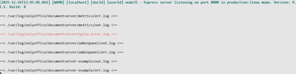

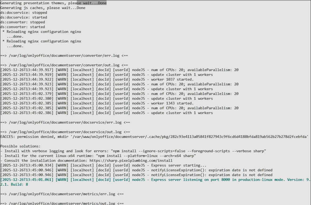

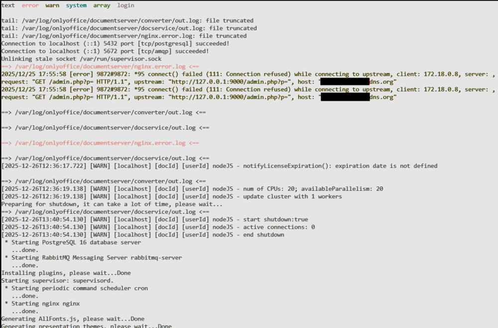

re: The OnlyOffice container - more informative than anything.
I realized recently my redis server wasn't being used despite the variables for ip/port/etc being set correctly.
Took some time but eventually I learned that the documentserver community edition does not have redis enabled by default even if you have one setup in the variables. Here is a snippet from the startup script for the container (run-document-server.sh) starting at line 132.
if [[ ${PRODUCT_NAME}${PRODUCT_EDITION} == "documentserver" ]]; then

I have had a working setup of OO within Nextcloud via a reverse proxy (SWAG) for a few years now. I recently noticed that the OO document server won't open documents in the browser anymore. In firefox I get a message:
"Firefox Can’t Open This Page. To protect your security, [my server].dyndns.com will not allow Firefox to display the page if another site has embedded it. To see this page, you need to open it in a new window."
In Edge/Chrome it just says connection refused. I suspect this is a reverse proxy config issue. Perhaps a security setting in both browsers now? No errors in Nextcloud logs, following messages in OO docker log:
Can anyone point me in the right direction? preferably with specifics, please. If you need diagnostics, please advise
