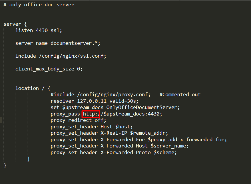

I'm struggling with this as well - set it up with the same proxy.conf file provided by SpaceinvaderOne, with the exception that SWAG wouldn't boot unless I removed what it called a duplicate, which was the:
proxy_redirect off;
Once I removed it, SWAG booted.  I can access OnlyOfficeDocumentServer via internal IP address, but not my domain name (shows an NGINX error "400 Bad Request" when I try to navigate to it, and a bad health check in Nextcloud).
Can someone post a working NGINX proxy.conf so I can see what I'm doing wrong?

    Yeah i have the same. I havent had time to look into this as yet but a quick fix is roll back to the earlier container. In the template change repository to add :6.0 on the end so onlyoffice/
  • I had quite a bit of trouble getting OnlyOfficeDocumentServer to work with nextcloud and letsencrypt. So I had letsencrypt install for plex etc and got it working with nextcloud. The confusing part of
  • So finally, I found a solution ! 🤩 I checked my nextcloud.subdomain.conf and added/removed everything so both files were similar.   In case someone has the same issue, here's my onlyoff

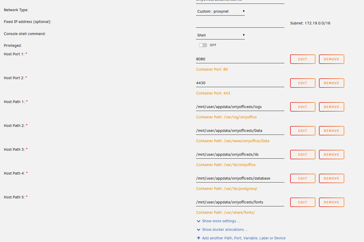

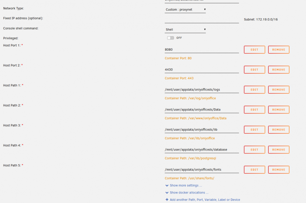

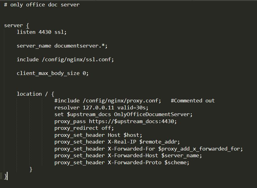

To start with, I don't have a great knowledge of network protocols & usually take baby steps :) Last time I was here, the question arised if my
proxy was pointing to http or https of onlyoffice, as fair as I know, it's https. But I'll hust walk you through what I have done & how far I've come :) If anyone have the time to help, it would be awesome.
I followed Spaceinvader One's video: https://www.youtube.com/watch?v=dEOfwKH2DHc&t=190s
When I had to copy the credentials I substatuded the Let's Encrypt folder to Swag as:
mkdir /mnt/user/appdata/onlyofficeds/Data/certs
cp /mnt/user/appdata/Swag/keys/cert.crt /mnt/user/appdata/onlyofficeds/Data/certs/onlyoffice.crt
cp /mnt/user/appdata/Swag/keys/cert.key /mnt/user/appdata/onlyofficeds/Data/certs/onlyoffice.key
After that I used the .conf file he provided and changed 433 ports to 4330, since I ude that as my 'Host Port 2'OfficeDocker.thumb.png.bb5e95ebfedb9695bce2582c480f2a8a.png
When I then restarted the Swag Docker, an error appeared1243348353_SwagErrorLog.png.2ac403d41da43b1e6311fa4d864d97d1.png
If I comment the ''include /config/nginx/proxy.conf;" out it doen't end in a forever loop and it acually starts up. 1876239056_conffile.png.de1dffb87944ddc3d0a06eeecfc45109.png

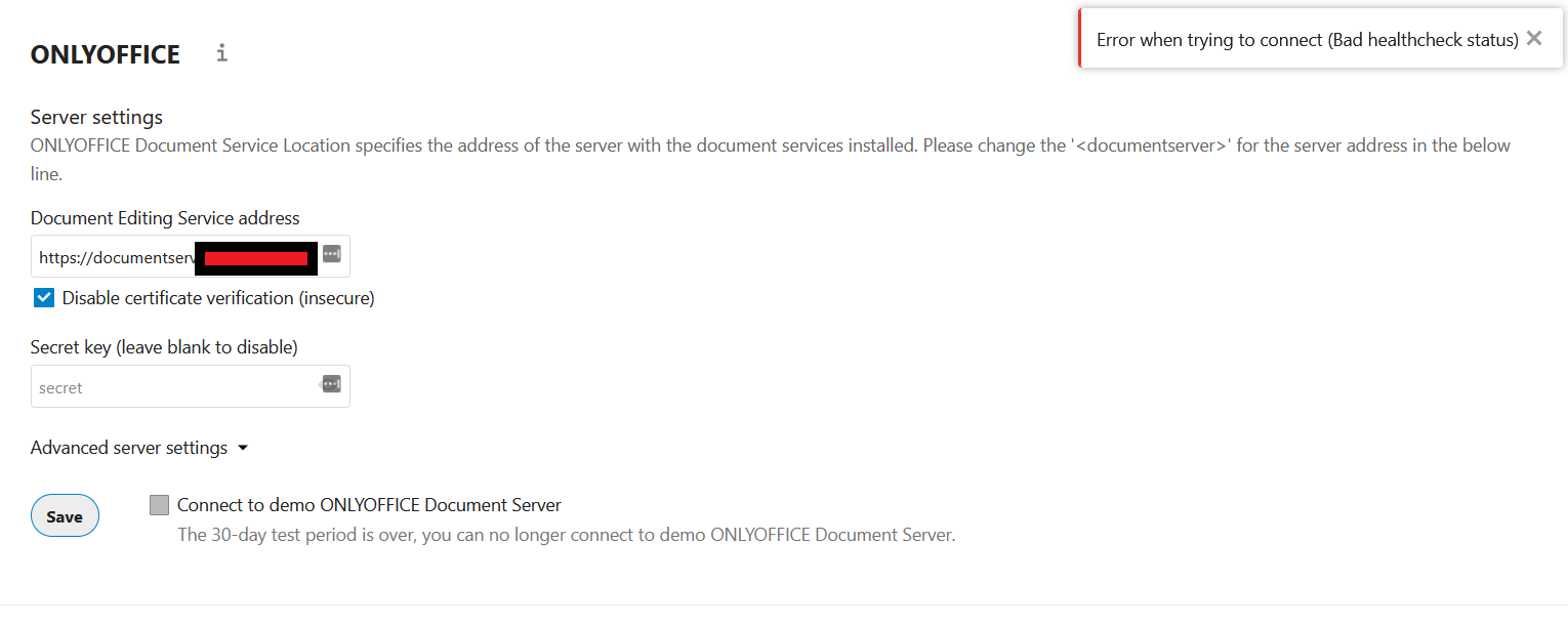

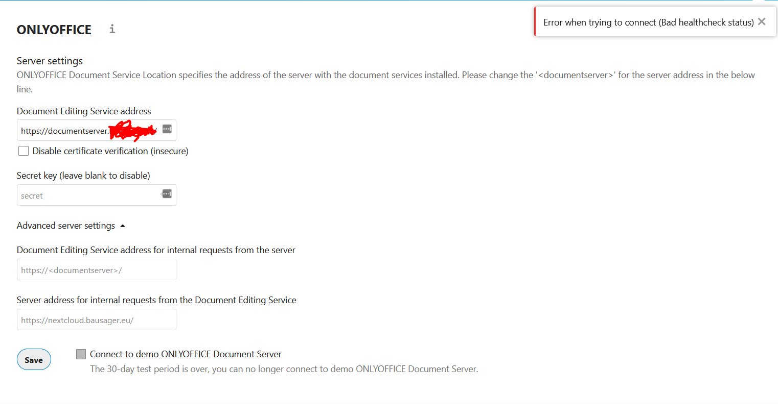

When I use this .conf file, the error in nexcloud says:
Otherwise it's just a "Server not found" or something like that.
As far as my understanding goes, in the .conf file, it refers to it as a 'https', which means it point to it as a https? I think :s
I hope someone can help me, it's not critical, but it would be nice to get it up & running.
Thank you again for your great work :)

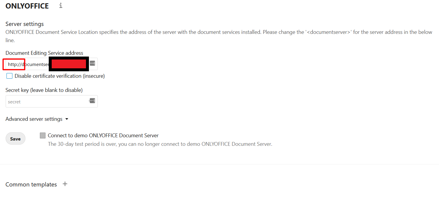

try proxy_pass to http instead of https
It still enters a forever-loop with the log saying;
"nginx: [emerg] "proxy_redirect" directive is duplicate in /config/nginx/proxy-confs/onlyoffice.subdomain.conf:19"
over and over again.
If I comment the line out again & change the https to http;1164324113_conffile.png.57ebdd943325b2bfe73b6444e9919643.png
and change the address to http;Onlyoffice.thumb.png.a2bca7a56254276b46985fa00f19b37f.png
I get another error now:
Error when trying to connect (Mixed Active Content is not allowed. HTTPS address for Document Server is required.)
Edited by Michelle Bausager

only change to http in nginx configuration.
Here's what it's doing, nextcloud make a https request to nginx, nginx forward that to document server with http. so nextcloud still see the server as https.
If I change it back to https in nextcloud, when it's back to the old error again.Onlyoffice.thumb.png.502b32ab49b4ddd4df9b3982b8c4ccc6.png
& the original config still ends in a forever loop :E

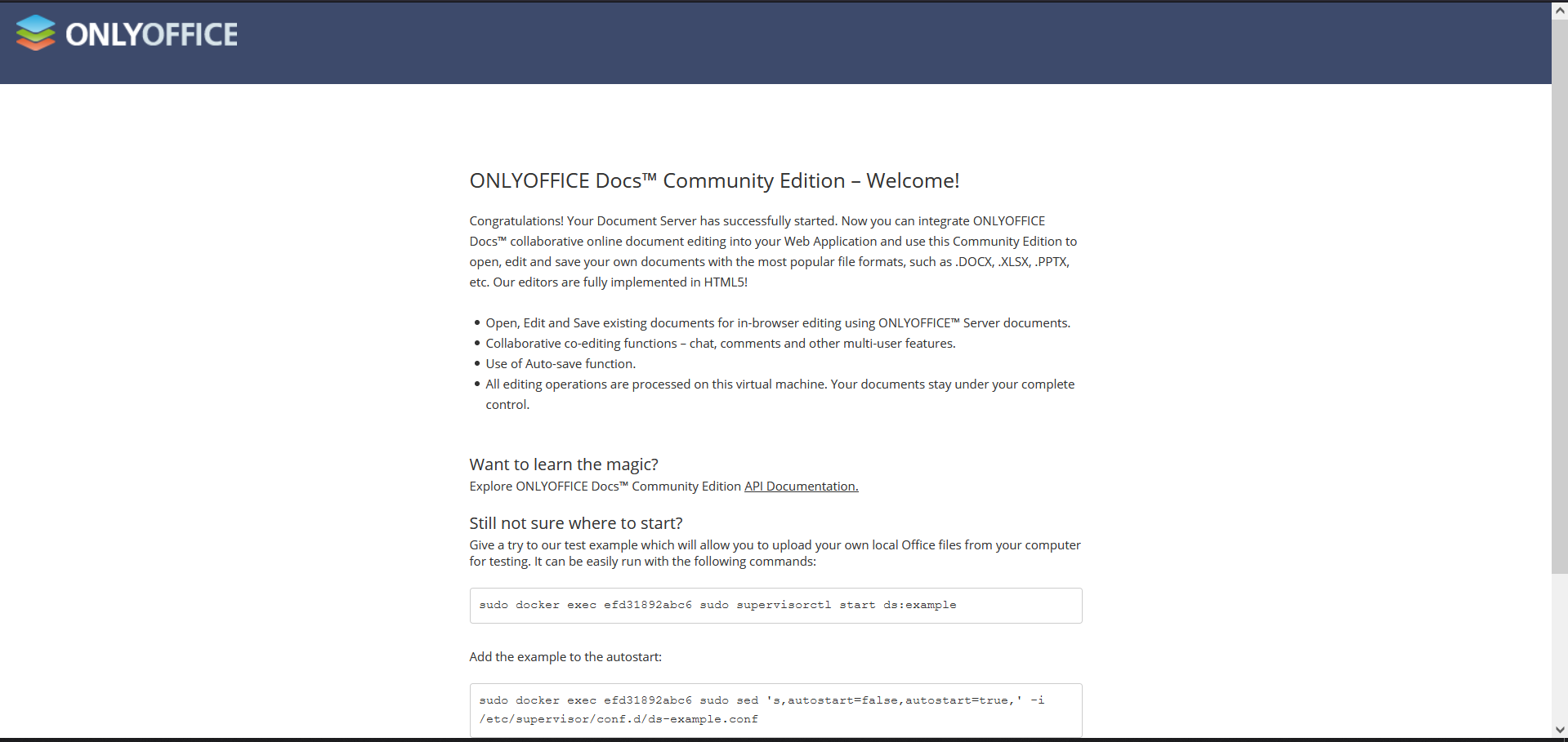

That should not be what show up. It should be the "Document Server is running" page. I don't use SWAG so I can't help you there so you should ask in the proxy's support thread.

I shifted to 'NginxProxyManager' and now the url points to:
But I still get a 'Error when trying to connect (Bad healthcheck status)✖'

On 7/15/2021 at 1:11 PM, Michelle Bausager said:
Okay :)
Would you mind posting the config from NPM?  I'm using SWAG and am having the same issues, but cannot get the site to show through using the sub domain.
I experienced the same error in my logs and I found a fix in at this thread:
https://forums.unraid.net/topic/111212-swag-zertifikat-l%C3%A4uft-aus/
that sorted the issue for me. The fix was for me to comment out line 19 in the  /config/nginx/proxy-confs/onlyoffice.subdomain.conf and after a restart all seems fine again.
Ps. use chrome to translate the thread into English. Ds.
