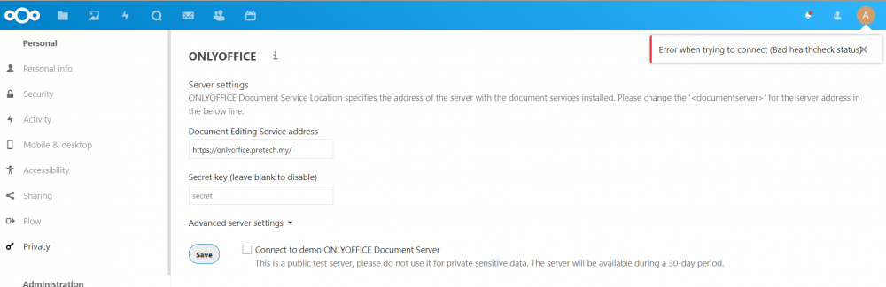

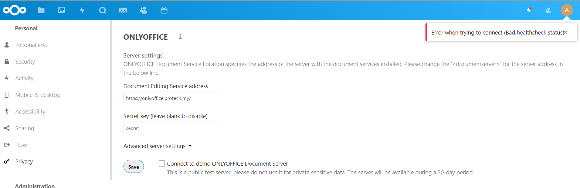

Is it possible to setup OnlyOffice without using Reverse Proxy? Currently, I am getting Bad Health Check Status. I have setup up a CNAME onlyoffice.protech.my My domain name is protech.my. I have left a screenshot below that I am having trouble with.
