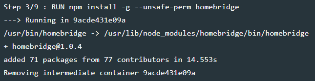

Getting this error when trying to add homebridge-camera-ffmpeg.
Why is the container stuck at 0.4.46?
[6/21/2020, 10:13:49 PM] Error: Plugin /usr/local/lib/node_modules/homebridge-camera-ffmpeg requires a HomeBridge version of >=1.0.0 which does not satisfy the current HomeBridge version of 0.4.46. You may need to upgrade your installation of HomeBridge.
EDIT: The container is deprecated?
