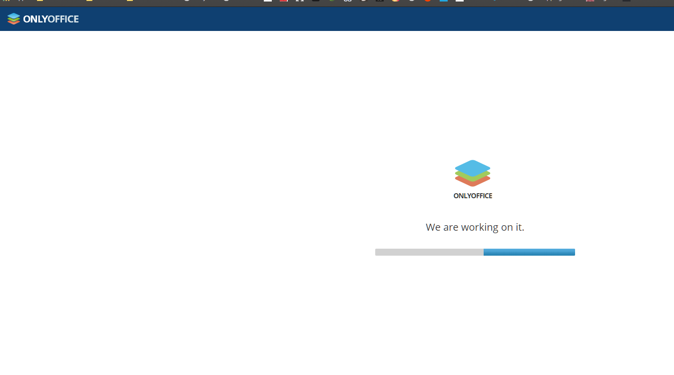

  • I had quite a bit of trouble getting OnlyOfficeDocumentServer to work with nextcloud and letsencrypt. So I had letsencrypt install for plex etc and got it working with nextcloud. The confusing part of
  • So finally, I found a solution ! 🤩 I checked my nextcloud.subdomain.conf and added/removed everything so both files were similar.   In case someone has the same issue, here's my onlyoff

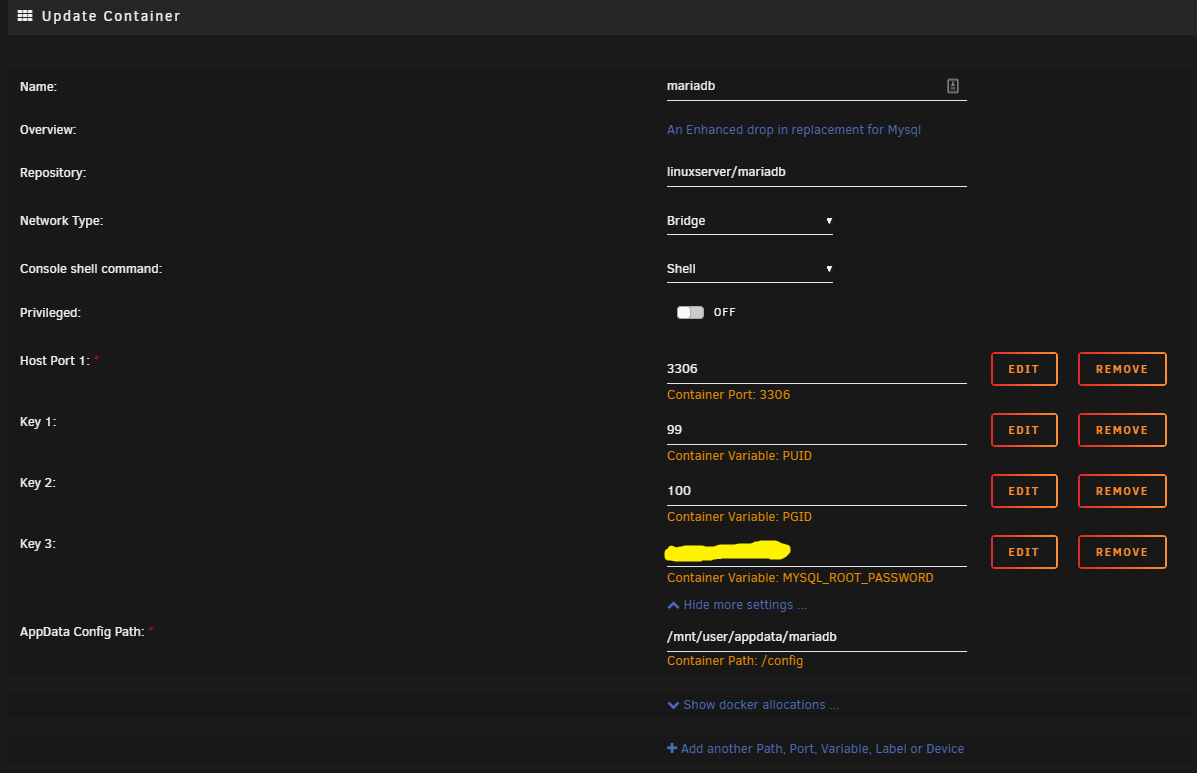

Though I did change to mysql 5.7 and i no longer get the bind error but the variables are the same like in the mariadb

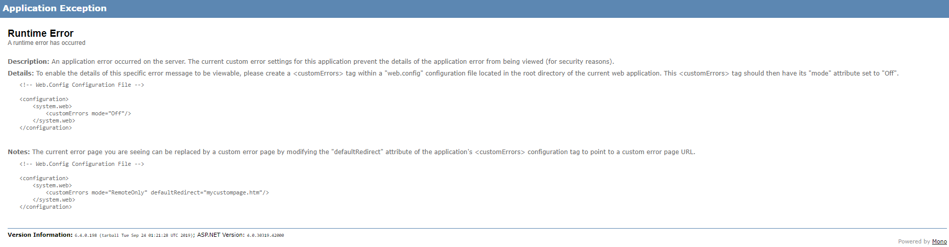

Well looks like this is the custom error that is hidden
Not Found
The requested URL /Default.aspx was not found on this server.
Not Found
Try nuking the onlyoffice directory
