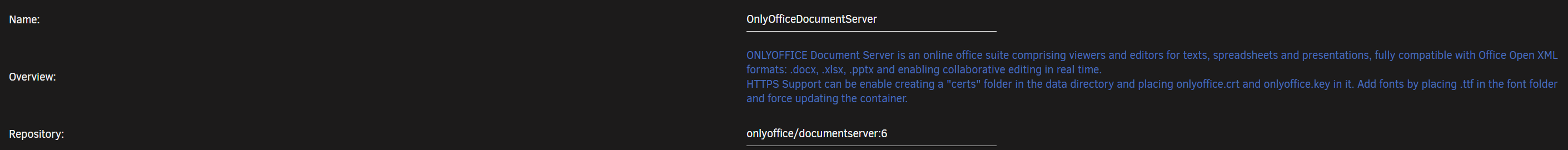

On 12/5/2020 at 2:17 PM, SpaceInvaderOne said:
Yeah i have the same. I havent had time to look into this as yet but a quick fix is roll back to the earlier container.
In the template change repository to add :6.0 on the end so
onlyoffice/documentserver:6.0
Thanks @SpaceInvaderOne that worked for me.

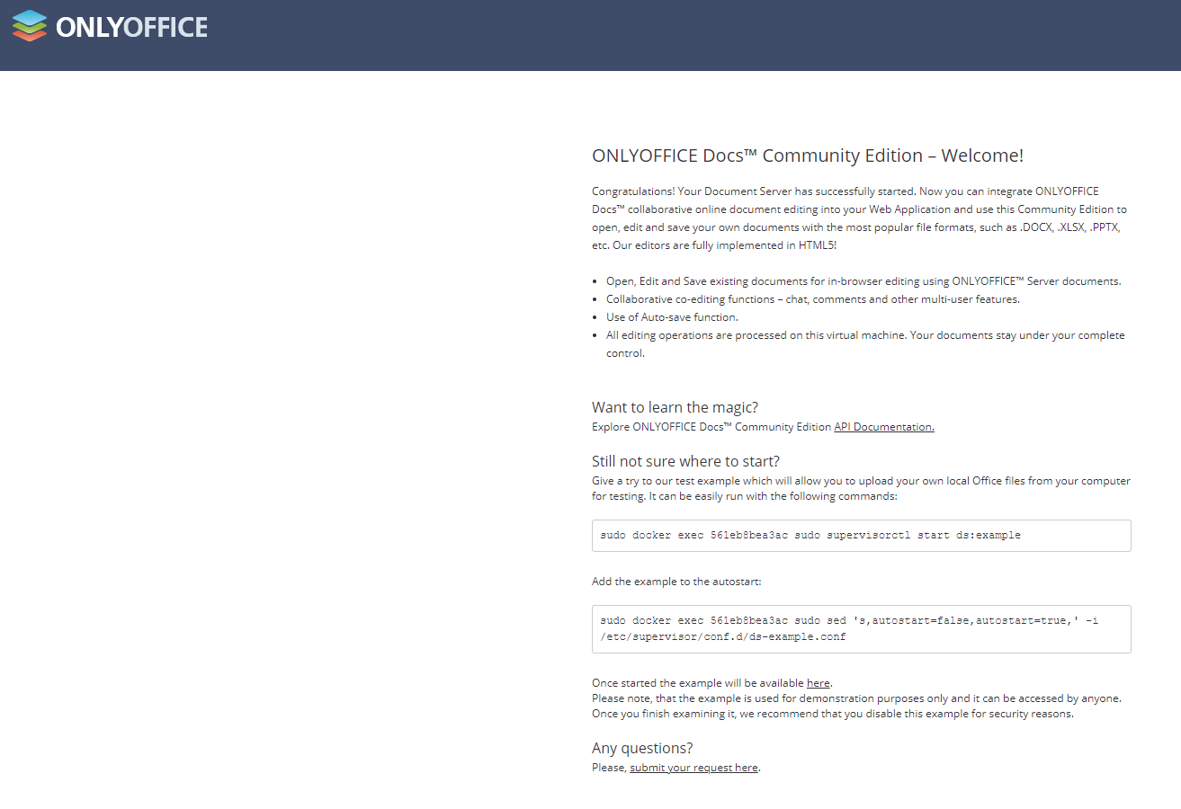

While we wait for the fix, I found that I lost of lot of time unsuccessfully trying to diagnose what the OnlyOfficeDocumentServer container log was spitting out. Especially the plugin warnings highlighted in yellow and error log path highlighted in red which don't seem to be part of the issue.
It seems like the difference in the output of the container log between 6.2 compared to 6.0 are these messages before "Starting supervisor: supervisord." Does this tell us what's wrong?
Creating new PostgreSQL cluster 12/main ...
/usr/lib/postgresql/12/bin/initdb -D /var/lib/postgresql/12/main --auth-local peer --auth-host md5
The files belonging to this database system will be owned by user "postgres".
This user must also own the server process.
The database cluster will be initialized with locale "en_US.UTF-8".
The default database encoding has accordingly been set to "UTF8".
The default text search configuration will be set to "english".
Data page checksums are disabled.
fixing permissions on existing directory /var/lib/postgresql/12/main ... ok
creating subdirectories ... ok
selecting dynamic shared memory implementation ... posix
selecting default max_connections ... 100
selecting default shared_buffers ... 128MB
selecting default time zone ... America/New_York
creating configuration files ... ok
running bootstrap script ... ok
performing post-bootstrap initialization ... ok
syncing data to disk ... ok
Success. You can now start the database server using:
pg_ctlcluster 12 main start
Ver Cluster Port Status Owner Data directory Log file
12 main 5432 down postgres /var/lib/postgresql/12/main /var/log/postgresql/postgresql-12-main.log
* Starting PostgreSQL 12 database server
...done.
* Starting RabbitMQ Messaging Server rabbitmq-server
...done.
CREATE DATABASE
CREATE ROLE
GRANT
pgrep: cannot allocate 4611686018427387903 bytes
/etc/init.d/supervisor: 100: [: -eq: unexpected operator
* Starting periodic command scheduler cron
...done.
* Starting nginx nginx
...done.
Generating AllFonts.js, please wait...Done
Generating presentation themes, please wait...* * Starting PostgreSQL 12 database server
...done.
...done.
...done.
...done.
I'm running into an issue with the version 6.0 as well (just as an FYI, they don't have the official container available anymore).  When I got to hit "save" at the last step I get, "Error when trying to connect (Bad healthcheck status)".  I've done a pile of reading and I can't seem to sort out what's going on.
So that makes at least 3..
@Siwat2545 please help?
Set your Repository as follow image.thumb.png.7f4dd803c52597d4adbed9462ed204c0.png
I did this, then force updated and restarted the container. I get the same error.
Here is the output of the logs option in unraid for the docker:
I hope this helps. Any more advise would be very welcome, thank you

I can then navigate (only using the external URL) to this page:
(I tried just changing $upstream_docs to $upstream_app but it still failed).
If i try and navigate to the local address i cannot connect. When i try to connect to onlyoffice in nextcloud i get the following:
I'm gonna keep trying but looks like a few people have the same issue.
