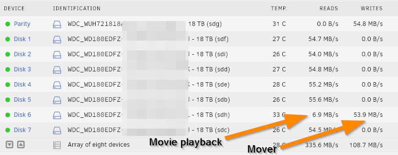

So I'm still experiencing the issue with Plex buffering while the mover service is running. I did notice when performing iotop command, that shfs is utilizing ~95% IO when mover is running. Is this to be expected?
My Plex app directory is located on it's own separate Unassigned Device share, and transcoding directory is set to /tmp BTW.
*** Update ***
Once the mover process finished, I have very negligible  I/O usage.

Try disabling turbo-write and see if that solves the issue. Turbo-write needs to read from ALL drives when writing, so even if the data is on a drive that is NOT being written to it's still being utilized. Also, download the netdata docker. If the CPU usage is probably I/O wait, which as I understand it is just the system waiting on your the hdds.
