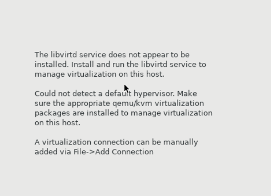

I am still kinda new to linux ins and outs.... i installed the Virt Manager but i get this error about the LIBVIRTD not being started... any idea what to do?
Install  netcat-openbsd via NerdPack, connect to Unraid IP address with SSH, same username & password as unraid webui.
then what?
Had the same error, tried this and all is golden. Much appreciated

3 minutes ago, RSQtech said:
then what?
Then you'll be up and working.

I followed what @dee31797 posted - here are the itemized steps:
  1. turn on netcat-openbsd in Nerd Pack, apply, and restart computer
  2. open the virt-manager docker GUI - you'll still have the error
  3. in the Docker container, go File > Add Connection
  • Hypervisor: QEMU
  • Select connect to remote host over SSH
  • Hostname: the internal network IP of your server
  • Hit connect
It will then ask you to accept certificate, then for your unRaid password. Once cleared you're in
Edited by positronicP

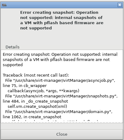

Just wondering if anyone has snapshots working with virt-manager? I've made sure my disk is convert to qcow format, but when I try make a snapshot this error comes:
error: Operation not supported: internal snapshots of a VM with pflash based firmware are not supported
Did you google the error?
Second hit:
https://www.redhat.com/archives/virt-tools-list/2017-September/msg00008.html
Was hoping someone would have a solution (or figured I set something up incorrectly) since I saw in the other thread that people mentioned about using qcow disk format to make snapshots.
Also tbh I didn’t understand the terminology on that site. Like what’s the difference between internal and external snapshots ?
