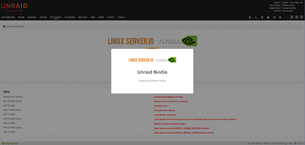

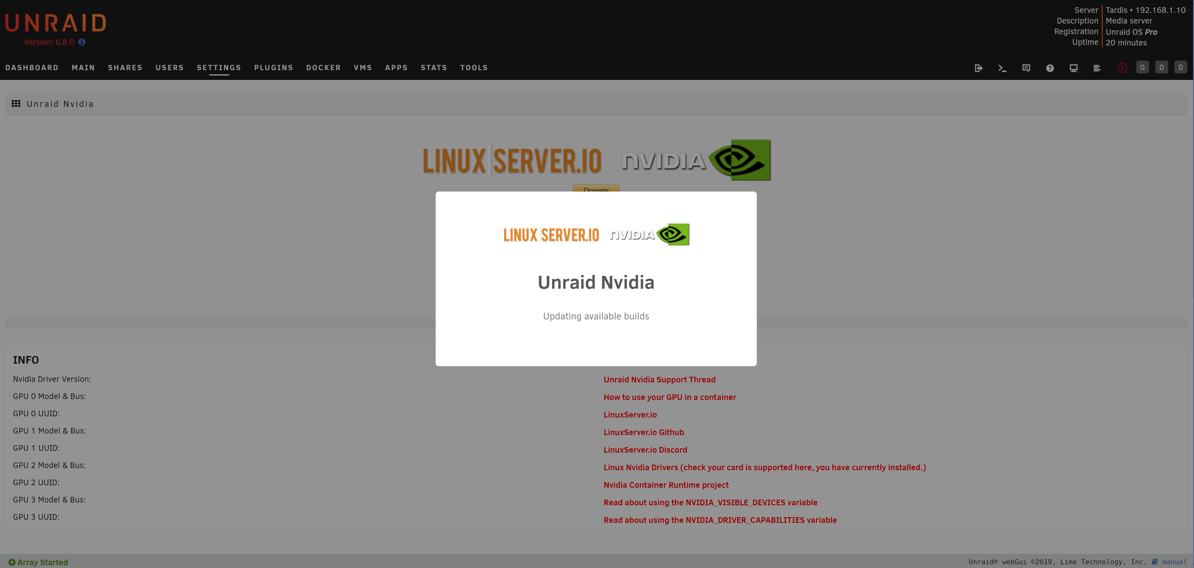

Hey Guys. im trying to get my P2000 working for plex transcoding. i just installed the Unraid Nvidia plugin and it gets stuck on the Updating available builds screen.  any ideas?
Just FYI, but if it takes exactly longer than 120 seconds, it will never finish.  I believe you'd still be able to download the appropriate files manually, though others @ lsio would be able to assist.

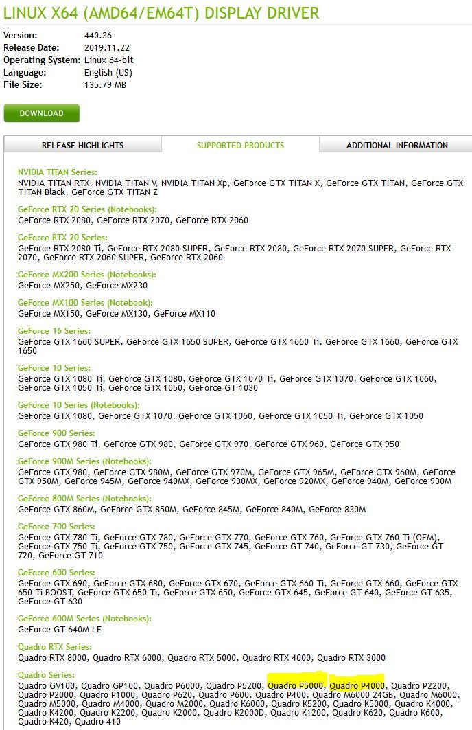

On 12/28/2019 at 12:39 PM, Defylimits said:
I have a similar problem, the P5000 and P4000 (one in my server) are supported by this driver version (see snip)?
My 710GT and 1080 both showed up in the Info page, and the 1080 disappeared when it was being used as pass through for my VM, but the Quadro P4000 does not show up on the Info page even tho it is showing up in the system devices page.
Is there a way to get the UUID in a another manor and still try passing it through to the docker? Or will it not work at all if its not detected on the Unraid Nvidia page?
Note that the Quadro 4000 (Released 2010)  and the Quadro P4000 (Released 2017) are two entirely different products several generations apart from one another.
