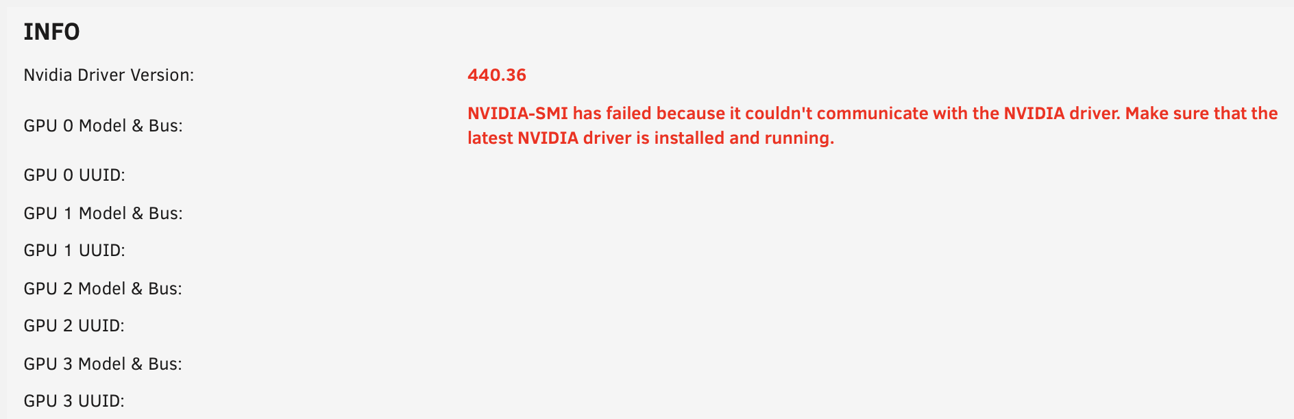

On 12/22/2019 at 3:36 AM, Pixor said:
I have installed 6.8.0, but my P600 isn't recognised. I get the following:-
340066225_ScreenShot2019-12-22at7_32_33pm.thumb.png.df298b6fc47d1b22eaba7b0082f35c4c.png
I have tried the following:-
$ nvidia-smi
NVIDIA-SMI has failed because it couldn't communicate with the NVIDIA driver. Make sure that the latest NVIDIA driver is installed and running.
I'm not sure where to go from here. Can anyone suggest what I should try next? Thanks.
I am getting the same error message with a Quadro 5000 and also don't know what to try next, Help me forum group, you are my only hope....lol
I might suggest rolling back to 6.7 and trying it, could be a bug with a new driver for 6.8 or compatibility with your cards.

Yeah, if the plugin is installed but you haven't
1. Downloaded the custom Nvidia build &
2. Rebooted
You will see nvidia-smi errors as the plugin parses the installed cards at boot using nvidia-smi then writes that info to a temp file which is then utilised from then on.
Problem is, for everyone posting that nvidia-smi error it doesn't really mean anything as all it says to me is
"At the time of boot, when nvidia-smi was run, a card wasn't able to be found"
That's not to say the card didn't load the kernel drivers later in the boot cycle and would work perfectly regardless
I'll put the beast to bed then post a command for people to test the theory.
Why this is suddenly an issue, no idea....
