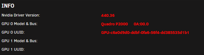

Now the 1080 doesn't show but the P2000 is now there.

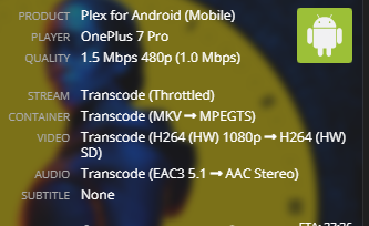

Playing a file in Plex does show that HW transcoding is working too. Thank you for solving that little issue.
The 1080 won't show as you've passed it through to a VM haven't you?
Sent from my Mi A1 using Tapatalk
Correct. All seems well again. Thanks for all the hard work you guys do.
