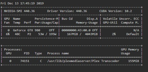

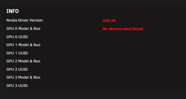

Updated to 6.8.0 unraid nvidia but after many reboots plugin is not seeing my gtx 980 again it shows in unraid iommu group but not in unraid nvidia plugin.
skynet-ur-diagnostics-20191213-1735.zip
Ok strange as it is working! plex docker starts which it would not if not seeing the gpu and just did watch nvidia-smi and it is transcoding a stream i started.
Edited by turnipisum

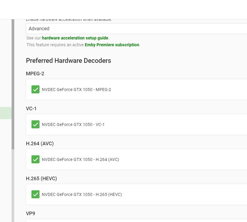

After recently discovering the work you guys have done, i've added a GTX 1050 to my unraid server.  I have the LSIO Emby docker setup and in my transcoding settings can see the GPU detected as a hardware encoder/decoder but when i attempt to convert any files they still use the CPU. I have posted on the Emby forum but been told Docker support is still not officially supported so wondering if anyone else can shed some light on it
ffmpeg-transcode-3f02cb60-8ceb-4c5b-a955-93ebea7194ed_1.txt 171.15 kB · 0 downloads
Need more info.
Post screenshots of your Emby webui settings for transcoding.  Also post your docker run command.

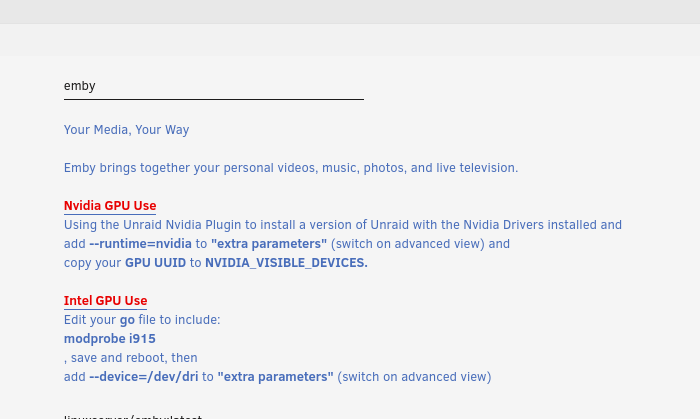

You're missing --runtime=nvidia from your docker run command as mentioned in the instructions.  So you're passing through the card, but you aren't telling the container to use the nvidia docker runtime.
EDIT:  Actually I'm not so sure the instructions are that clear.  My bad.....
EDIT2:  Although it does include it on the Docker template.

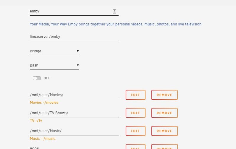

I found it confusing, as i had it in their previously.
Then i deleted the container and added it back and the info was missing from the template
