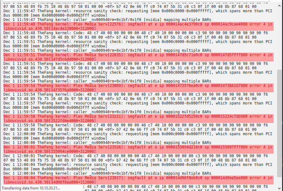

I have recently attempted to get HW transcoding working but have hit an error that I can not figure out.
I am currently running Unraid RC5, have downloaded the plug in, typed in the extra parameters, GPU GUID and GPU Capabilities. I have a working Nvidia-SMI screen but keep getting the error below when trying to transcode over hardware. I have tried googling with no luck.
I am currently using the LinuxSevers IO Plex App and do have Plex Pass (I watch on my phone all the time with CPU transcode).
This is tested on multiple 1080p, 264, .mkv files.
Thank you,

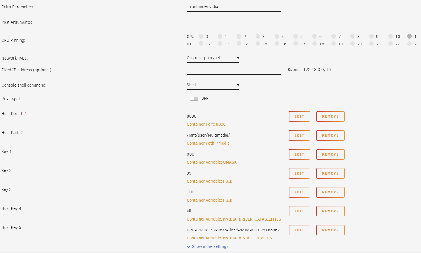

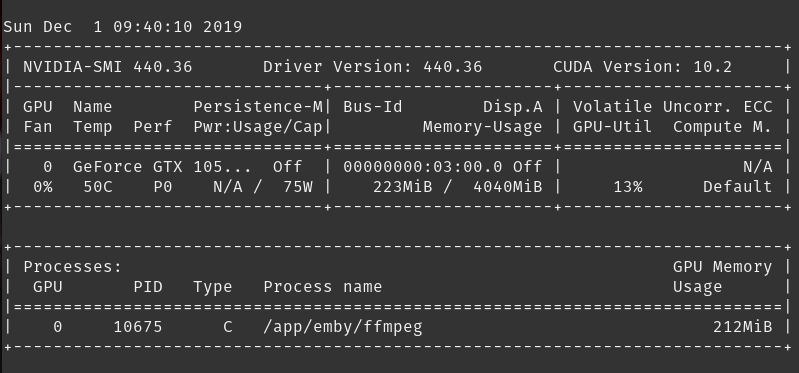

On 11/28/2019 at 10:57 PM, Coolsaber57 said:
Hello,
I'm having some trouble getting Emby to see my GPU.  I have gone through all the steps, the Nvidia plugin can see my GPU and I've configured the docker container below (binhex-emby).  I've restarted by my entire machine and the Docker container separately, but still no dice.  When I click on the Transcoding page in Emby, and select Advanced, all I see is the section headers.
Any tips on what I can try to get it to see the GPU?
Edit: I see this and a few more errors in my emby docker log:
Error NvidiaCodecProvider: Error running ffdetect for nvencdec - args: -hide_banner -show_program_version -loglevel 48 -show_error -show_log 40 nvencdec -print_format json
*** Error Report ***
Edit2:  I tried setting up the LinuxServer version of the container and though it doesn't show any of the above errors in the log, it also doesn't show anything in the transcode "advanced" page.
Thanks!

1 hour ago, Coolsaber57 said:
Re-posting to see if anyone can see anything I'm doing wrong or have any suggestions.
Have you copied the nvidia variables and the runtime into the template? If so, try typing it manually in case there are some nasty hidden characters sneaking in.
For emby you also have to be using emby premiere to be able to use transcoding.
As a troubleshooting, you could try our container as that's the one we test with.

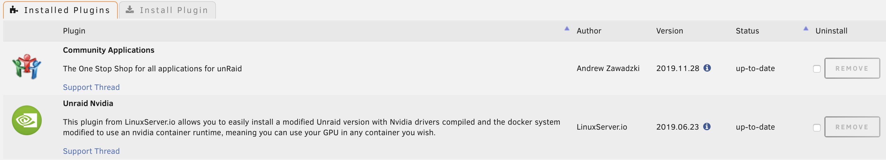

Hi, first of all, thanks for this awesome plugin!
Is there an ETA when you'll support unRaid 6.7.2 (or even 6.8.0)?
I'm looking forward to running Plex as a docker, but I don't really want to get too far behind on the unRaid Version.
?? Check your plugin. 6.7.2 has been supported for about 6 months. Latest 6.8 release candidate is also supported as of yesterday
Thats strange. I'm working with a fresh unRaid Install (a week old) and the Plugin shows up as "up-to-date" too.
Then go into the plugin via the settings page.  You'll see the available versions in the dropdown.
Note: the plugin doesn't need updating for a new version of Unraid to be added to the list of available downloads.
