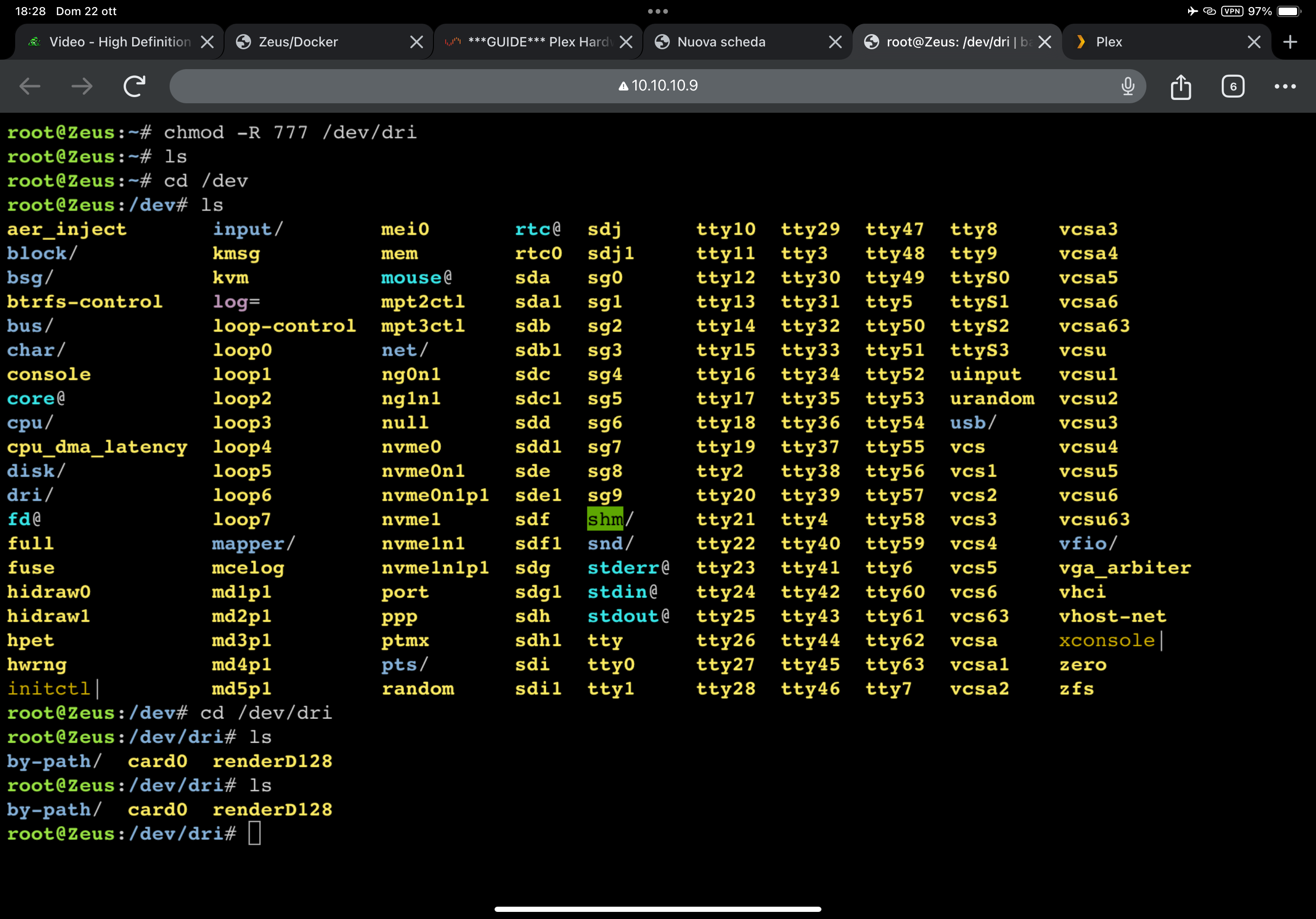

Official Plex Media Server. Installed Intel-GPU-Top, but when i go to the terminal and type in cd /dev/dri i get no such file or directory. What am I doing wrong here?
38 minutes ago, honorary-kicking8931 said:
Intel 1290k MSI Z-690-A board.
Do you have your integrated graphics set as primary in your BIOS?  It usually cannot be set to auto and should not be set to anything other than the integrated graphics.
So if im understanding you correctly, in my BIOS i need to set my iGPU as my primary?
Yes.
If you have a second GPU like Nvidia or AMD the BIOS will likely choose it as primary.  However, even without another GPU, AUTO often does not work and iGPU or internal graphics must be set manually.  This should get you the /dev/dri directory after the step you've already taken.

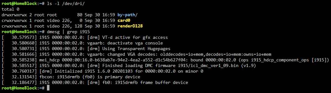

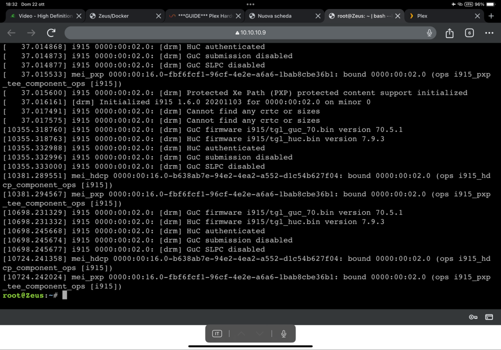

I bought a mainboard off of AliExpress (CW-N5105-NAS, Topton NAS Motherboard N5105) and had trouble getting my internal GPU going. It has an 11th Gen Intel Jasper Lake with these specifications. This post in the libreelec forum provided part of the solution that finally helped me, because
ls -la /dev/dri
did nothing for me before.
I had to edit /syslinux/syslinux.cfg on the USB stick and make the first boot entry look like this (notice the 4th line)
label Unraid OS
  menu default
  kernel /bzimage
  append i915.enable_fbc=1 i915.enable_guc=2
  append initrd=/bzroot
And I also had to create this file with
echo "options i915 enable_fbc=1 enable_guc=2" > /etc/modprobe.d/i915.conf
Now everything works for me.
Hope this prevents a couple of headaches. Cheers

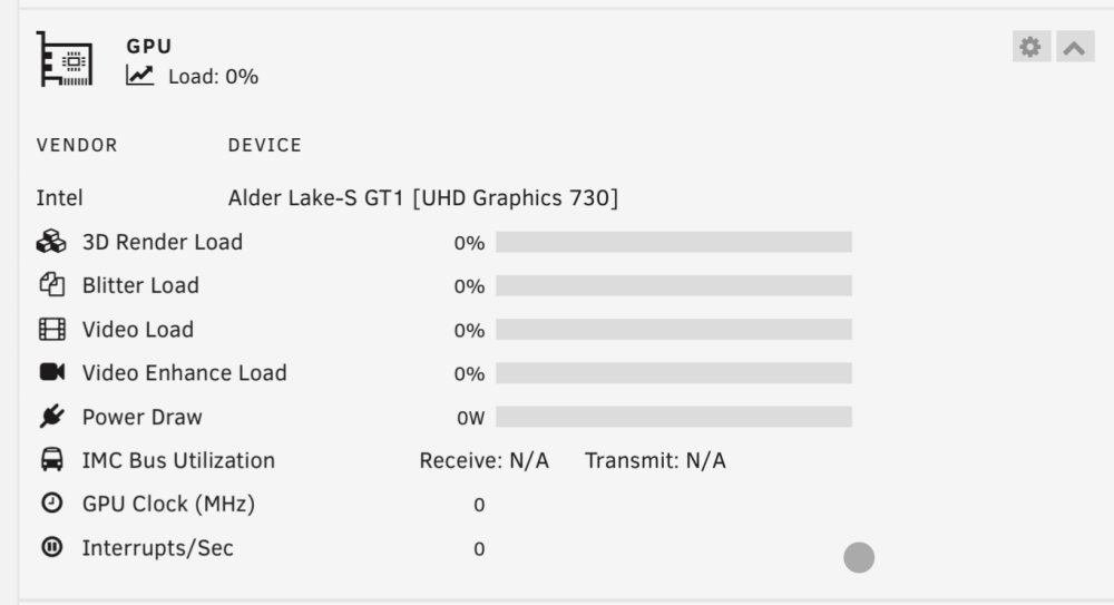

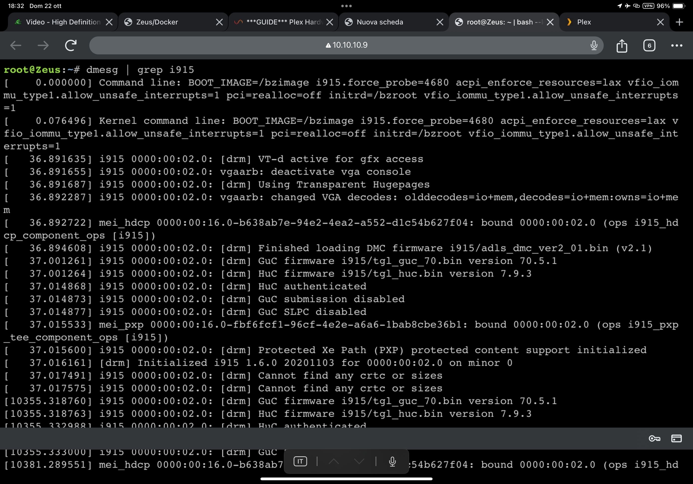

Is i915 force_probe=4680 still required fro igpu encode i am using 12400
Which OS are you using, if 6.12+ then it should detect by default. If force probe is required it will show in logs
dmesg | grep i915.
root@computenode:~# ls /dev/dri
by-path/  card0  card1  card2  renderD128  renderD129  renderD130
This should show entries if working ok.
dmesg | grep i915.
is this what you mean
Edited by simo241
3 minutes ago, SimonF said:
Yes looks correct.

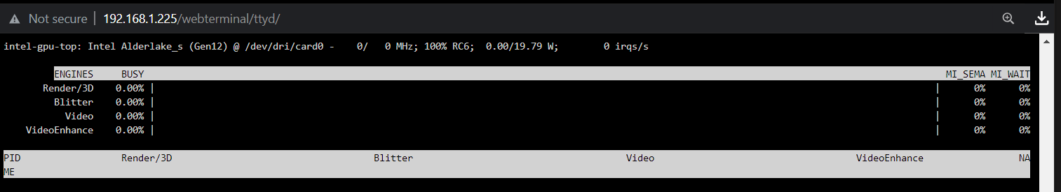

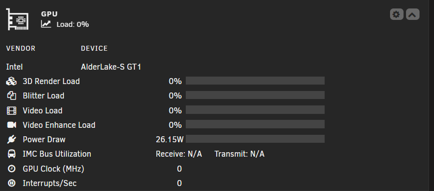

 Thank you , so have same display error  here, same time power draw is at 100 with no utilization
Where are you seeing power draw @ 100 do you mean 100% RC6? That value is reverse of what you thing 100% is no power use
rc6 is a percentage of how little the GPU is requesting power
if option of max package or GPU it will show. 19.79W is package GPU is 0 in my intel_gpu_top values.

Hell Unraid community. I've had my setup for a few years now and am finally configuring my rig (or trying) to enable hardware transcoding (not just for Plex but for other apps like Photoprism as well), but I'm not getting anywhere so I'm asking for help.
The problem I'm having is in /dev/dri/ I only see by-path/ and card0 nothing else. I also checked my bios and only have an 'onboard' or off board option, so I have 'onboard' selected. Not sure if this is the right choice since the mobo does have Matrox onboard graphics, but not sure if off board would work (there's also a jumper for vga on the motherboard that is set to on). If anybody had an idea, I'm all ears.
Here are my diagnostics zuse-diagnostics-20240212-2148.zip, but in short my CPU is a Quick Sync supported Xeon E31260L 2.40GHz installed on a Supermicro X9SCM-F motherboard
The supermicro has the latest bios (2.3a) and my Unraid is on 6.12.6. I also have intel-gpu-top and I blacklisted i915 via
echo "blacklist i915" > /boot/config/modprobe.d/i915.conf
and rebooted.
