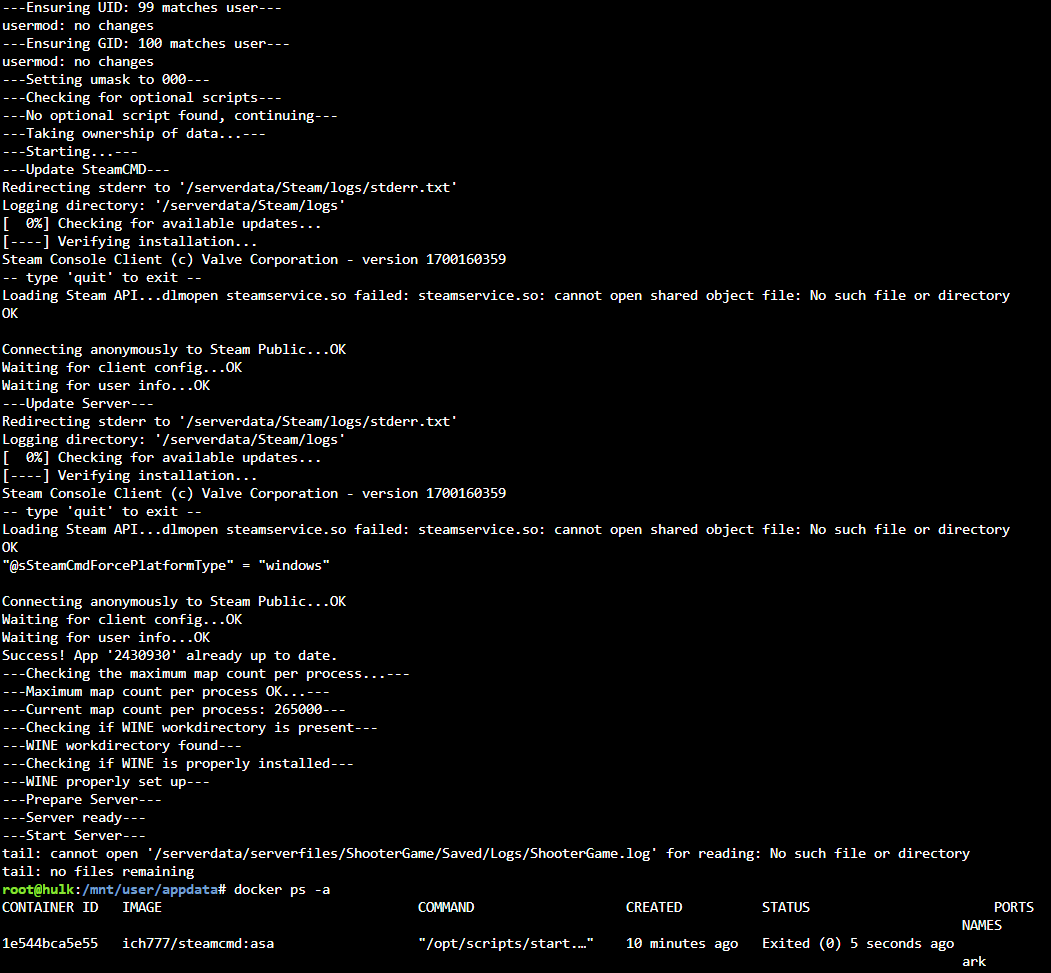

Need help getting the new Ark (ASA) running. I run on an Intel Xeon CPU E5-2699 v4 with 128BG of RAM. Everything installs fine, but it crashes as soon as it starts to run. From what I've read in the forum, it may be a CPU issue?
I don't know, what CPU do you have?
Can you see if you find a log in the directory for asa in your appdata folder?
Double check if your folder mounts and that the folder where the files are located is configured to stay on that disk/pool.
