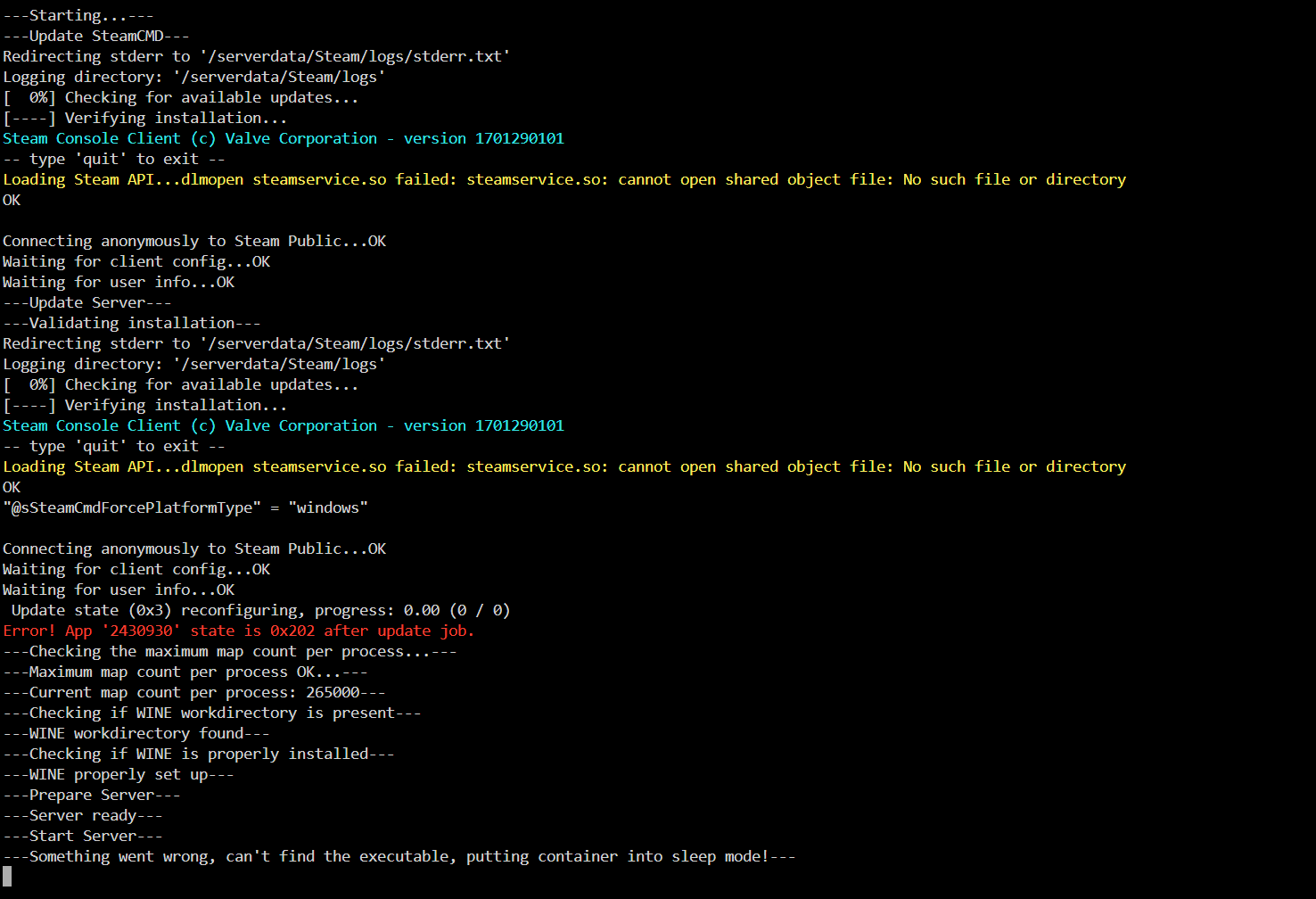

The second picture is from the container's logs. It's clear something has gone wrong but I am not sure what and I'm unsure of what to do about it.

I'm relatively new to Unraid. I have the ASA server installed, however when it runs, I get this error saying no executable found. Am I missing something completely obvious?
You have an error 0x202 error state in your logs.
This means that you run out of space and SteamCMD aborts the download because of too less available space.
Are you sure that you path mappings in the Docker template are correct?

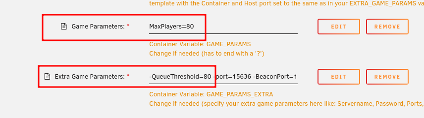

On 12/2/2023 at 9:21 AM, ich777 said:
Can you please be a bit more specific?
So you set MaxPlayer=80 in GAME_PARAMS and -QueueThreshold=80 in the GAME_PARAMS_EXTRA like that:
Correct?

This is not the way to do it, you should add MaxPlayers=80 to GAME_PARAMS and -QueueThreshold=80 to GAME_PARAMS_EXTRA since those are the fields which the parameters meant to be go.

13 hours ago, ich777 said:
No!
Only specify Steam credentials when the username and password marked with a red asterisk and are not hidden away in Show more options!
Here is also the correct example.
Thanks mate, this did the trick. For some reason the mover settings had been changed so it filled up my cache drive. Got that sorted and now the server works.

Using this to setup a cluster.   Basically followed instructions, however, I have not gone as far as setting up dynamic config, mods, or really any configs outside of the default. Which means I also did not setup ARK0.  I did assign my server name and passwords, and clusterID. Went through and removed `-UseDynamicConfig` and the parameter for defining the dynamic config location, though.
So, completely brand new install, no non-default configs, no mods, new survivor.
I spun up Island and Scorched earth for testing purposes.   I can see and connect to both without issues.
I can see both as options when I go to an obelisk in game, but here is where it gets tricky.
Island -> Scorched or Scorched -> Island
1. Transfer with survivor (with and without items)
2. Wait about 30-ish seconds, eventually I'm booted back to menu and a "Host Timeout Error" appears on screen.
3. Try to directly login to the server I just tried to transfer to.  Can't join, session timeout.
4. Restart target server's container.
5. Connect no issues, survivor appears and any items brought along are in the inventory/hotboar
This is consistent with every time I attempt to transfer to or from either server.  The target server will not connect, fails to connect after the attempted transfer, until I restart the container, then it works no problem.
Have you seen this before and do you possibly have a fix, or know where I can possibly see any logging information?  Because container logs stop after "Start server" appears and I've looked in steamcmd and ark logs and there's no information there really other than server save log entries.
Of course, this is all running on Unraid 6.12.6.   Docker img and all appdata files are on my 1tb nvme.
I have a problem with the Satisfactory container. I have been running multiple Satisfactory servers for a while but stopped playing the game early 2023. I have now started again with some friends since the new game update.
One of the containers is having trouble starting a lot of the time. I tried removing the container and installing it again. That does not work. Rebooting my Unraid server does seem to work most of the time, but that is not an option for me.
The logfile shows an error but closes when the container reboots. I managed to get this screenshot:
Trying to reinstall this container sometimes even gives me the error "can't find excecutable". My other Satisfactory container does start just fine, but this one keeps giving me trouble.
Any help would be greatly appreciated.
Did you change anything or what did you do exactly when reinstalling, did you also delete the directory or create a new directory in your appdata for the new container?
How does the template look like? Did you change anything?
Make sure that there is enough space on the disk, are all containers on the same disk?
I think error 0x602 has something to do with SteamCMD not working correctly (I can't remember form the top of my head).
