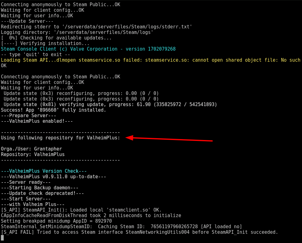

Valheim plus seems to be abandoned. There are a few forks which bring compatibility with the latest version of Valheim but if you copy them over the official version in this docker it refuses to start. (I believe it's getting caught up in the version check)
Would it be possible to make one of the forks such as ValheimPlus_Grantapher_Temporary work with this?
I think you are using a really old template from my container correct?
You don't need to copy over anything and by default my container is using this version from Valheim+
I'm running it on my server and it is working as it should:
Are you also sure that the container itself is up to date? By default it uses this repository.
That's probably It. I'll wipe the template and try again.
