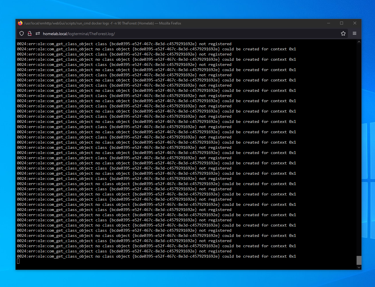

6 hours ago, KRONBERG said:
the following string seems to be related to wine: bcde0395-e52f-467c-8e3d-c4579291692e
Usually these are WINE messages and should not hatm anything.
Is the container not working?
What happens when you restart the container?
Do you maybe have the full log?

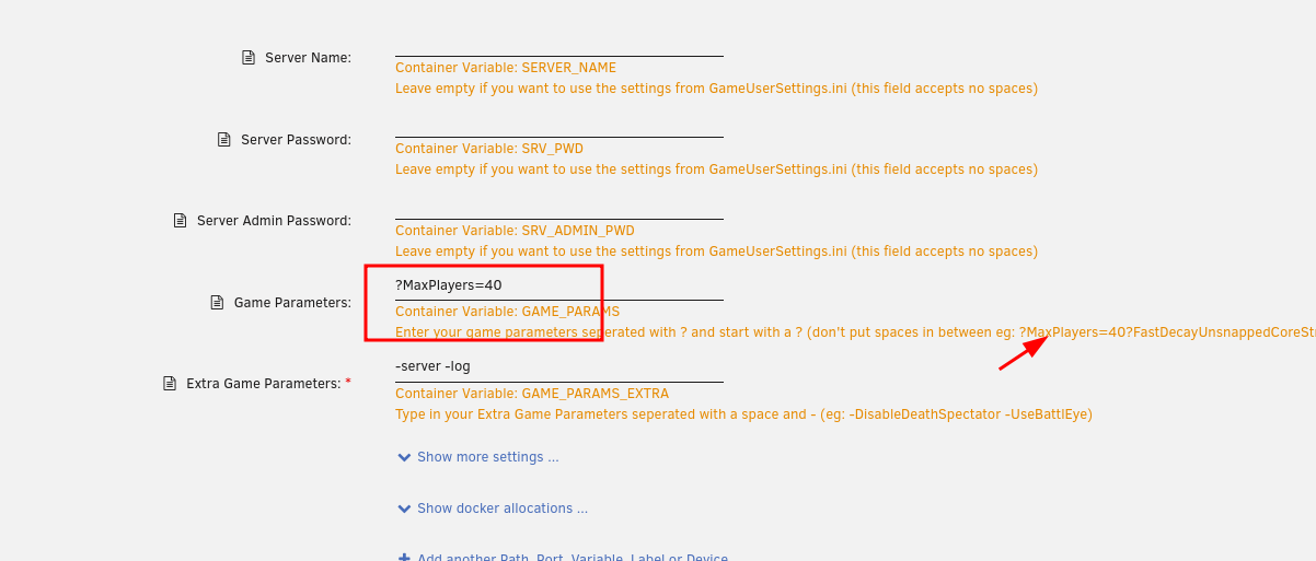

1 hour ago, Tobîîas said:
I am grateful for all help
It should look like this if you want 40 players for example:
I just wanted to try everything, that's why the game params ...

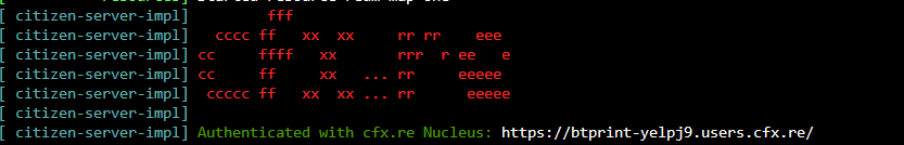

Hello there ich777, can you please help me get out of this problem that i have with redM server?
when i start the server and i open the logs it gets stuck at the line: Authenticated with cfx.re Nucleus: link
and after some time i get server cannot be listed error even though i can connect localy but there is no txAdmin pannel openning
i am lost in the serach for a solution and it seems that nobody has this problem.
I will attach some screenshots to this post
Edited by bTprint
14 hours ago, bTprint said:
It seems that the container can't communicate with the server or does run into some kind of timeout, do you maybe have any adblocking or Unifi network gear on your network?
Make sure that the container has exclusive access to the internet.
well i did made a custom network just for that, the server shows up in redm launcher as a listed server, i made some tunnels thru cloudflare to have also subdomains, but the error still shows up. my router has restrictions whatsoever i even made a portforwarding to these 3 ports but that's literaly unnecessary.  should  run some portforwarding on unraid???
btw that with txAdmin i was so dumb... i forgot to delete the server cfg after i made the port and start_vars...
Thank you for the reply and much thanks for your hard work
