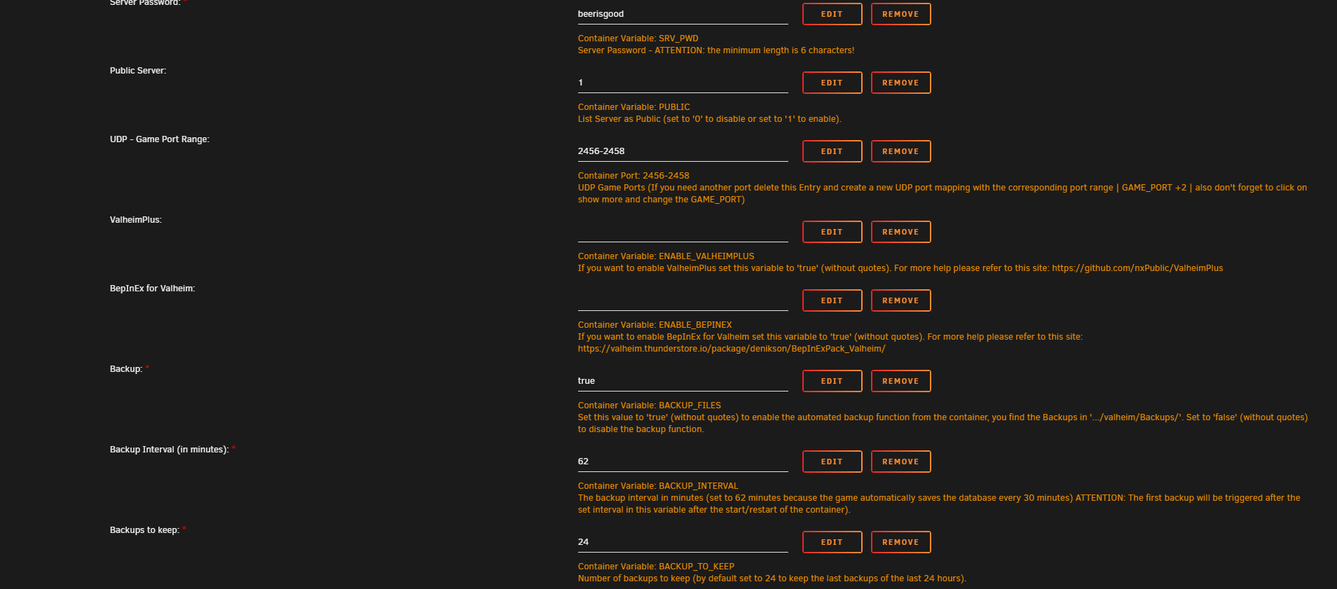

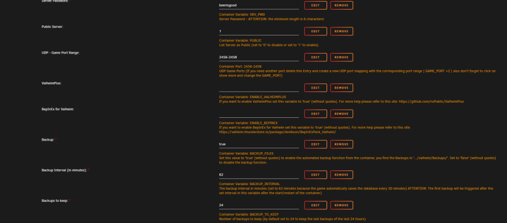

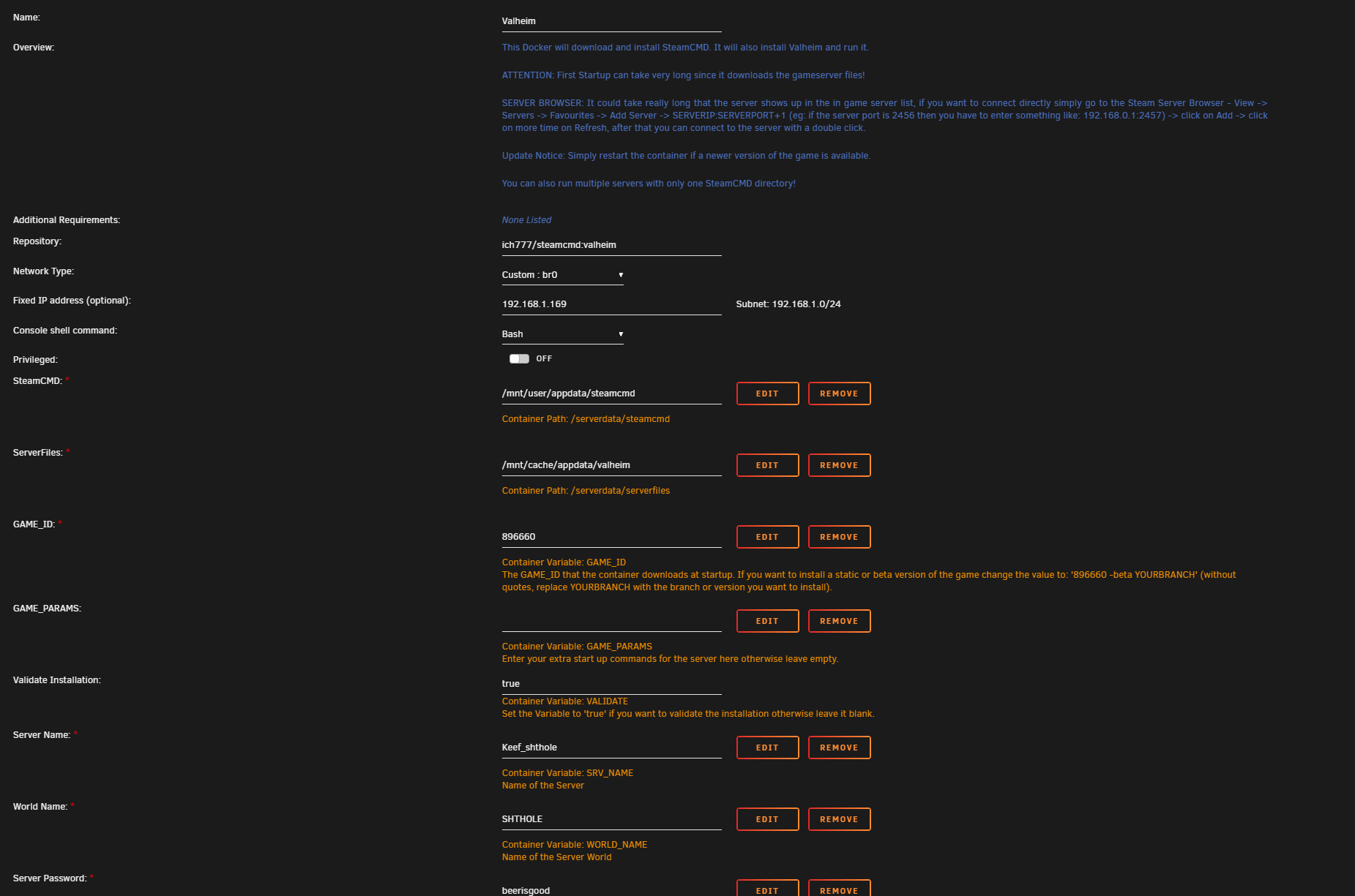

I have had no luck having my server populate in Valheim, anything in these logs that can be an issue?
Did you restart the container a few times from what I can see in the log output correct?
These lines indicates that the server was started correctly and is waiting for connections:
[S_API] SteamAPI_Init(): Loaded local 'steamclient.so' OK.
CAppInfoCacheReadFromDiskThread took 1 milliseconds to initialize
Setting breakpad minidump AppID = 892970
SteamInternal_SetMinidumpSteamID:  Caching Steam ID:  76561197960265728 [API loaded no]
[S_API FAIL] Tried to access Steam interface SteamNetworkingUtils004 before SteamAPI_Init succeeded.
(please also note that this message don't have to show up immediately and it can take some time to show up)
Can you also share a bit more information since I really can't help with that little information.
What are your settings in the template?
Have you changed anything in the template?
Do you use BepInEx or Valheim+?
I assume you enable valdiation, please disable it <- this won't basically do nothing.
If the container is not restarting it is usually started and waiting for connections.

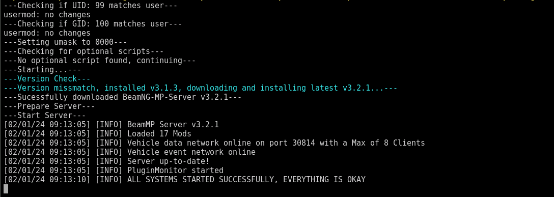

I am having an issue updating my BeamMP server using the docker, I start the container, and when it gets to version check, it's unable to install the update, and goes into sleep mode. I've tried reinstalling the Docker, and force updating, but neither worked. Any other suggestions as to what can fix it?

Please stop the container, go to the directory for BeamNG-MP and delete the files: "BeamMP-Server" & "beamngmp_v...", start the container again.
This should fix your issue.
Thanks for the response, I am just trying to setup plain vanilla Valheim. I have restarted the container also deleted and reinstalled multiple times. I did turn off verification after taking these screenshots. I have forwarded ports 2456-2458 on my router still not seeing the server for whatever reason.  1688341211_Screenshot2024-01-02133052.thumb.png.6afe82e7e80191aa70e2680c161b3c97.png1781088573_Screenshot2024-01-02133214.thumb.png.282242a720ae6fe26dee0e7847bf42ec.png
Please disable Validation, that won't help, as said above this is only if you have issues that the container doesn't update the game properly.
Is the container restarting or does it display Starting Server/the message that I've posted in my previous post? If the container is not restarting chances are high that it is running properly and some kind of network issue.
Have you yet tried to do a direct connection simply by entering your specified IP for the container (in your case 192.168.1.169)? <- I would recommend that you leave it on the default bridge and not using br0 but that's of course up to you.
Most of the times it's an issue with Hair Pin NAT that the server won't show up from your local network, have you yet tried to connect from outside your network or see if you can reach the server from outside your network with the ports forwarded in your router?
