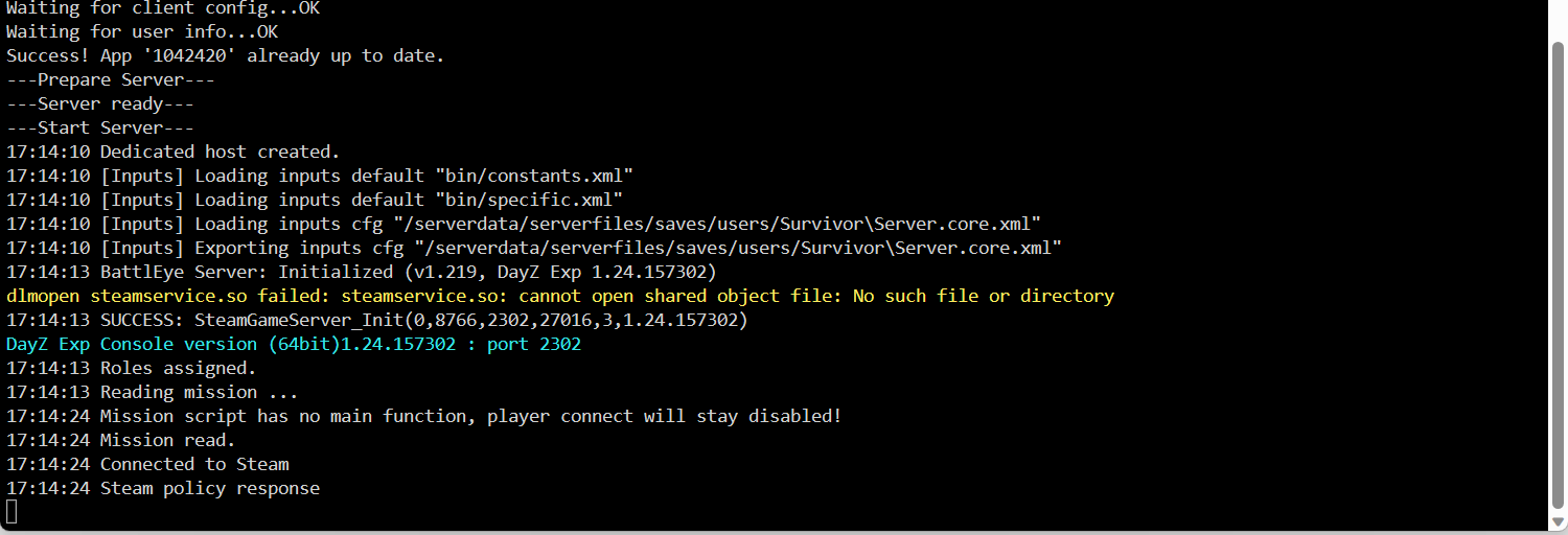

Did the DayZ container get borked since the latest DayZ Experimental build?
My server gets to this point but not able to connect to it anymore.
//edit
weird - mpmissions folder was missing. Grabbed it from somewhere else and it launches fine
