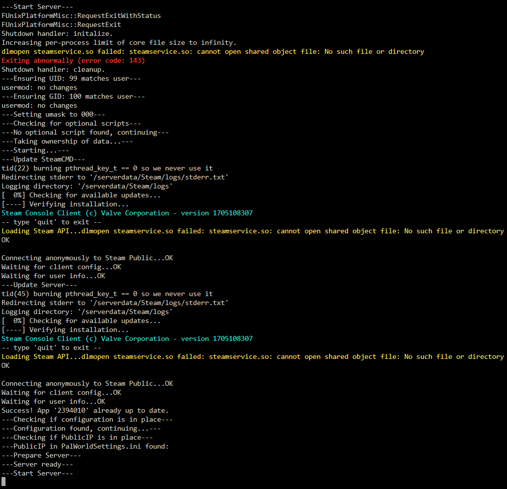

No too sure what I'm doing wrong (or if I'm doing anything wrong).
But I've tried a Palworld server and it seems to boot fine, however after 15-20 mins the server is not available. Like others , I believe port forwarding id fine because I use your other servers without issue.
What seems to happen is that the server starts, a random restart kicks in then it gets stuck on starting server.
A manual restart of the docker restarts the whole process again.
Log below:
Edited by montmyint
To what path in the Docker template are the game files set? If they are set to /mnt/cache/... then please make sure that the files stay on the cache and are not moved to the Array by the mover in the Share settings.
Are you sure you have enough driver space available and you don't run out of RAM?
15 minutes ago, therave39 said:
I see the same thing in my logs, despite it working correctly.
This is just normal an my server sits on the same screen like yours, this is actually a display issue and as long as the container doesn't restart everything is fine.
If it is properly running it consumes about 1-3GB of RAM

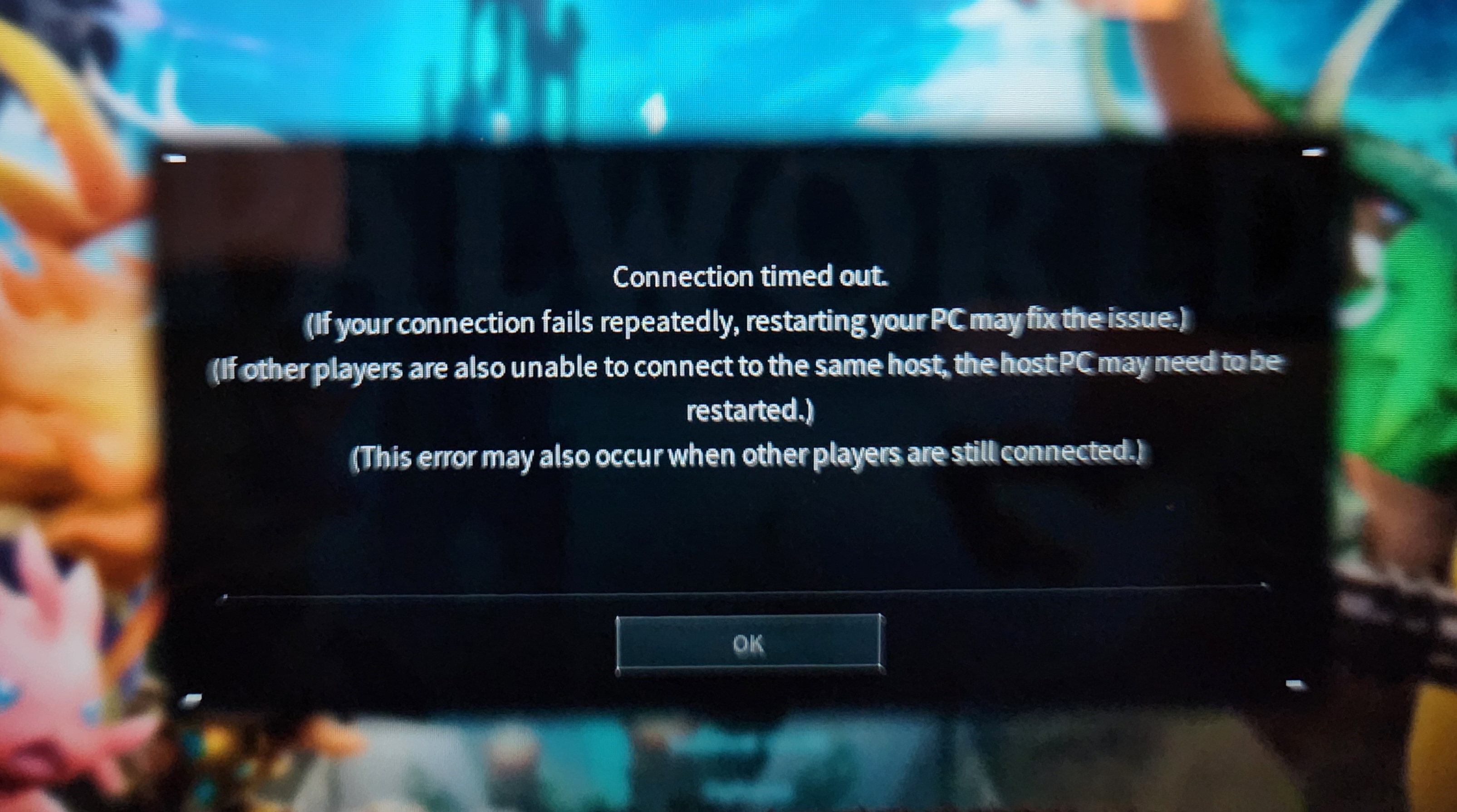

I am launching my server, but I can not join it. I'm on the same local network and the 8211 port is forwarded. I can not connect. Not really sure what to do. I've been hosting other games with no issues. I deleted the container, Deleted the app data and then reinstalled and I still can not connect. I could see it in community servers (after asking for 200 more results like 30 times) but connecting gives me a connection error.
Edited by nightspades
On 1/17/2024 at 2:26 AM, ich777 said:
Especially these website is often wrong and a automatic generated set of port forwards.
Could it be possible that your ISP is blocking certain ports, maybe all below 10000?
Have you yet tried another port that is higher than 10000?
Please also don't do port changes like that for game server containers because that will ultimately fail for most other servers, it is indeed working for Minecraft or Terraria but not for example for CounterStrike oder Valheim (see the first recommended post on top).
Have you yet tried to join from outside your LAN with your public IP address, often times the Hair Pin NAT on lower end routers/modems are not working properly and a connection from inside your network is not working.
Forgive me for not responding recently, I had become really busy but am free now.
To answer your first question, I did check with my ISP to see if they're blocking those ports and they were not.
For your 2nd question: I am unsure quite honestly, but I have used a vpn and that did not suffice while connected to my current router, besides one instance a while back for a minecraft server, but I did think of the possible problem which I would like your input on.
I have a "2nd router" (Not from my ISP) connected to my "main router" (From my ISP), and my server is connected to the "main router". Would the "2nd router" be possibly interfering with all these issues with my "main router"? Because the terraria server would not connect correctly unless I used my minecraft port, however, my minecraft port is being funneled through cloudflare, which is possibly the reason why it still functioned properly. I tested out my zomboid server again and that is not working, and just with the newly released palworld, it wasn't posting online again also, however it was indeed letting me connect to the world/server via lan. If this is the case, what would the possible solution be?  I assume I would have to go log onto the "2nd router" and possibly port forward on that also? But even then, I am unsure what I would port forward besides what is currently already being port forwarded on the main router.

I'm able to reach the "No password has been entered." screen when using the local IP and public IP and 8211 default port for the default container.
I have a problem when I spun up a couple of other containers, changed their ports in the container AND the palworldsettings.ini file, but I cannot connect to them.  I ensured the UDP 8212, 8213, etc were added to my port forwarding.  You have a note in the container @ich777 that says also don't forget to click an 'Show more settings ...' and change the port number, but I'm unsure what value you're intending us to change?
I'm also having issues getting port forwarding to work for Palworld. I tried removing the default port even and using 8220 and the result is the same. It shows closed using this website. I have Valheim and Mincraft servers running with no issues. Do we need to open another port?
