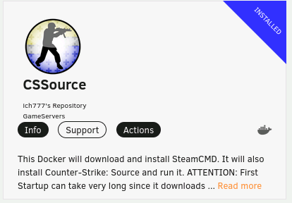

Hi ich777.....
Now when your CsSource container have been discontinued is there any other way to run CsSource?
Thanks for the good work you do !
Regards
// Hans
I'm not sure what you are talking about:
My CSSource container is not discontinued, it's available as usual.
I think you are talking about CS:GO correct?
In the case for CS:GO you would need to pull an old depot AFAIK, but I haven't looked into that yet.
There may be a few tutorials out there and they should be compatible with my containers too, just take the CS2 container and customize it.

Strange..
This is what i get when open up Apps, CSSource installed...
Click on the info and get the next pic..
And then action centre says Deprecated....
// Hans
I think this is caused because both containers are using the master or better speaking latest branch and CS:GO was deprecated in favour to CS2.
However, it is safe to ignore that since it is actually CS:GO what was deprecated.
Ok, thanks for the answer!
I just ignore it then.
Any way to really ignore it so action centre dont pick it up as an error?
Best regards
// Hans
Edited by Hansa
I'm not sure.
