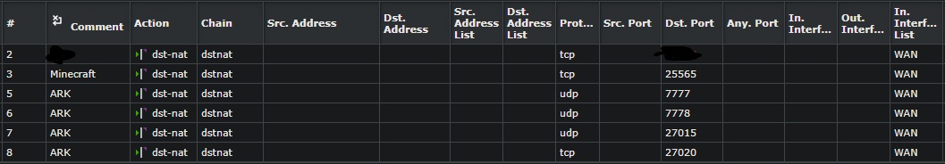

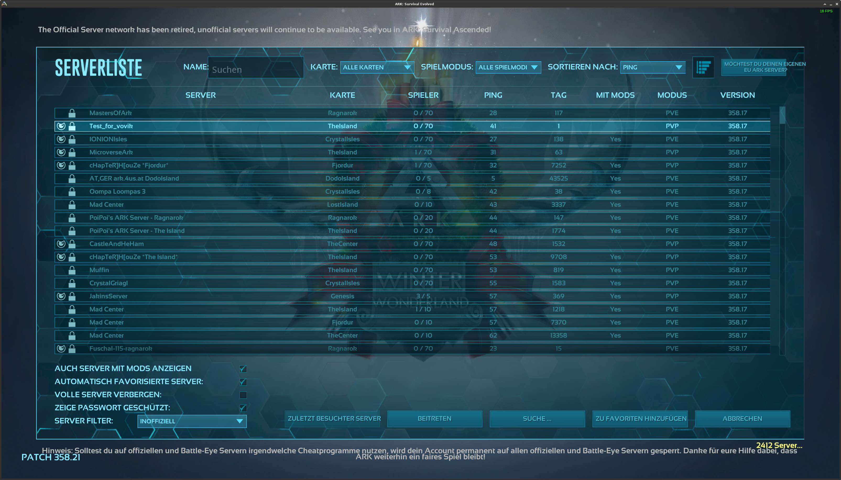

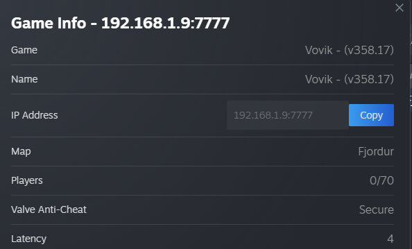

10 hours ago, ich777 said:
Have you yet tried to connect to the server from outside your network just to make sure it is not a Hair pin NAT issue?
I did try this yesterday with my phone's hotspot but it was still failing, however I re-tested it today with a friend and they are able to see the server after adding it to their "Favorites" as my <public IP>:27015
It seems that might have been my problem all along. I misunderstood how steam server list works. It seems it provides the list to your client at which point your client checks if it can communicate to those servers. Since I couldn't connect to my own public IP it never showed my server for me. I can see my own server from another IP or using VPN.
SEOS keywords below, please ignore
Steam ARK steamcmd unofficial session not showing up, LAN works, friends can't see ARK server, port 27015, port 7777, can't see server but LAN works, portforwad but server not showing on listing, dedicated ark server not showing on listing
Edited by vovik
  • Replies 12.6k
  • Views 2.4m

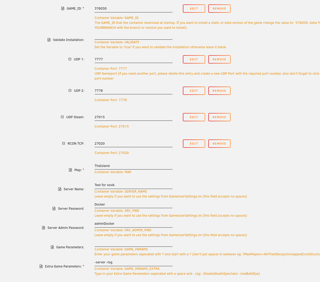

Out of curiosity I just tried it and have no issues whatsoever:
Are you sure you've ticked the box to show password protected servers?
These are my Docker template settings:
I just forwarded Port 7777, 7778 and 27015 (all UDP) in my Firewall and that's it.
Sorry for the confusion, it is working now. The problem was that the server did not show up for me only, because of Hair pin NAT issue which led me to believe it wasn't public.

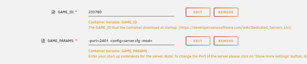

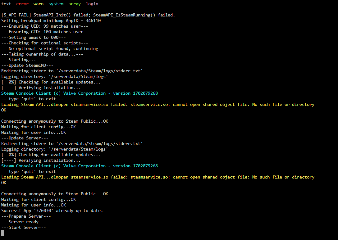

Just started using your Arma3 docker and works fantastically, i have created a second server installed a second docker with a different name and also created new file paths so it is separate from the first server. I have changed all the game ports by 100 eg 2402-2406 also change the game port in the more settings drop down but when i load the second server it is still connecting to port 2302,2303 see below. Should this be 2402 and 2403?
13:05:46 Dedicated host created.
dlmopen steamservice.so failed: steamservice.so: cannot open shared object file: No such file or directory
13:06:07 Game Port: 2302, Steam Query Port: 2303
Arma 3 Console version 2.14.150957 x86 : port 2302
13:06:07 Host identity created.
I‘m not too sure for Arma3 anymore but please change the ports in the configuration to. I think that is what is causing the issue.
Which configuration? the server.cfg does not have port allocations in it.
Not too sure as said before since I haven't done anything with ARMA3 in a long time.
Try to add this to your GAME_PARAMS:
-port=2402
just that it looks like:
-port=2402
Thanks mate that worked.

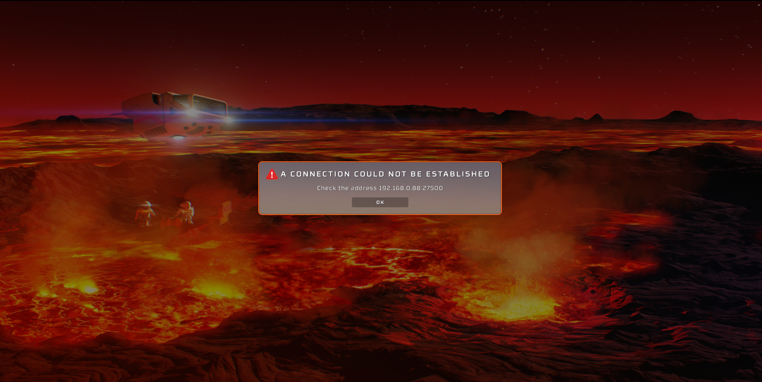

Has anyone been able to get the Stationeers container to work?
After changing the GAME_PARAMS to:
-loadlatest loadlatest Europa Europa AutoSave true SaveInterval 30
I'm finally able to get the server to launch I still can't connect.
Has anyone gotten to this point before and found a way to fix?
A big thank you to MXlvlnoob on the stationeers discord who was able to help me get to this point.
Edited by Jippolatta
The container is not working currently as another user reported on the previous page I think.
I haven't got time yet to fix that.
See next post.
On 1/3/2024 at 6:27 AM, thlillyr said:
Thanks for looking into that!!!
The container is now fixed.
It works now a bit different then it used to, you now configure your server with the file 'settings.xml' which lives in the main data directory from the container and you only have to provide -difficulty and -loadlatest like:
-difficulty easy -loadlatest Mars Mars
in GAME_PARAMS (in the above case you load the world "Mars" which runs on the map "Mars").
For all new installations the Docker template is updated and will work fine from now on (maybe takes two hours for CA to pick up the changes in the template), for existing installations you have to port over your settings from default.ini to settings.xml and customize the GAME_PARAMS like above.
Please also don't forget to update the Docker container itself in the first place.

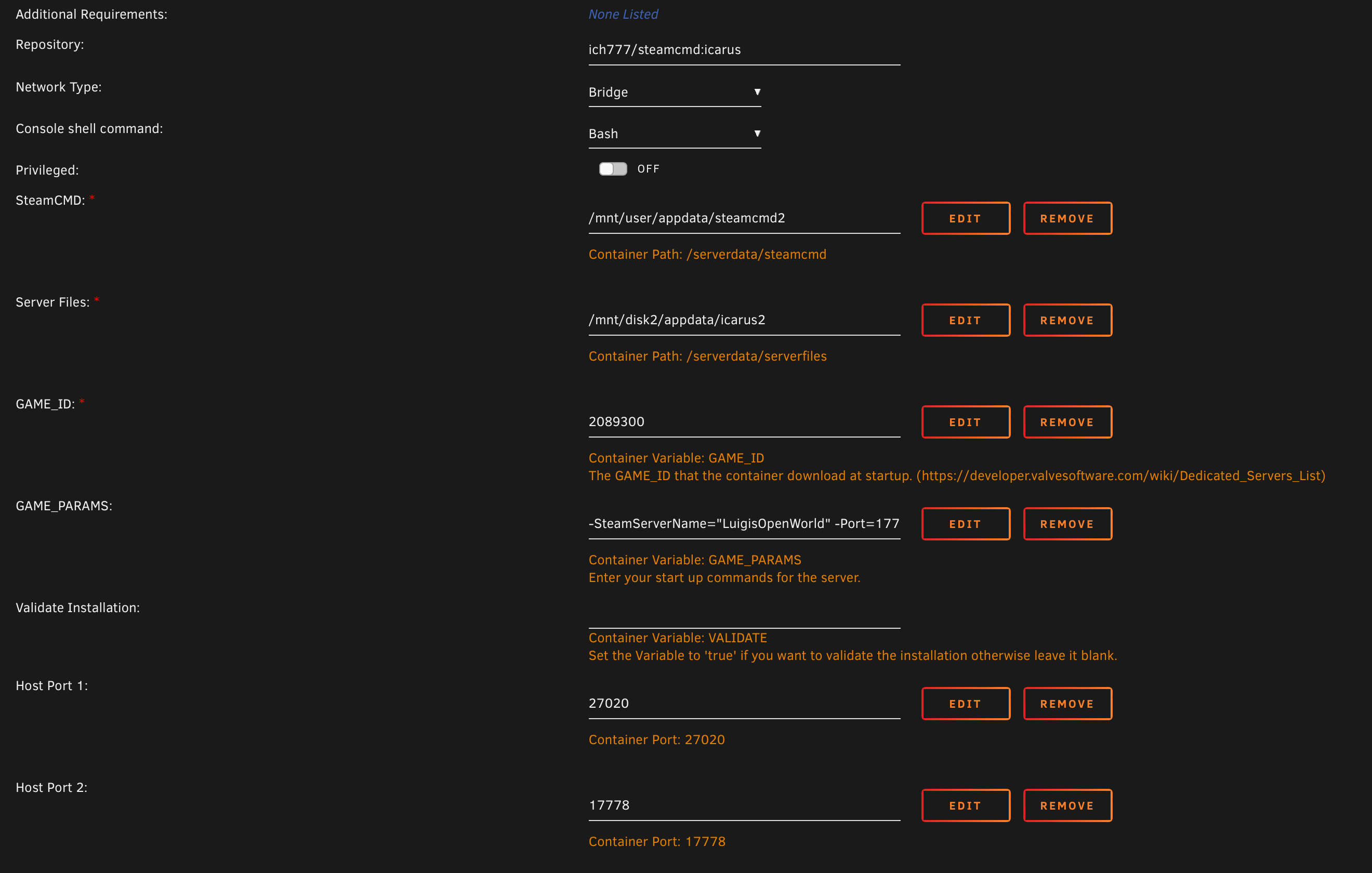

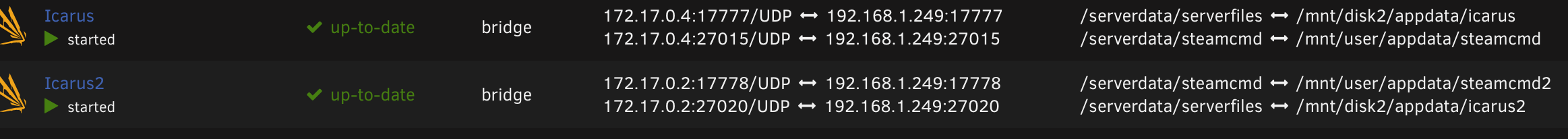

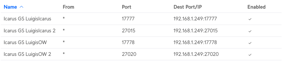

Hi, thanks for your fantastic work @ich777! I was able to setup an Icarus server and it is running perfectly. As my friends and me would like to have a 2nd server I've tried to add annother Icarus Container. I've changed the ports to 27025 and to 17787. I've deleted the existing port mappings and created new UDP ones. Also I've changed the Game Params accordingly:
-SteamServerName="LuigisOpenWorld" -Port=17787 -QueryPort=27025
I've crated a new steamcmd folder:
/mnt/user/appdata/steamcmd2
and for the server files:
/mnt/disk2/appdata/icarus2
Sadly, when I start the server it ends up with:

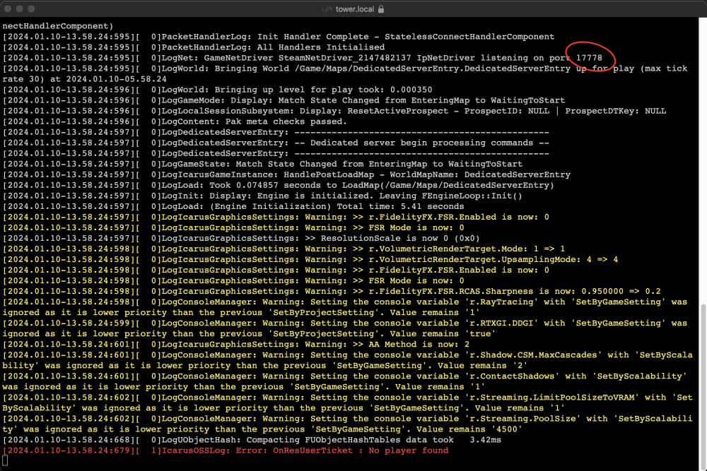

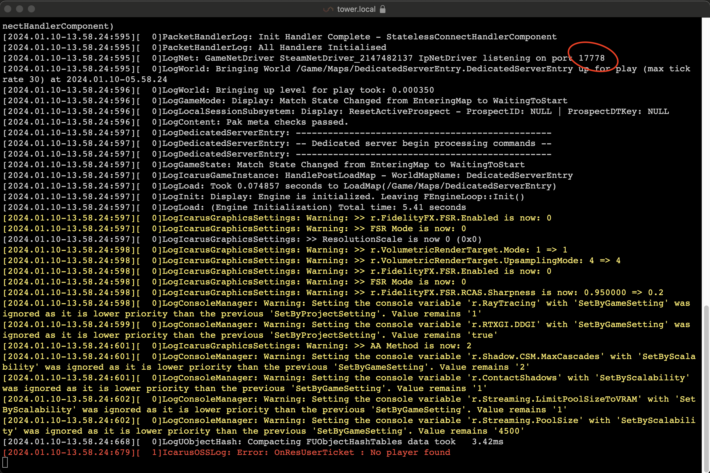

[2024.01.10-00.03.32:542][  1]IcarusOSSLog: Error: OnResUserTicket : No player found
And the server is not listed and does not show up.
I've deleted all the files and started from scratch several times. I don't know what I'm missing, do you know what is wrong?
Again many thanks and all the best,
Max
I will look into that in the next few days.

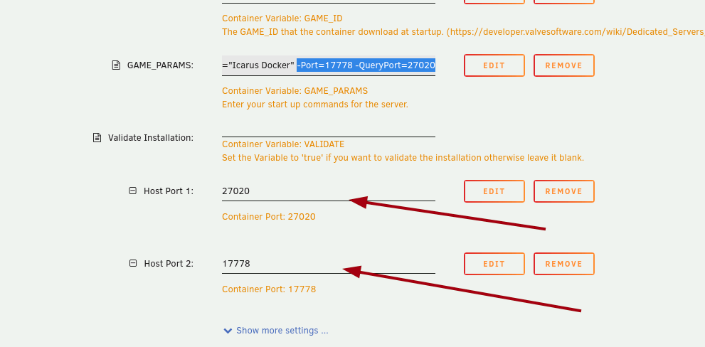

I've set it up like that:
It is listed on the server list and working as expected, are you sure that you've created UDP ports in the template and not TCP ports (by default they are TCP)?
Please also open up the log and see if you can spot these line which tells you the port:
It should list the port that you've specified in the GAME_PARAMS.
BTW, please be aware that some users reported to me that if you play for a longer period of time on the server that it crashes often, but I'm not too sure if that isn't already fixed by the developers.

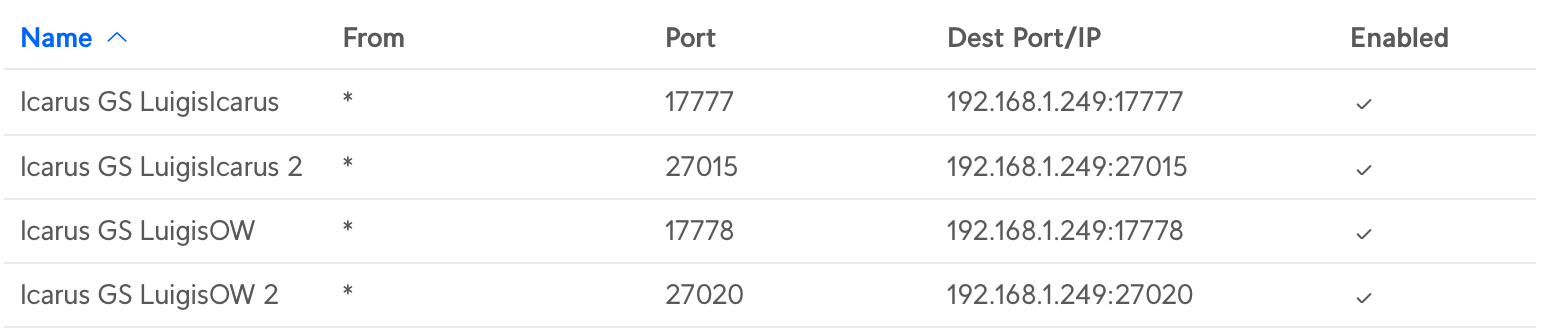

Hey, thanks for looking into it. I m pretty sure that I've followed the instructions. One question:
"UDP ports in the template" by template you mean, inside the config I click on "+ Add another Path, Port, Variable, Label or Device" and create the two new UDP Ports, correct?
Hope that it is okay, I've done several screenshots:
1046531473_Bildschirmfoto2024-01-10um14_59_52.thumb.png.7c2786fcaea47e7113ef6d36c2f987d6.png
1433001481_Bildschirmfoto2024-01-10um15_00_27.thumb.png.f7bea8edf79edbe1c75f22d4ded1cdd2.png
748348852_Bildschirmfoto2024-01-10um15_00_45.thumb.png.a06d45ee2b55ee743b7f68455ef8fea4.png
2000319978_Bildschirmfoto2024-01-10um14_59_31.thumb.png.25e4d72f81d01005efd2e7d49d61fb45.png
All the best,
Max
Yes.
That's odd, I really don't know why yours is not showing up but mine is (I only set up one server with a different port than the default one), maybe the developers have a limitation so that only one server shows up in the server list for one public IP <- this is of course an assumption...
But from what I see from your screenshots everything seems correct.
However I tried also to connect and it is working as expected.
