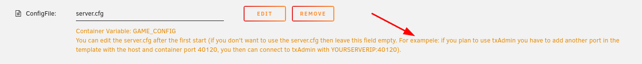

1 hour ago, ich777 said:
What do you mean you have a special DNS for it? Do you set up a domain for the container?
You can't access txAdmin from you LAN? There must be something wrong with the network setup, I really don't know what to tell you here, I've set up a instance just for testing and it is working over here and I get no errors so far.
i can access txAdmin from lan and from outside there is no problem with txAdmin, i have a domain for my unraid server and i am using tunnels for every container that i use.
It has to be a network error somewhere.

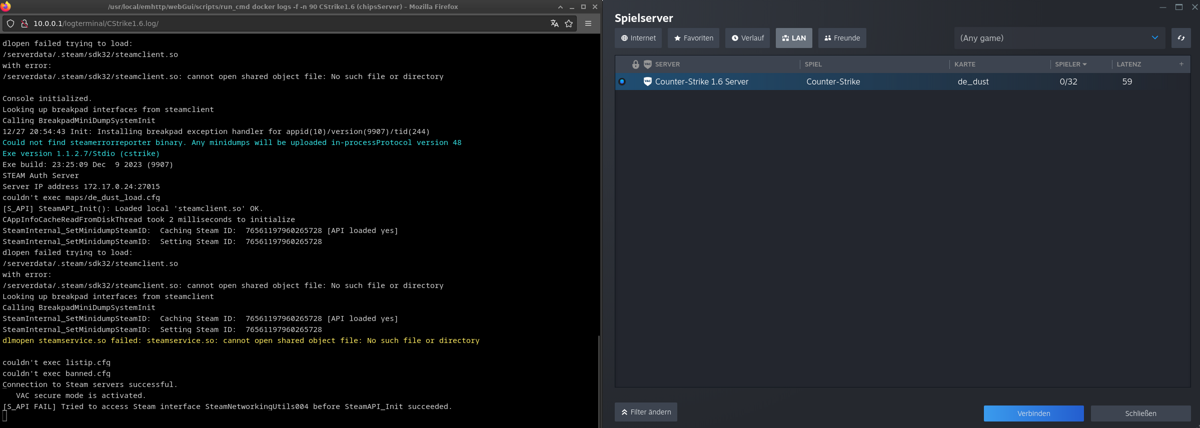

USE GOOGLE TRANSLATE  HIT 1 -  ROMANIA
de ceva timp imi bat capul cu servere , ca sa nu mai folosesc VM WIN pt server de cs1.6 / cs go
dupa 2 ore de futut in cur docarul cu presupusul server  sa il iau in pula de linux apare intr-un fila
pe internet mergand sa te conectezi pe el . si facut tot dupa spusele autorului ca la carte si nu vroia motivul nu stiu , citind toate topicurile legat de acest doker surpriza nu pori sa il controlezi servarul merge ca prostul ce vrea el cum vrea el , instalex amxmodx toate versiunile si credetima o iei la padura dupa ce instalezi vezi ca nu mai merge servarul sa vezi de ce , si de ce , rezolvare partiala este sa editez docarul sai dau sa verifice  acel parametru cu " true " surpriza merge servarul te poti conecta pe el dar nu il poti controla iar te introrici de unde ai plecat .
Poate eu sunt batut in cap ROG FRUMOS AUTORUL SA FACA UN TUTORIAL PAS CU PAS PENTRU   CS 1.6 & CS GO  sa aibe si accces la server pentru a schimba harta etc etc  . Pana atunci imi cer scuze dar  GAME SERVER  de cand a aparut eu nu am reusit sal fac sa mearga ca un server care il tin pe VM DEDICAT DIN UNRAID
Sorry but you are using a lot of swear words I if my Google translate is correct and I'm not happy about that because we have forum rules here, they apply also if you are using a foreign language I would however prefer that you use Google translate and post the translation to English here, that would make my life (and maybe the life of other users here) easier because the main forum language is English...
However you should really take a look Meta Mod in combination with Source Mod since I use these to have a in game menu and change Maps, Bots, Player commands and so on.
You can also do that from the command line with RCON. :)
Sorry, I won't do a full tutorial because I only provide basic functionality, so to speak the game server itself (modding is always up to the user and I can't help with that because there are many games and even more mods for the games and I simply can't know every mod and how to even mod the game - I do for a few and try to help where I can ;) ).
However in terms of CS:GO it is a completely different story because if you would have searched for "CS:GO Unraid" on Google one of the first results is the blog post from over here. :D

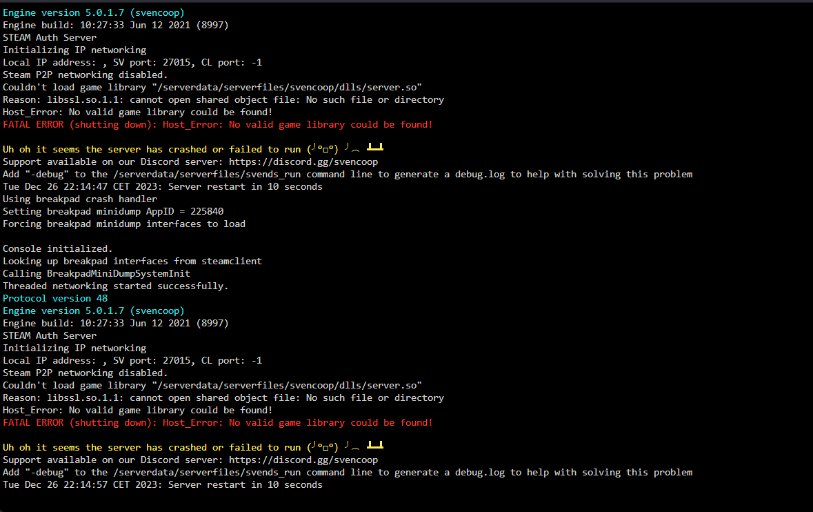

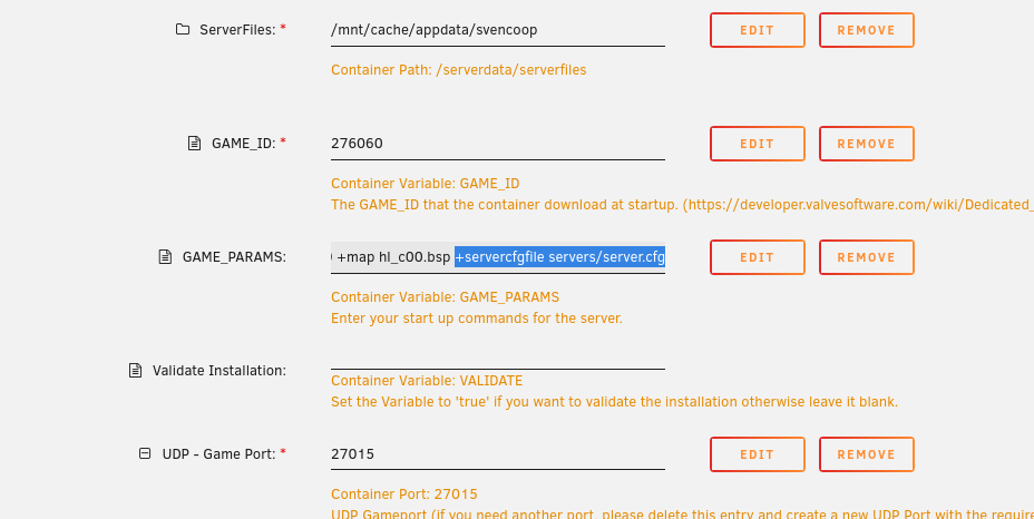

Hello there is a problem regarding the installation of the Sven Co-Op server I do not understand 😅
22 minutes ago, Logidroid said:
Sven Co-Op
Thanks for the report, I will look into that and report back.
39 minutes ago, Logidroid said:
Please update the container itself (by clicking "force update" on the Docker page with Advanced View enabled) and it should work again. :)

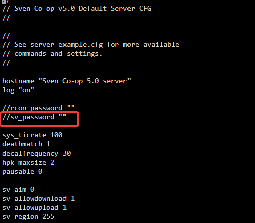

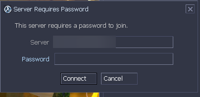

one last little thing.
have you done any configuration on your side regarding passwords ?
because I have a password that is requested and I don't know how to remove it.
very strange because in the server.cfg there are no passwords 🤔

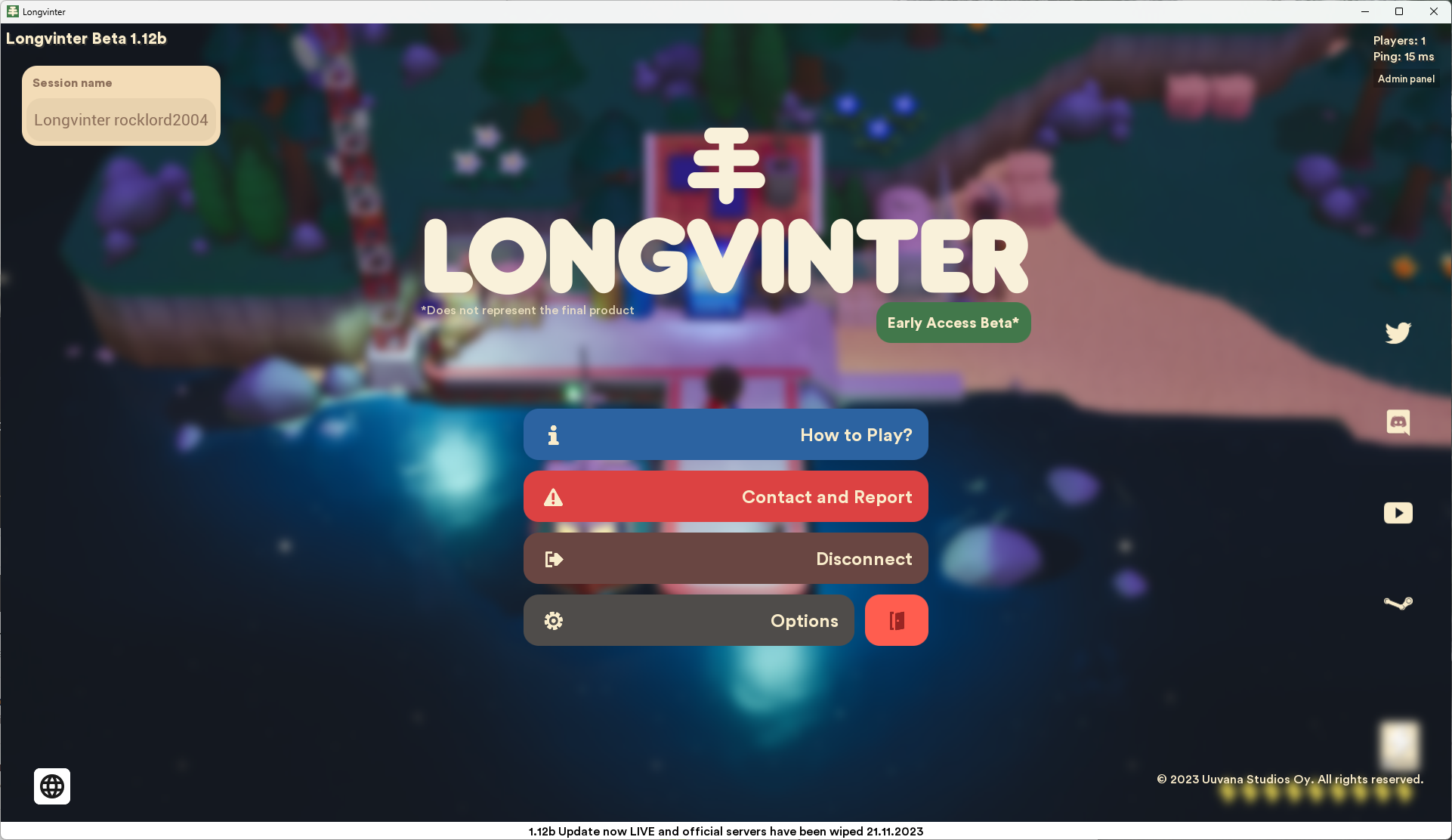

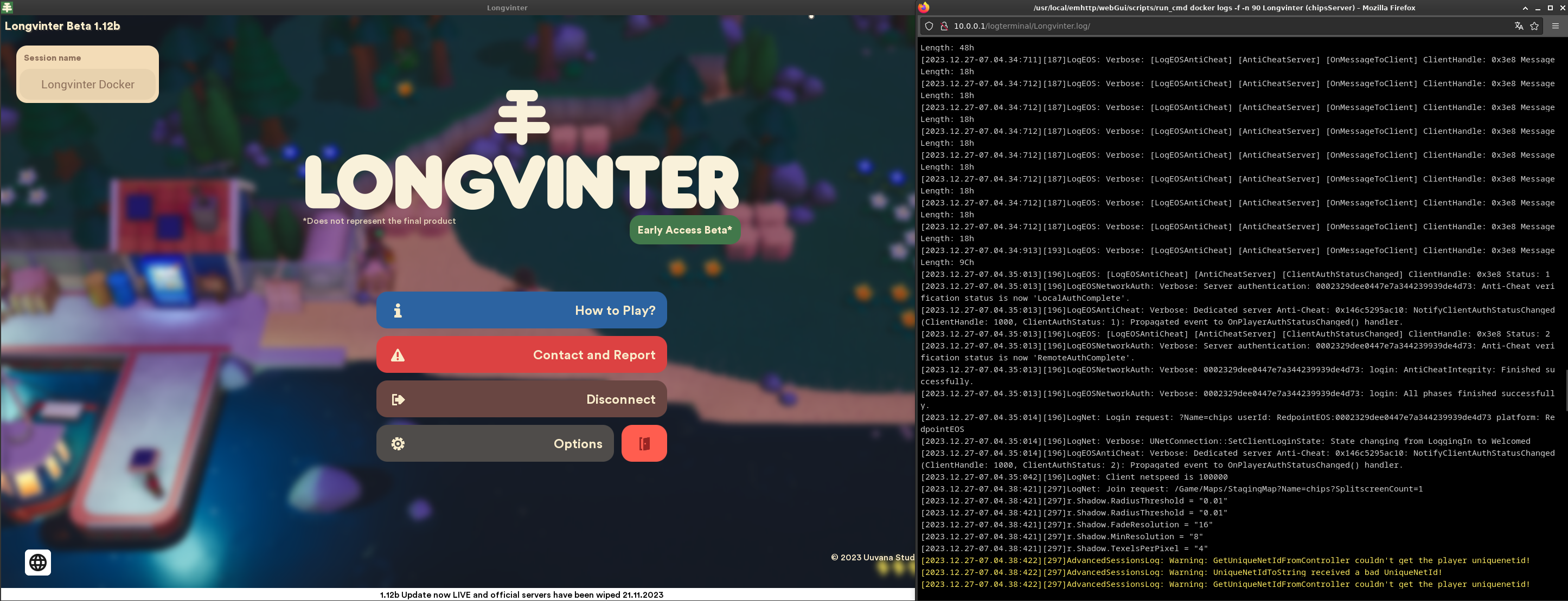

I'm unable to connect to a Longvinter server. I believe I have forwarded the right ports. I even tried stopping all other containers to prevent conflicts. The server shows up in the browser. I get this message after a while when trying to connect.
The log window seems to show the server running so I'm not sure what I'm missing. I'm able to connect to random other servers, both official and unofficial. Let me know if there is anything else you need to help troubleshoot.
I forgot to mention. Almost all of these files are blank when opened. Only Engine, Game, Game.ini.default, and GameUserSettings have anything in them.
Are you sure that you look in the correct server.cfg, the container usually ships with a server.cfg that has the password "Docker" and "adminDocker" (also right in the first post of this thread) set by default.
I have now tested it and it is working flawlessly:
I have both tested to connect from inside my local network and from outside.
Have you yet tried to connect with the local IP from your server just for testing purposes? Maybe you have issues with Hairpin NAT.
Nothing to worry about, this is the case for most dedicated game servers.
Looks like I got too focused on the server browser and didn't even think about the direct connect option. I was able to connect locally and when using my phone as a hotspot so I could be off network. The server browser still errors out though. I'm curious if there is a setting somewhere not having it use the 27016 port or I'm just missing a conflict in my forwarding. I'd bet I'm overlooking a conflict. I appreciate your reply though since direct connect will work well enough for the few friends I'll be playing it with.
So I've tried now many things and I'm happy to report that it is indeed working and only the specified port in the template is needed.
I've forwarded port 27016 UDP in my firewall, disconnected the network connection to my PC, set up a Hotspot on my mobile phone, connected my PC to it and I can connect to it via the hotspot. ;)
Strangely enough it is not working when I try to access the server from the server list when I'm on my LAN, so to speak when the game is listed with the suffix "(LAN)" right next to the server name <- seems like this is some kind of bug in the game since this was working when I initially create the container.
However if you are on the LAN you can connect through direct connection.
I've now deleted the server already but if you really want to I'll set up another instance that you can try to connect and you will see that it will indeed work.
I appreciate the offer but at this time I'll pass. I'll reach back out if more issues pop up when my friends try to connect to the server.

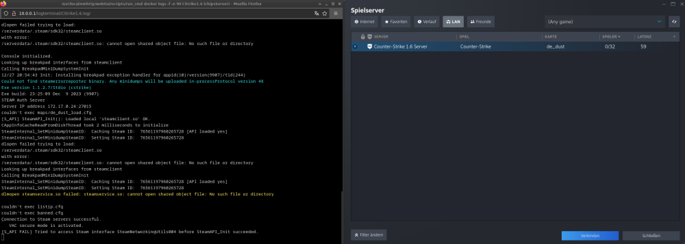

i try sourcemod &metamod is not working
just try it and create a new server cstrice1.6  and you will convince yourself that it doesn't work
Where? On CS:Source?
I just set it up and it is working as expected:
I can also connect to the container without any issue. :)
try cstrike 1.6
