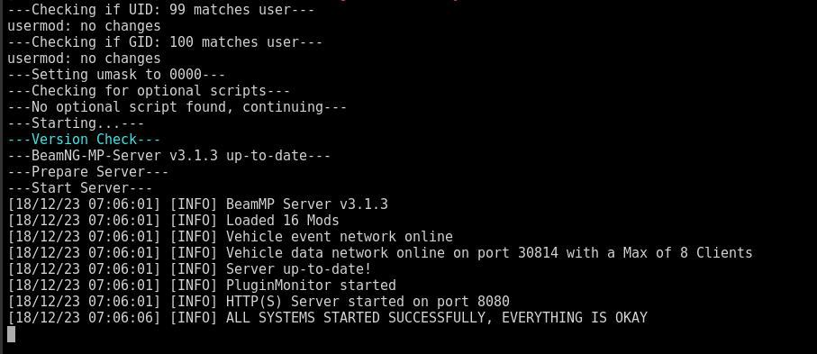

So i've been using the Beam MP container for a while now but with the most recent 3.1.3 update of the game server files they changed the file name from BeamMP-Server-Linux to BeamMP-Server-Ubuntu / BeamMP-Server-Debbian and the contrainer wont update in unraid.
This is from the logs:
---Checking if UID: 99 matches user---
---Checking if GID: 100 matches user---
---Setting umask to 0000---
---Starting...---
---Version Check---
---BeamNG-MP-Server not installed, installing...---
---Something went wrong, can't download BeamNG-MP-Server v3.1.3, putting container in sleep mode---
Are you really sure that you are on the latest version from the container? I've pushed an update a week ago or I think.
It is working fine over here:
Please also see this post (you maybe have to delete BeamMP-Server in your server directory) :
Sweet! Thanks that worked I didn't realize I had to delete the old server file I guess I should of read the thread some more. Got it working now!
