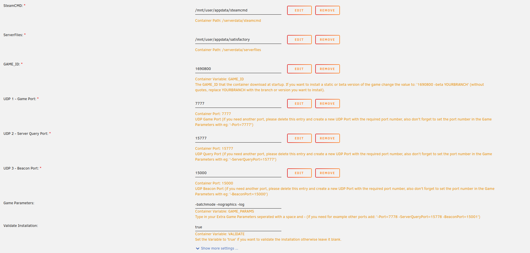

Hi ! Firstly, thank you for your amazing work !!!
I'm here because I'm trying to create a Satisfactory dedicated server, but I'm stuck in a loop...
I tried my best to find if anyone had the same issue on the thread before, but I didn't really found any clear solution...
Does theses logs remind you of any easy solution?
Please remove your Steam credentials from the container template, these are only necessary when they are NOT in the show more settings section and marked with a red asterisk in my templates.

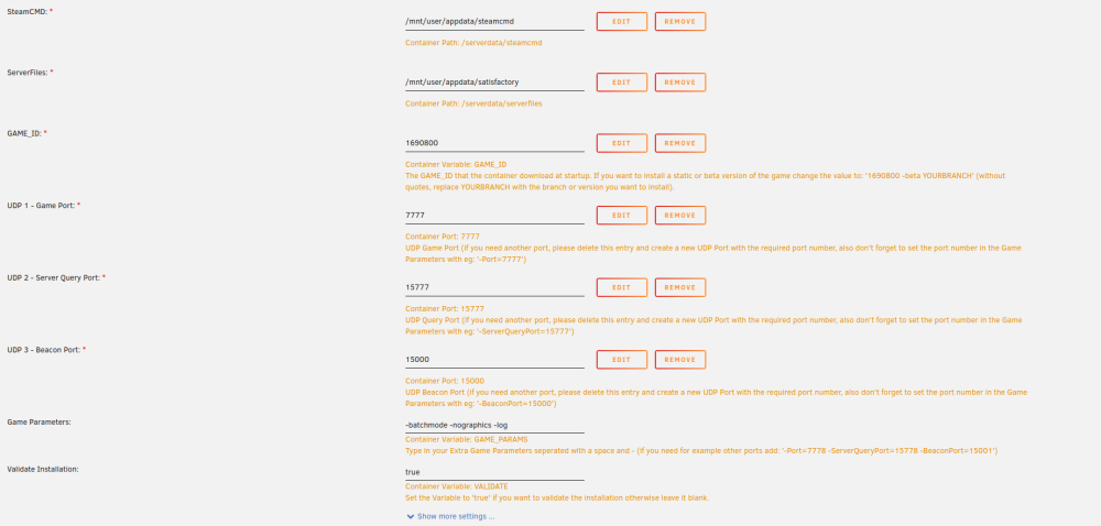

Thanks for this quick reply ! I've tried removing my steam credentials but it hasn't change anything... (sadly)
Here is some more details :
This is not the complete template.
Where did you remove the credentials? Why is Validate installation on, please remove true.
Delete the container and the directory for the container in your appdata directory and start over, without steam credentials.
I would also recommend that you specify the real path instead of the FUSE file path (/mnt/user/...) to the directory where the game files are and make sure that the appdata directory stays on the cache and is not moved over to the Array.
What's FUSE file path ?  What should I put ?
Please remove the template alongside with the satisfactory directory which lives in your appdata, after that pull a fresh copy from the CA App and change nothing and wait for the download to finish, this should do the job just fine.

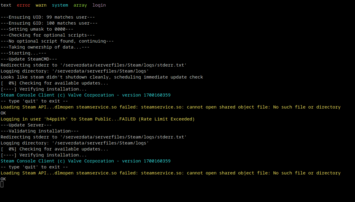

I did as you said but the docker keeps restarting every 50 seconds...
In what system do you try to run the game?
Do you have any logs from the new installation?
It is possible that your IP got banned from Steam because you‘ve entered Steam credentials.
You have to wait a few hours to get unbanned.
