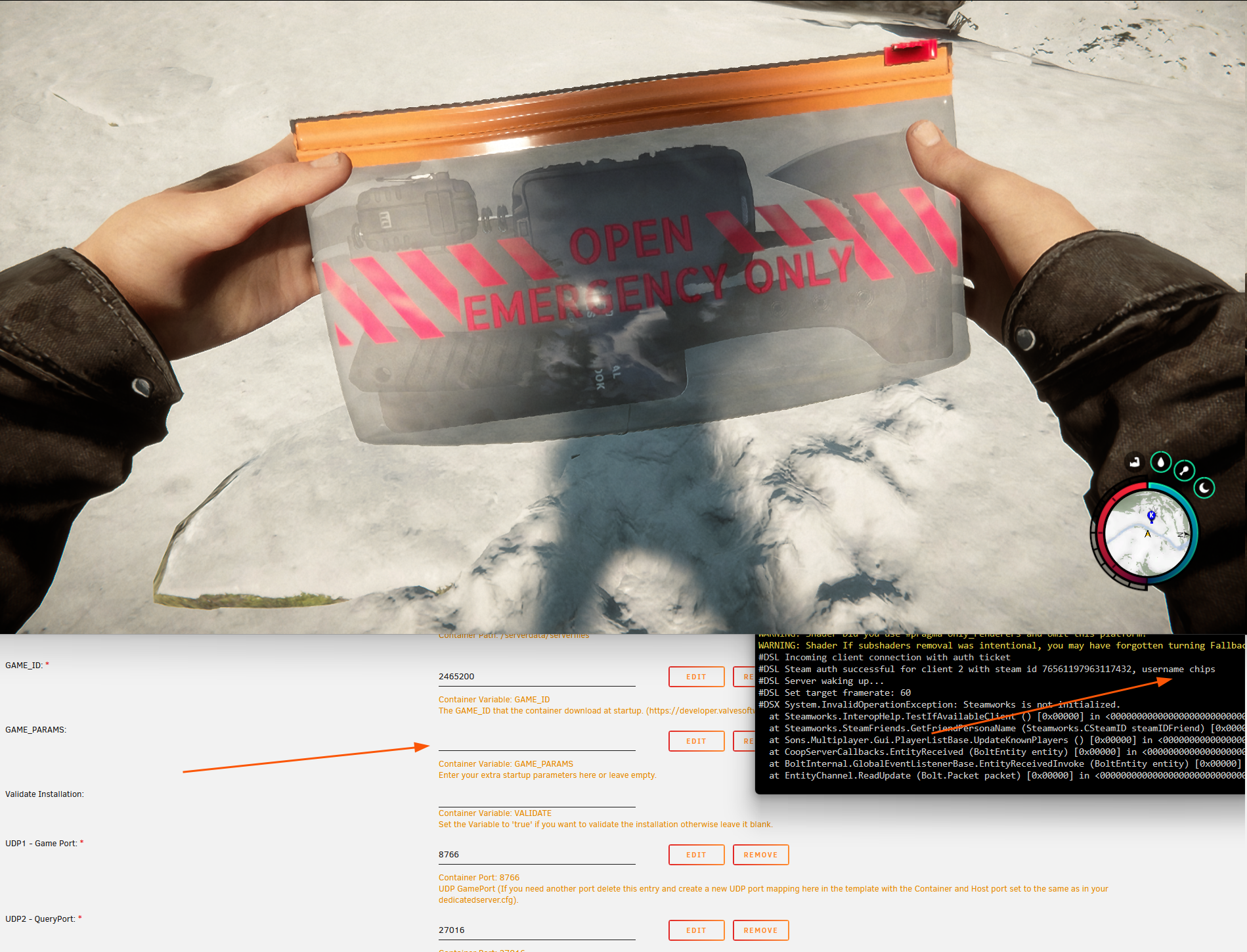

Hello all,
Hoping someone can help. Iv been running "the forest" and "sons of the forest" server docker on unriad for a while, HOWEVER the issue I'm always having with any docker server is the steam server token expires. in other words the GSLT is expiring because steam show no logins after 2 weeks.
Every two weeks I have to log into https://steamcommunity.com/dev/managegameservers and then regenerate a token, edit the docker GAME_PARAMS to the new token every 2(ish) weeks.

sons of the forest
The last time that I've created such a container it was not necessary to have a token for that dedicated server, are you sure that it's needed.

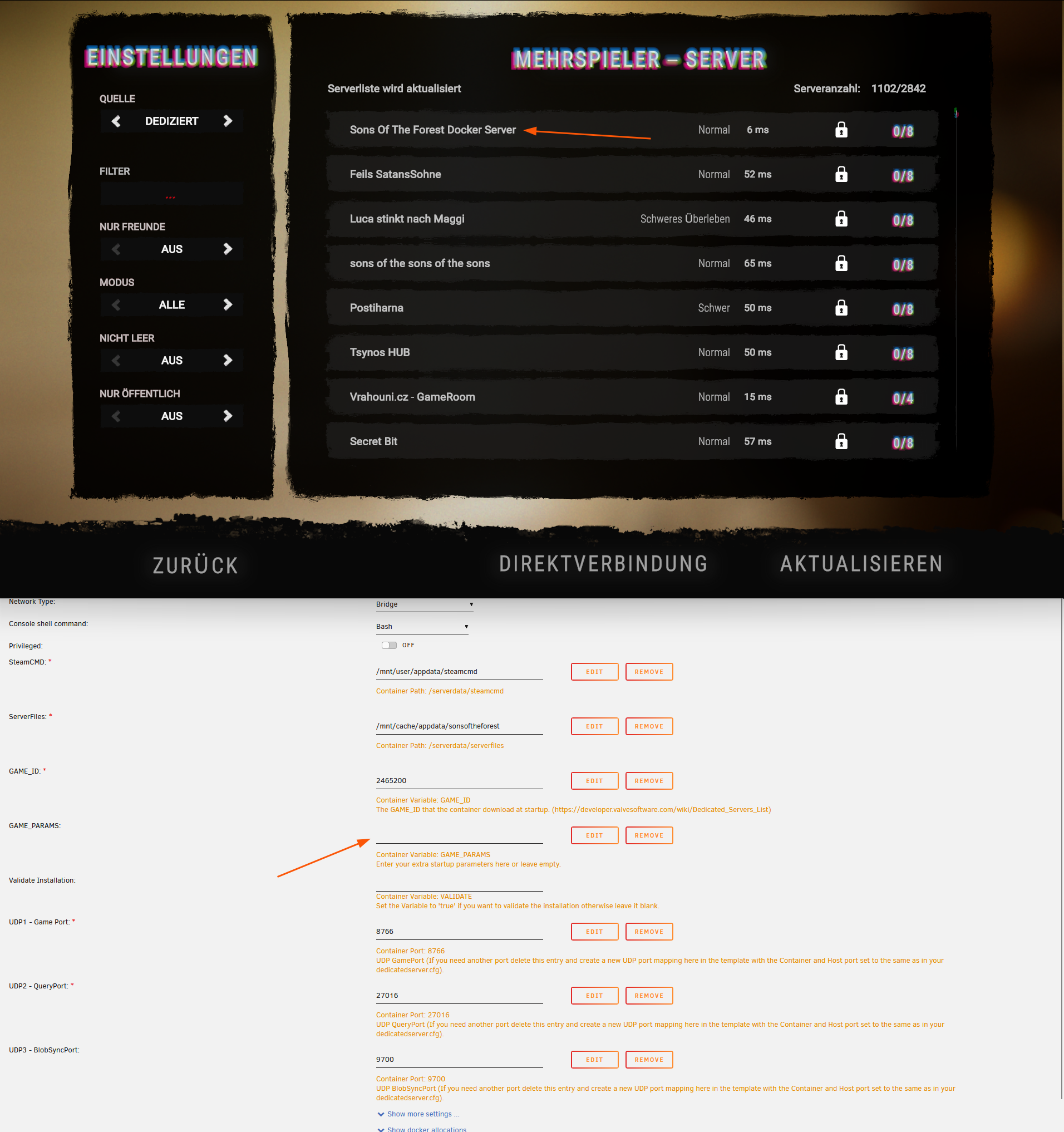

7 hours ago, Alex12345 said:
"sons of the forest" docker server and there are no instructions
Because you don't need a token for Sons of the Forest:
