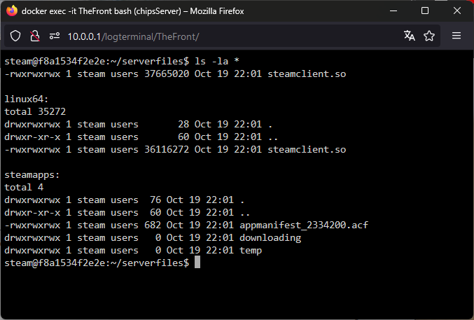

This is all what it pulls down:
Lol, now I get it, they marked the sub depot from App ID 2334201 as Windows and not as Linux *facepalm*

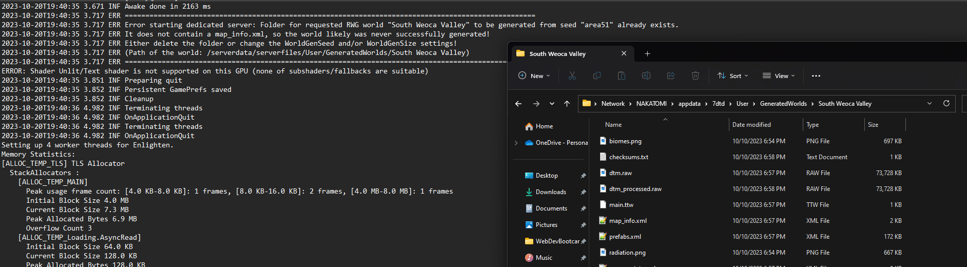

There's an error I keep receiving every time I try to boot up my 7DTD server.
2023-10-20T19:40:35 3.717 ERR It does not contain a map_info.xml, so the world likely was never successfully generated!
2023-10-20T19:40:35 3.717 ERR Either delete the folder or change the WorldGenSeed and/or WorldGenSize settings!
2023-10-20T19:40:35 3.717 ERR (Path of the world: /serverdata/serverfiles/User/GeneratedWorlds/South Weoca Valley)
I'll go to that folder on my server, though, and I do see that file. Does anyone know if this is an unraid security issue?
If I remember correctly you have to move the contents of the "South Weoca Valley" folder to the ../7dtd/saves/South Weoca Valley/<GameName>
where <GameName> is the value you put in the serverconfig.xml file and leave the <GameWorld> value as RWG.
You'll likely have to make those folders.
edit: fixed typo

That didn't seem to fix it. I got the same error. And all of the folders already existed.
Here's what I've discovered when it comes to RGW maps.
There are 2 folders with the name of your map. In my case, the name of the map is "South Weoca Valley".
There is a "South Weoca Valley" folder in both:
  • 7dtd/user/generatedworlds/south weoca valley
  • 7dtd/saves/south weoca valley
Based on your response, I copied everything from:
  • 7dtd\User\GeneratedWorlds\South Weoca Valley
And I pasted it into:
  • 7dtd\Saves\South Weoca Valley\Area 51
(Area 51 is the name of my save)
I even tried pasting it into:
I am receiving the same error every time.
Thank you for trying though. I do appreciate it.
