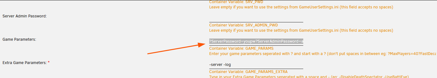

I currently have an ARK dedicated server up that works  and the small changes to XP damage all that works fine.  But when i try and put in ServerPassword=****** and ServerAdminPassword=*******     and i save and start up the server  itll start up fine  but those two and the RCON Port line always get erased and wont save  im really not sure what im doing wrong at this point.  Should the PW be in a different area?
GameUserSettings.ini
Where do you add it?
See the start up command here at step 6: Click
Try it like that:
?ServerPassword=youpw?ServerAdminPassword=adminpw
Try it like that:
That fixed it  thanks for the help and quick reply

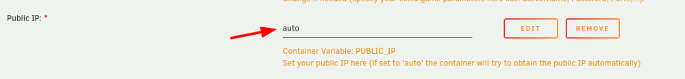

40 minutes ago, RumoMM said:
The Server is visible in the list and if i try to connect the button to start the game is not active and I can't see my char or anything.
Do you have a static IPv4 address? Please try to set this variable to your public IPv4:
41 minutes ago, RumoMM said:
After a view seconds there is a timeout popup.
This is caused because your client can't connect to the server, where the public IPv4 is needed.
Please go through your full Docker log from the container, where it should display your IPv4 and check if it detects it correctly.

20 minutes ago, alvaro.sousa said:
I have the same problem, I already put the public IP and it continued to have the same behavior. Upon further inspection, I noticed the following:
This is not the right entry.
I'll push a update to the container shortly because it returns IPv4 and IPv6 which is wrong and it should only return IPv4 if this value is set to auto.
Is your IPv4 reachable from outside? So to speak, have you forwarded all ports which are listed in the template and also with the correct protocol?
Have you yet tried to connect from outside your network? Is your Hair Pin NAT working properly?

2 hours ago, pacnwsoundstream said:
I had the same issue as the guys above. Could join server, but not create a character. After entering in my public IP and just leaving the server up for a few minutes
I've pushed an update yesterday which should make the 'auto' setting work properly when you have a public IPv4 and alongside with a public IPv6.
the logs show 0.0.0.0. but it does work fine
This is not the line which tells you the IP, however if you enter your public IP manually the log wont show it, if you leave it at auto the log shows it right before the start from the dedicated server.
I'll push another update to the container to show it even if it's entered manually.
