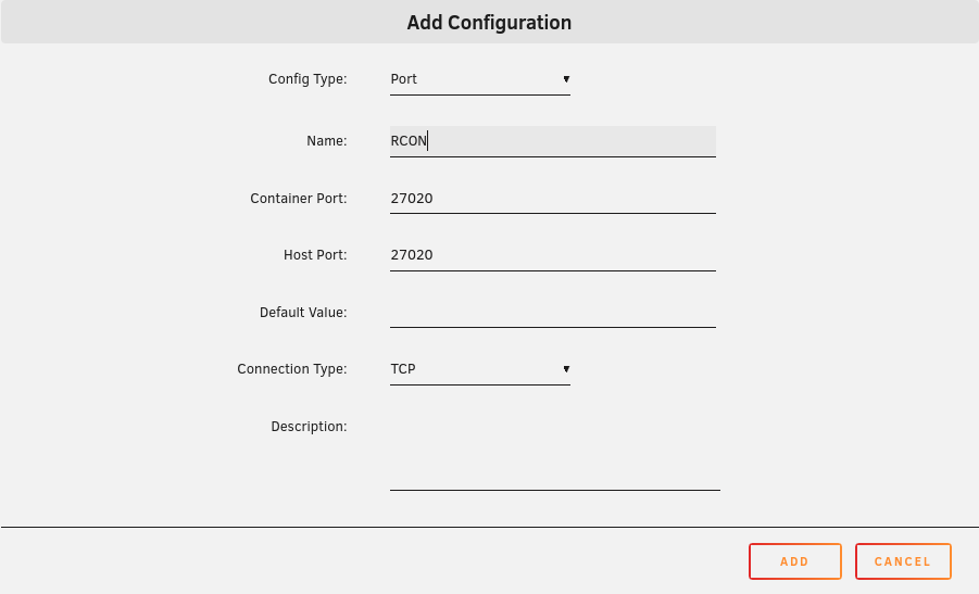

Hello @ich777,
Thank you for your great work on the Ark Ascended docker, I have it installed and mostly working.
The only issue I seem to be facing is connecting to RCON to manage the server remotely.
Any feedback or suggestions would be greatly appreciated.
I have tired a couple of different setup options to no avail.
(I'm wondering if maybe another command needs to be added like your 'UDP 1:' to allow access into the docker?)
You have to create a port forwarding in the Docker template too, as I see in your configuration file you have set 27020 TCP, then it would be:
Thank you for your guidance - This fixed my issue. 🎉
In your case Port 27015 does nothing because it is not needed and not forwarded in the template
This was referenced in an RCON tool I had tried (Probably outdated) called 'ARK Remote Admin' it used a reference in setup pointing to an RCON port and a Query Port. In a desperate attempt to get it working I also tried to forward this port. (Now removed)
Why do you forward 7777 TCP?
The only port you need to forward in your router is 7777 UDP
Thank you for pointing this out - I have now reverted my port forwards to only use 7777 UDP and 27020 TCP.
