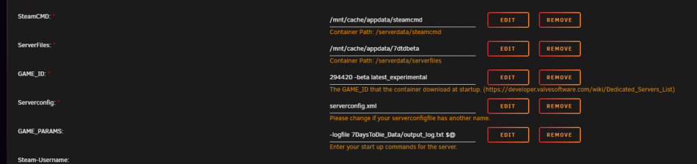

3 hours ago, ich777 said:
Where did you fill in -beta latest_experimental at the grafik.png.819fd3df8cb36c57869703cf3038065c.png?
You have to fill it in at: grafik.png.b766e1974ee9080b53e6afe6c587e798.png.

The GAME_PARAMS and the GAME_ID are two completely different commands.
With the GAME_ID you choose which game to download through SteamCMD and also you can add for example your option -beta latest_experimental (in your case this should be: '294420 -beta latest_experimental' wihtout quotes).
The GAME_PARAMS are startup commands for the game itself.

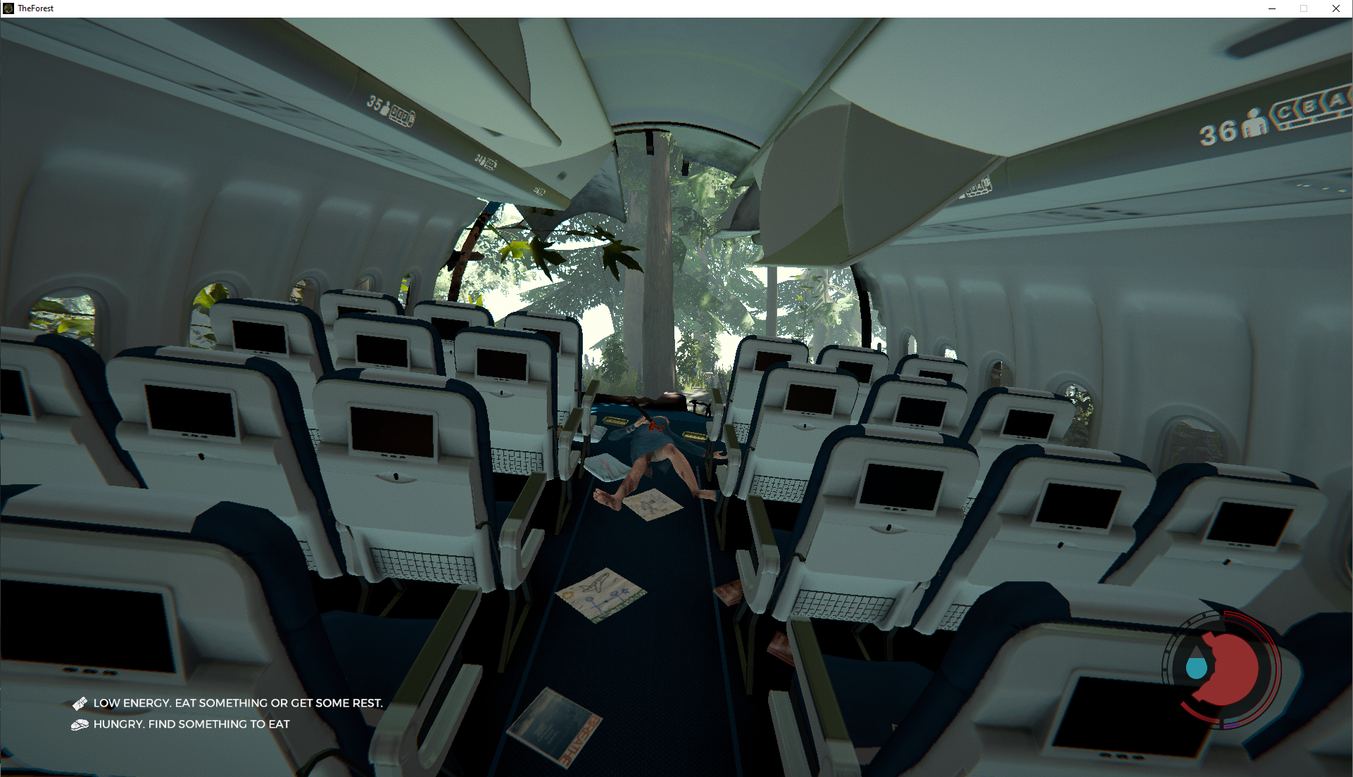

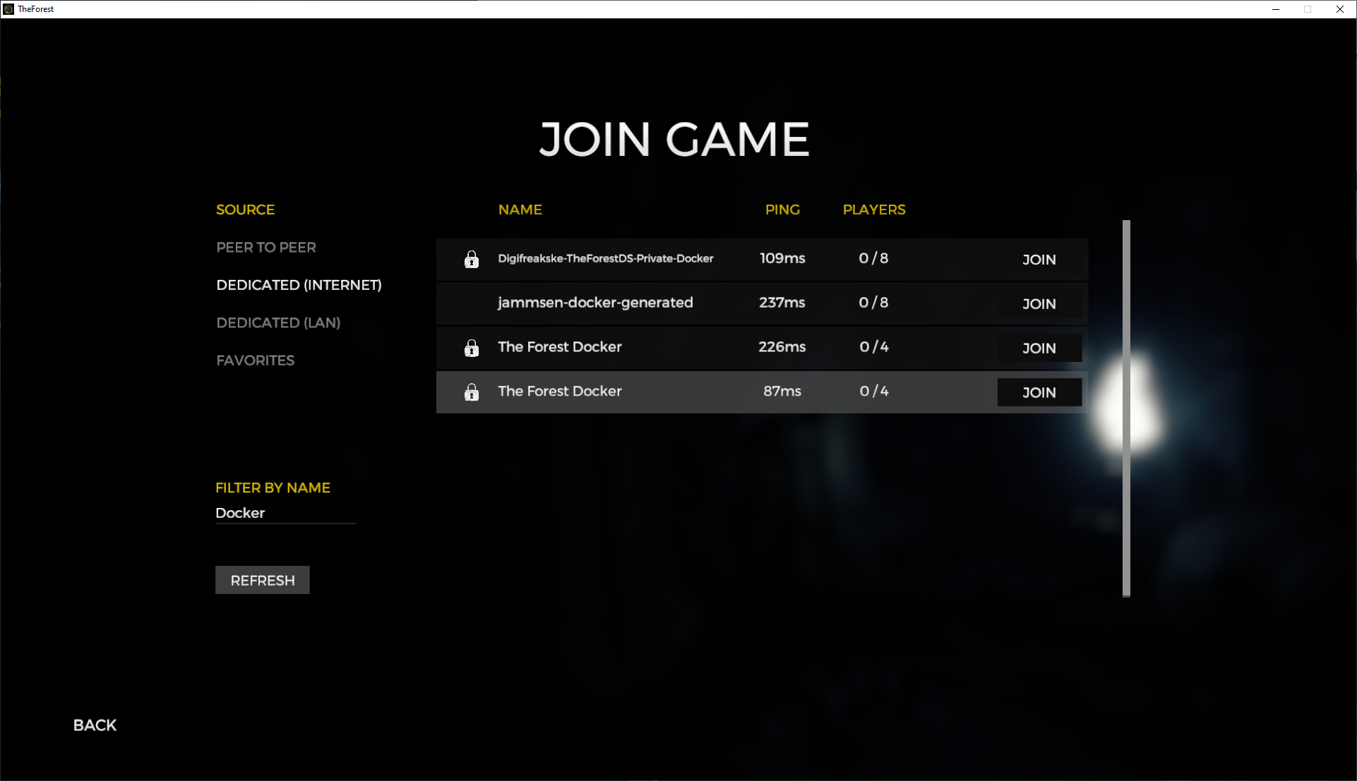

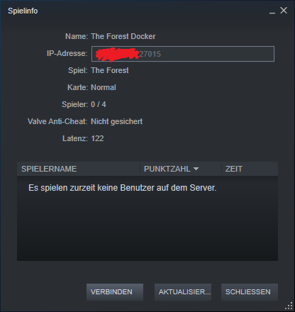

Attached a few screenshots:
Screenshot from the Steam Sever browser (please be sure to enter your IP and the port 27016):
Screenshot from the ingame server browser, the highlighted server (looks like someone else run the container with the default settings):
Here a screenshot from inside the game after entering the password and joining (prette useless since it's only a screenshot from the game):
Screenshot from my firewall settings (both TCP and UDP are forwarded tested only UDP after this screenshot):

4 hours ago, ich777 said:
Container works just fine from 'outside' and you only need to forward UDP ports, I will delete the TCP ports in the template. ;)

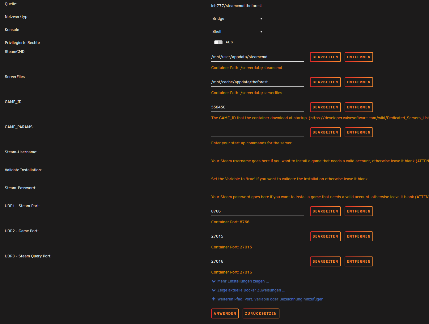

Oh, what I've seen so far on your screenshot that you attached later, don't use a Steam credentials (only use them when they are marked as required) and also you don't need the option -serversteamaccount
@dfox1787
This is what it should look like (I should really update the discription for this game since they changed a lot from when I created the container):

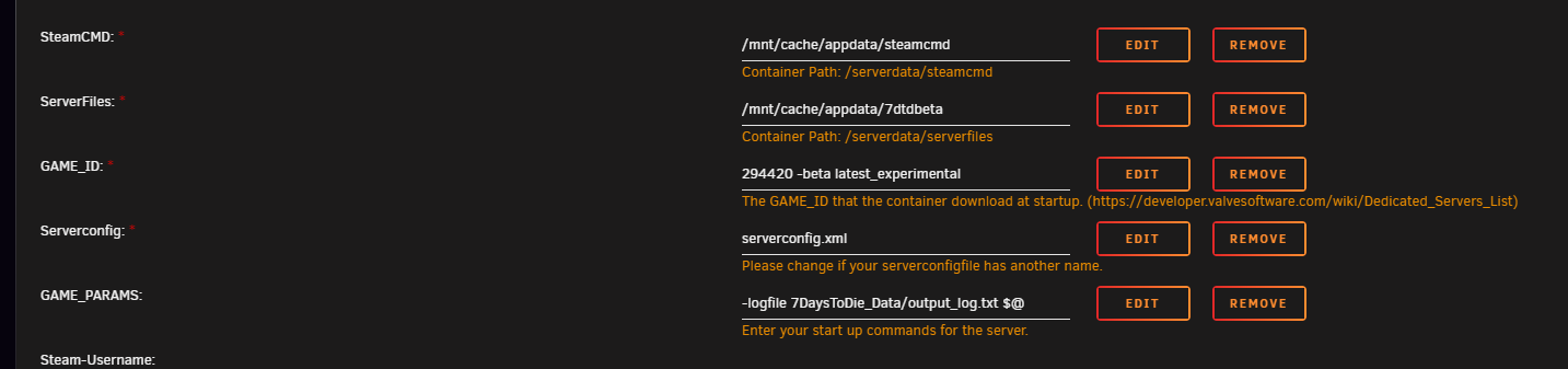

I'm having trouble installing the 7dtd -beta latest_experimental, just keeps boot looping
just gets stuck on here without creds

No, you are not stuck, just wait like the discription says, look on the usage of your CPU, the container is downloading the game and this can take very long and the log is not frequently updated in this process but I can't change anything about that.
EDIT: @dfox1787 also, please don't interrupt this process and wait for it to finish since this can cause problems...

I have to say that I don't own the game and I started over by completely downloading it but in my case it works (but can't say if I can connect since I'm not owning the game...).
Where have you put the '-beta latest_experimental'? Also doesn't the log say more? Can you attach a screenshot from your template configuration?
I attached the log and also a screenshot: Log.txt
thanks did download in the end. Deleted everything
New error now :(
8 minutes ago, ich777 said:
Sorry took a while this game is not small and this also took a while on my 250Mbit/s line... :D

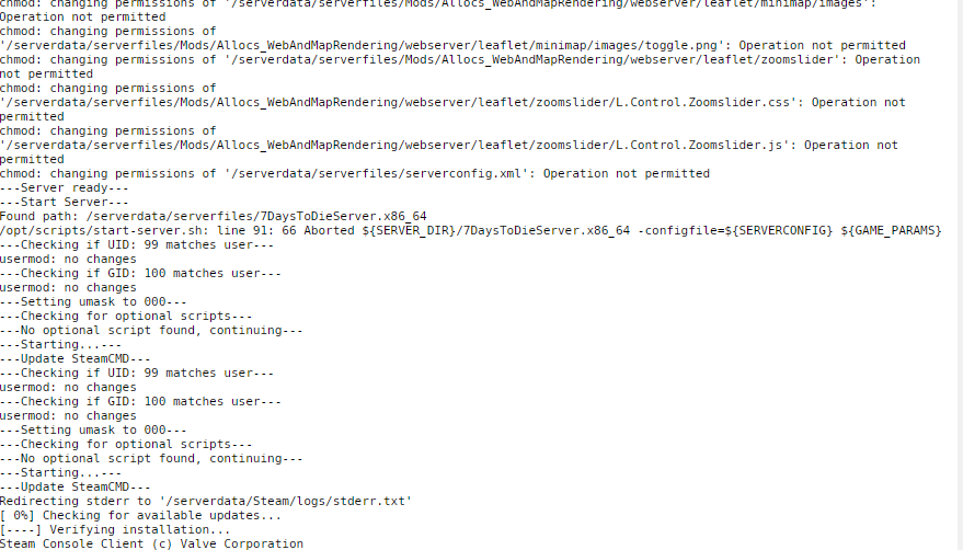

Mine seems to have Downloaded after a reboot of the docker, but it still won't start... Here are the logs.
Success! App '294420' fully installed.
---Prepare Server---
---Moving SaveGameFolder location---
---Savegame location found---
---Moving UserDataFolder location---
---UserDataFolder location found---
---Server ready---
---Start Server---
Found path: /serverdata/serverfiles/7DaysToDieServer.x86_64
[S_API FAIL] SteamAPI_Init() failed; SteamAPI_IsSteamRunning() failed.
Setting breakpad minidump AppID = 251570
---Checking if UID: 99 matches user---
usermod: no changes
---Checking if GID: 100 matches user---
usermod: no changes
---Setting umask to 000---
---Starting...---
---Update SteamCMD---
Redirecting stderr to '/serverdata/Steam/logs/stderr.txt'
[ 0%] Checking for available updates...
[----] Verifying installation...
Steam Console Client (c) Valve Corporation
-- type 'quit' to exit --
Loading Steam API...Warning: failed to init SDL thread priority manager: SDL not found
OK.
Connecting anonymously to Steam Public...Logged in OK
Waiting for user info...OK
---Update Server---

The server doesn't seem to actually start, though I do have the server files in appdata...
New error now :(
Please don't change the server IP, leave it as it is, it's 0.0.0.0 by default I think.
If you set it to your internal IP it simply can't work.
The log looks good since, how much RAM does the container use, mine is about ~2.2GB if it uses about that the server should be up and running.
Anything other I simply can't help and I can't test anything because I don't own the game.
If you and a second person report it as broken I will pull it from the CA App, simply because I can't test/help.
@dfox1787 After looking at your config file you deleted the whole line under the password or am I wrong? If you did so please add this in the password line 'serverPassword'.
The entry 'serverPassword' has to be in there even if you don't want a password (the password follows after this entry - if you want no password type nothing after it).
EDIT: @dfox1787 this should be your config file: config.cfg
And don't forget to restart the container after changing anything in there.
Upon a second restart, it appears the container is trying to set file permissions but is being denied access to do so...
Sorry I can't help, mine works after a restart fine.
EDIT: I also see that you have mods installed... how did you copied them over?
EDIT2: Please answer the other questions too.
EDIT: Also I see that you have mods installed... how did you copy them over?
The mods and serverconfig.xml were transferred using windows file explorer directly into the appdata/7dtdbeta folder, runing chomd/chown from the terminal seems to have fixed the permission issue.
Its now using between 15-300MB of ram just cycling through a boot loop...

---Start Server---
/opt/scripts/start-server.sh: line 91: 66 Aborted ${SERVER_DIR}/7DaysToDieServer.x86_64 -configfile=${SERVERCONFIG} ${GAME_PARAMS}

All is fine on my primary server which is on the stable release branch, and i don't think I've done anything different.... I've probably missed something.
Can you try to start the server without mods or even start over new?
Without the mods was unsuccessful but after wiping the appdata folders and reinstalling the container, I seem to be up and running! Thanks so much for your help! 😊
Its working now.
the fix was:
1 - do not use another steam account to download the server. use public.
2 - do not edit the IP details in the server config
3 - remove TCP entrties from the docker settings
4 - be patient
4 minutes ago, dfox1787 said:
Its working now.
the fix was:
4 - be patient
Thanks for the update ;)
1 - Yes, only use the credentials if the are marked as required in the template (I have to update the discription of all my steam containers but that have to wait for now)
2 - This can cause problems because eventually the container assigned another IP address or translates something differently (0.0.0.0 is the best way to go in the most containers)
3 - Should also work if you let them in there (I will definetely update the template)
One last question, the server works also if you don't put in the steamaccesskey or am I wrong?
