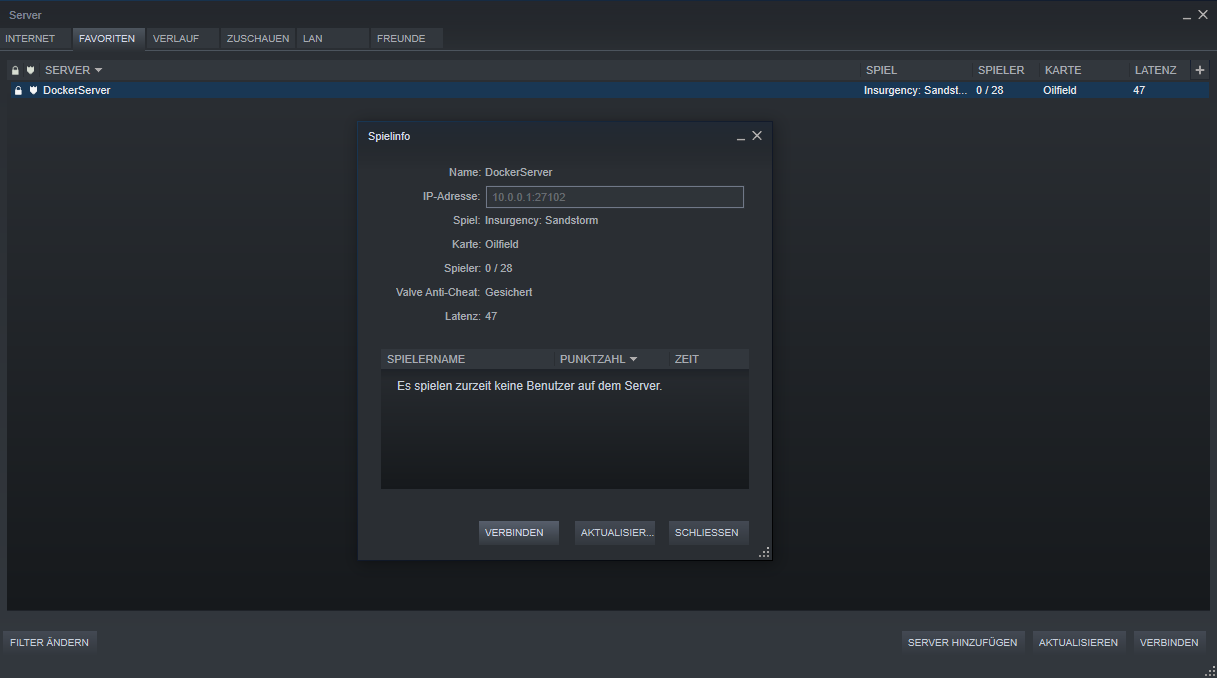

Is anyone still using the Insurgency Sandstorm docker? I used to work great and now it seems like the server never accepts any connections.
I will take a look at it when I'm home from work.
EDIT: I now downloaded the container and tested if I can connect and see it and this works just fine (since I'm not owning the game I can't test if I can connect to the server).
Edited by ich777
So based on your screenshot I manually connected via IP from withing Insurgency and also included the port. I was able to successfully connect. Previously I didn't need to include the port. I also noted that the server isn't showing up in the community server browser as it was before. Pretty sure my port forwarding is correct, as it hasn't changed. I'll have to dig into it some more.
EDIT: I'm a moron. My Steam GSLT was expired... Thanks for the help and the great dockers!
Edited by Smackover
