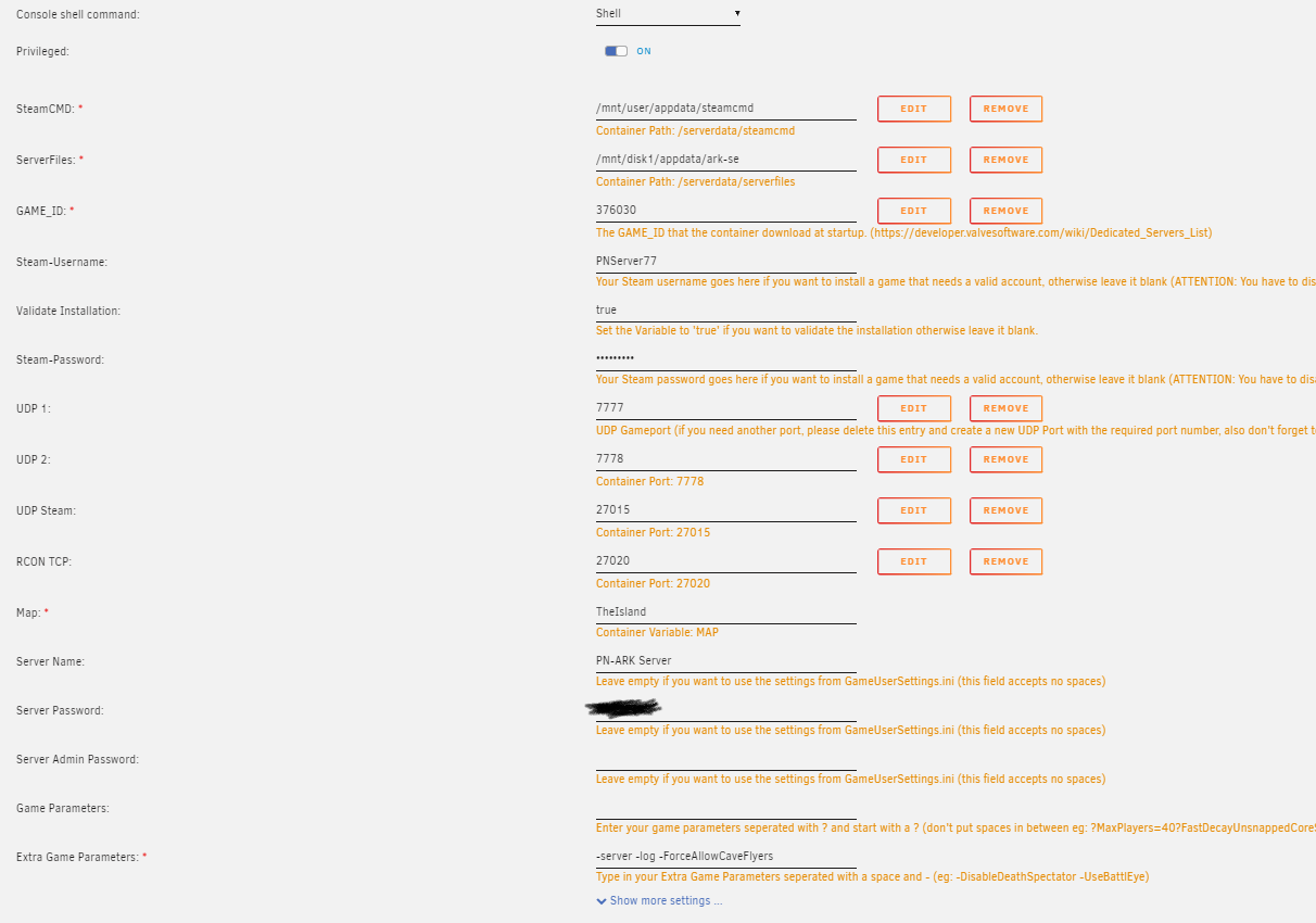

I have a problem updating my ARK server to the latest version it will stay on 3.10.68. I tried using true for the validation section of the server. I will see the validation but the server afterwards will not get the new version.
Here is my sartup log with the validation set to true:
---Checking if UID: 99 matches user---
---Checking if GID: 100 matches user---
---Setting umask to 000---
---Starting...---
---Update SteamCMD---
Redirecting stderr to '/serverdata/Steam/logs/stderr.txt'
[ 0%] Checking for available updates...
[----] Verifying installation...
Steam Console Client (c) Valve Corporation
-- type 'quit' to exit --
Loading Steam API...Warning: failed to init SDL thread priority manager: SDL not found
OK.
Logging in user '****' to Steam Public ...
Logged in OK
Waiting for user info...OK
---Update Server---
---Validating installation---
OK.
Logging in user '******' to Steam Public ...
Logged in OK
Update state (0x0) : Timed out waiting for update to start, bailing.
Error! App '376030' state is 0x204 after update job.
---Prepare Server---
---Server ready---
---Start Server---
[S_API FAIL] SteamAPI_Init() failed; SteamAPI_IsSteamRunning() failed.
Setting breakpad minidump AppID = 346110
This is my docker settings page:
I also tested with steamuser and pass with the steamguard disabled. Also tested without the user and pass being present but been getting that dreadfull Error! App '376030' state is 0x204 after update job. error which could mean dns issue. disks space issues or chache issues.
Cleared the cache and it was downloaded again from steam point of view. Disk space issue I don't know how to solve or if there are any. Currenlty the game is sitting on disk1 which is at 11% capacity.
Dns seems to be working fine.
Would be nice to get some pointers on this.
And off course keep up the good work.
Regards,
Mali.
---Starting...---
OK.
Logged in OK
---Update Server---
OK.
Logged in OK
---Server ready---
---Start Server---
Regards,
Mali.
In the last time i get a lot of reports that the ark container doesn't properly update.
Have you installed pihole somewhere in you network?
Also i also think Steam itself struggles a little bit with updates.
Look at thestats how many players are online...
I think they changed the way updadates are handeled.
For ark you don't have to insert a username and password.

Thank you for taking the time to answer.
I am not using pihole in het network. I used to host a csgo server and steam idd can be difficult at times.
I tested with and without a user just for testing.
Can I get a shell within the docker to do the update manually ? with steamcmd command?
Has the docker when it comes down to limits of disk space it can use?
Regards,
Mali.

In my containers if the username and password isn't marked as required you don't need it. ;)
Yes, click on it and select console then you have access to the console.
Type in 'bash' then 'su steam' and then you can update the container.
The path to steamcmd is /serverdata/steamcmd; to the serferfolder itself /serverdata/serverfiles this should be all you need, you also can use this command if you are inside the shell of the container: '${STEAMCMD_DIR}/steamcmd.sh +login anonymous +force_install_dir ${SERVER_DIR} +app_update ${GAME_ID} +quit' (without quotes) it will fill in the required paths automatically, simply paste it there. ;)
If you are done with everything type two times 'exit' (first time to logout the steam user and the second time to exit the container shell).
