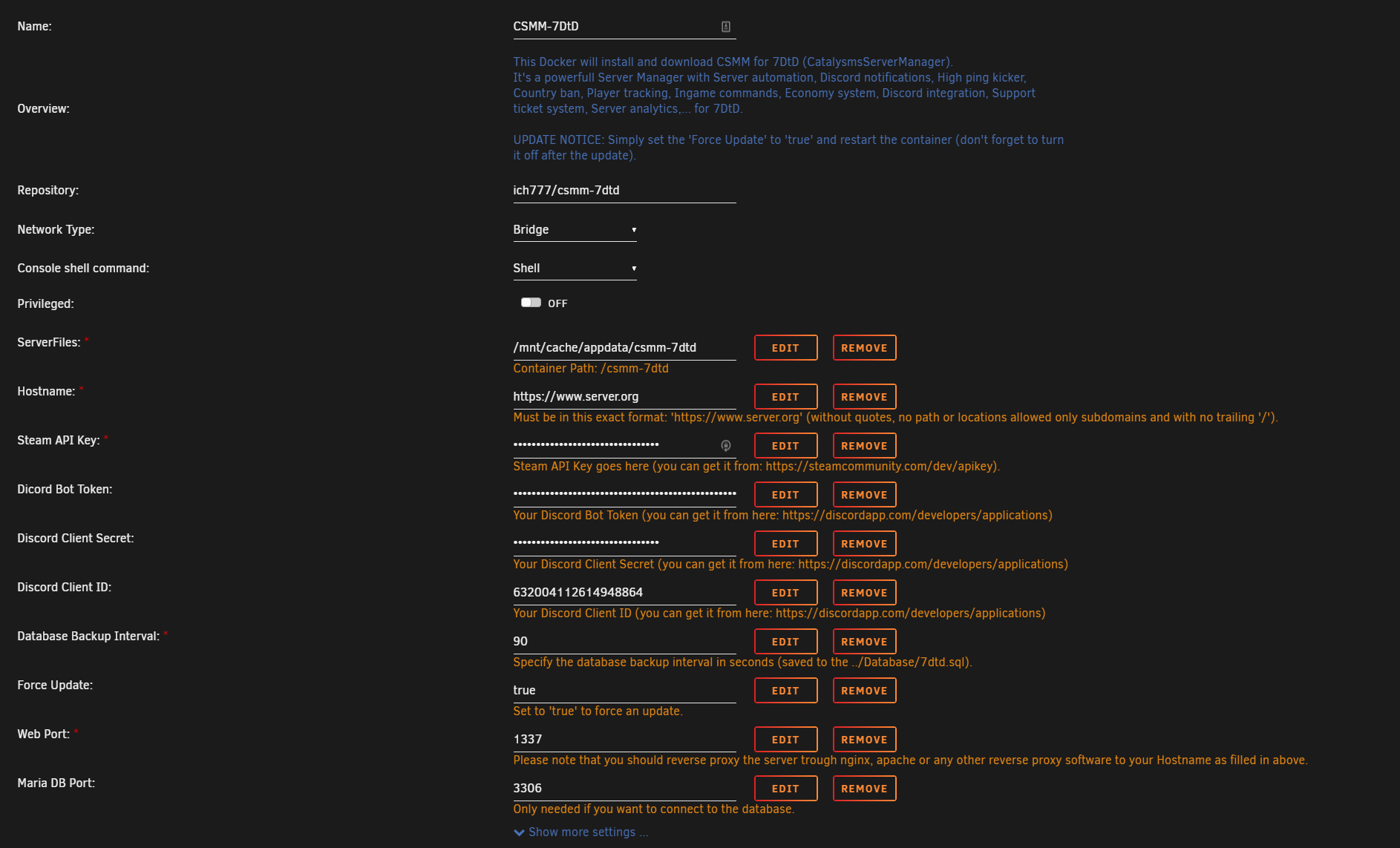

hello im having troubles setting up the csmm-7d2d docker and i have no idea what to set in the domain name area do i need to get my own domain or what do i need to do i have tried to set it to the example. but it aways fails do i need to set up a website for my 7d2d server to use this? sorry im new to both setting up servers and unraid. thanks for all the help and the awesome dockers!
---Checking if UID: 99 matches user---
---Checking if GID: 100 matches user---
---Setting umask to 000---
---Starting...---
---Starting MariaDB...---
---Starting Redis Server---
---Checking if CSMM is installed---
---Force Update activated, installing CSMM---
---CSMM successfully downloaded, please wait---
> [email protected] install /csmm-7dtd/CSMM/node_modules/uws
> node-gyp rebuild > build_log.txt 2>&1 || exit 0
> [email protected] postinstall /csmm-7dtd/CSMM/node_modules/core-js
> node -e "try{require('./postinstall')}catch(e){}"
[96mThank you for using core-js ([94m https://github.com/zloirock/core-js [96m) for polyfilling JavaScript standard library![0m
[96mThe project needs your help! Please consider supporting of core-js on Open Collective or Patreon: [0m
[96m>[94m https://opencollective.com/core-js [0m
[96m>[94m https://www.patreon.com/zloirock [0m
[96mAlso, the author of core-js ([94m https://github.com/zloirock [96m) is looking for a good job -)[0m
npm WARN [email protected] No license field.
added 1135 packages from 856 contributors and audited 5947 packages in 12.712s
1 package is looking for funding
run `npm fund` for details
found 481 vulnerabilities (72 low, 6 moderate, 401 high, 2 critical)
run `npm audit fix` to fix them, or `npm audit` for details
---Force Update finished, CSMM successfully installed---
---Prepare Server---
---Configuring Redis---
OK
OK
Background saving started
---Checking for old logs---
---Configuring CSMM---
---Checking if Databse is present---
---Database found, injecting, please wait---
---Start Server---
CSMM version: 1.12.0
debug: Please note: since `sails.config.session.cookie.secure` is set to `true`, the session cookie
debug: will _only_ be sent over TLS connections (i.e. secure https:// requests).
debug: Requests made via http:// will not include a session cookie!
debug:
debug: For more help:
debug: • https://sailsjs.com/config/session#?the-secure-flag
debug: • https://sailsjs.com/config/session#?do-i-need-an-ssl-certificate
debug: • https://sailsjs.com/config/sails-config-http#?properties
debug: • https://sailsjs.com/support
debug:
(node:270) [DEP0095] DeprecationWarning: timers.enroll() is deprecated. Please use setTimeout instead.
(node:270) [DEP0096] DeprecationWarning: timers.unenroll() is deprecated. Please use clearTimeout instead.
Edited by jb93
The log looks fine but i would use http instead of https for this container.
You have to set your domainname eg: http://csmm.yourdomainname.com or http://csmm.yourdomainname.duckdns.org (the domainname which you set at the Steam API Key creation because Steam will communicate with this domain.
No you don't have to setup a website because the container will just do that for you (I strongly recommend you to reverse proxy the port from the container - in your case 1337 - to your port 80 or 443) or you port forward the Web Port to port 80 or 443 (but that's very unsecure) in your router, but the last solution is really unsecure!
This container is not the best to start if you are new to this because it's a little difficulty to set up if you are not familar with this.
With the game containers it's a completely different story you just have to port forword the ports in your router and you're good to go, no further setup required.

Hi ICH777,
i've included the screenshot of the entire config here ->
game params -> +game_type 0 -usercon +game_mode 1 +mapgroup mg_active +map de_dust2 -tickrate 128 +sv_setsteamaccount XXXXX
I'm just joining the game and using in game console trying to get rcon setup using rcon_server "localip:27015" along with rcon_password "setpassword". Then using rcon status. which is throwing me back the error saying cannot connect to remote server.
I'll look into sourcemod but it doesn't look like there are any decent setups for docker containers or even an unraid app setup.
Can you please attach a screenshot from the rcon port opened with the edit button (background is that i've got an error in the old template so that the port is translatet wrong).
localip? You have to enter the server ip eg: 192.168.1.1:27015

Theres the edit button for the TCP rcon config.
i just got sourcemod/metamod installed.. still would like rcon access so i can change the game mode on the fly.. as well as kick bots and such.. so when you get a chance! thank you so much!
Did you configured the container in Custom br0 (or something like that) network mode? I think it has something to do with your network config also please don't use the ip adress there only the port but if you configured it in Custom br0 mode that you don't need to expose ports because the container has it's own IP and expose all port by default.
If you configured it in Host mode you have to expose ports but also the port alone without a ip adress.
If you configured it in Bridge mode it should be the same as in Host mode.

I'm currently using host mode on unraid. i've tried it with just the port itself if you look at the original post SS. it was just set the 27015. and still was having problems with it.

I think it's a pure network problem since it works fine on my server... Sorry but i can't help...
