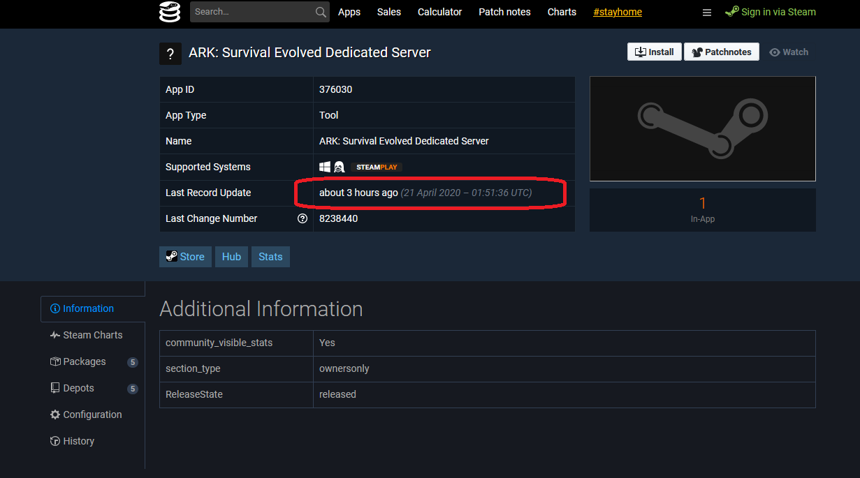

I'm running the Ark server off my SSD and it takes over 30 minutes for it to reboot. When I look at the logs it seems to spend a long time verifying and preallocating. I have the validate field blank in the container settings. Something I'm doing wrong or does it always take a long time to start? I'm tweaking the server settings file and it takes ages just to reboot the thing. Should I set the validate field to false instead of blank?
Yes you can set it to 'false' but it has no effect, only if you set it to 'true' it will trigger a validation process.
(I know this game is sometimes a mess - or should i better say takes a long time - to install and to update)
But chances are big that you've been unlucky and there was an update in the meantime, look at the screenshot:
