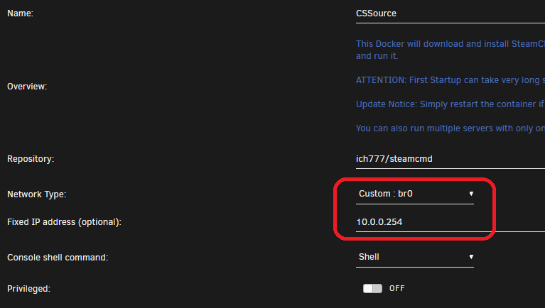

I am running the Factorio Docker. Thanks btw. I would like to run 2 of them. So I installed another. Changed the name so it has it's own Appdata and everything. I can see both published to the factorio multiplayer browser if I change the UDP port but I can't change the container port so I can not connect. Is there a way to change the container port so they don't conflict with each other? Thanks!
EDIT
So I did some more researching. I clicked "add another port, variable" etc and added another port. I tried 34196 and 34198 and neither of them worked. I changed both the container port and host port to those. Set it for UDP. It would show up on the server browser in game but I couldn't connect. Soon as I switched it back to 34197 it would connect. I would like both dockers to run simultaneously as I have 2 different Factorio games we would like to play. I had all of those ports forwarded in my router as well. Thanks for the help.
Where did you change the port number in the game config and in the template? To wich port do you changed it?
The first thing that i would try is if it is enough that you change only the host port and then open the corresponding ports in your router.
If that doesnt work i would recommend you to change the port in the game config delete the existing port from the template and create a new one with the corresponding port numbers for container and host port.
If that also doesn't work (the second solution works for me since i've tested this) you can always set the Network mode to 'Custom: brX' and assign a static ip to it (no port change needed since the container has it's own static IP address in your network).
Please keep in mind if you set it to 'Custom' you have to port forward the custom provided ip and port.
If there ever will be a dedicated server fell free to reach out to me again and i will look into it (from my research dedicated servers should come in the near feature...)
I changed it in the template.
So are you saying to edit the container and change the network dropdown to something else? I dont see Custom:brX

Can you provide a little bit more information and answer the questions otherwise i can't help.
Hav you tried my other two solutions?

I changed it in the template. I had port forwarded and a static IP for the dockers already. If I don't change the docker container port from 34197 I can only run one of them at a time. But if I change the docker container port then one of them wont be able to be accessed. It will show on the factorio multiplayer finder but will not allow a connection.
You have two active factorio servers that are up pointing at the factorio servers? Allowing other players to connect?
19 minutes ago, jagr200 said:
I thought I did answer the questions. Did I not?
Nope, wich port did you change the existing one or did you create a new one?
If you change the existing one that's not my recommendation because of the problem that you have right now NAT doesn't work very well with the gameserver.
Please try to change the gameconfig to another port, then delete the existing in the templatr and create a new one for UDP with the port number the same as in the config and for container and host, that should do the trick.
Yes i can connect to both of the servers. ;)

Is gameconfig in the server appdata? Because I clicked on the docker icon and clicked edit. Then I deleted the UDP settings and changed them to 34196 and 34198 to see if either would work and they did not. Would you mind posting a screencap of your settings so I can see what I am doing wrong?
I can't, because i deleted the factorio servers allready (installed them only for testing).
But look in your template if you got this option and give it a seperate IP on your network than you don't have to deal with different ports:

7 hours ago, AnhedonicNeko said:
I am new to unraid and am trying to run a modded MinecraftBasicServer docker, and I have it working locally (I can connect to it via the 192.x.x.x address). However, I have a couple problems, the first is I can't connect to it from my external IP. I do have the port forwarded to the 192.x.x.x port. I don't see any option in the template to change to allow it to connect externally.
The second is that changing the port from the default 25565 makes it no longer able to connect regardless. I notice there is a port mapping on the docker tab which shows a 172.x.x.x address, and that port never changes off of 25565 when I change the port. I have changed the port in both the server.properties and on the docker template. The 192.x.x.x shows the port change on the port mapping, but the 172.x.x.x one never changes. I am guessing that this port mapping is also why I am unable to connect externally.
I've tried changing from Bridge to Host, all that did was remove the port mapping on the docker tab, it otherwise functions the same as above. As a side note, it shows the server pop with an X below it on the Internal connection (but still lets me connect), and on the External connection it just says it can't connect, and "connection refused:no further information" when I try to connect externally.
Edit: Changing to host instead of bridge allowed me to change the port now for the second issue. But I'm still unable to access the server externally. Ports in router were updated to reflect the changed port.
You don't have to change the network mode from the container.
A little explanation: The containers got an own network range and they NAT (network address translation) from their address to the host (in your case from 172.... to 192....). If you want another port you have to simply go into the template and change the port on the host side from 25565 to anything other that you like (I don't recommend that because some game server like NAT from one to another port).
If you do it like you did it (change also the port in your server.properties) you have to delete the port inside the template and create a new one (please choose the right protocoll TCP or UDP for minecraft i think it's TCP) with the container port and host port corresponding to your server.properties (this is the way i recommend).
For the first problem i can't really help you have to Port forward 192.... and the corresponding port in your router/firewall to allow traffic from outside.
I got many reports about that and i think many internet providers block specific ports (eg: my older ISP blocked for example 22, 23, 80, 443 and all ports from 1024 - 49151 no matter what you configured in your router i had to open a ticket that they open it for me)
