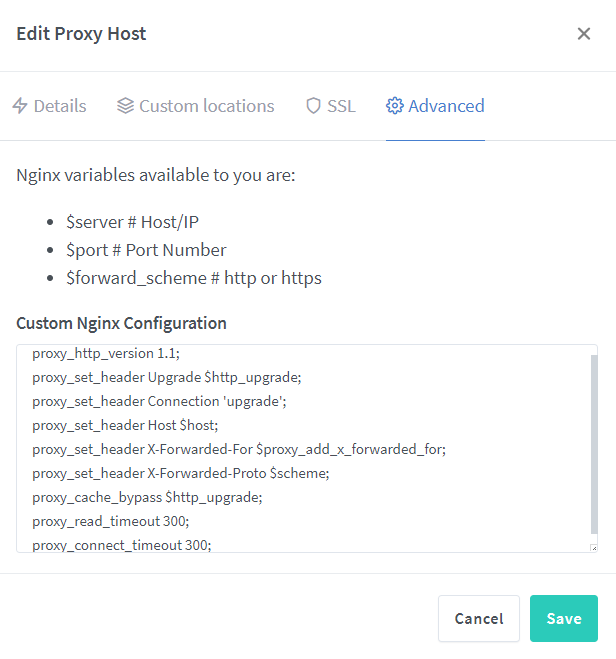

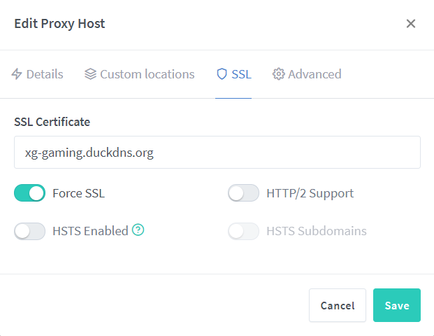

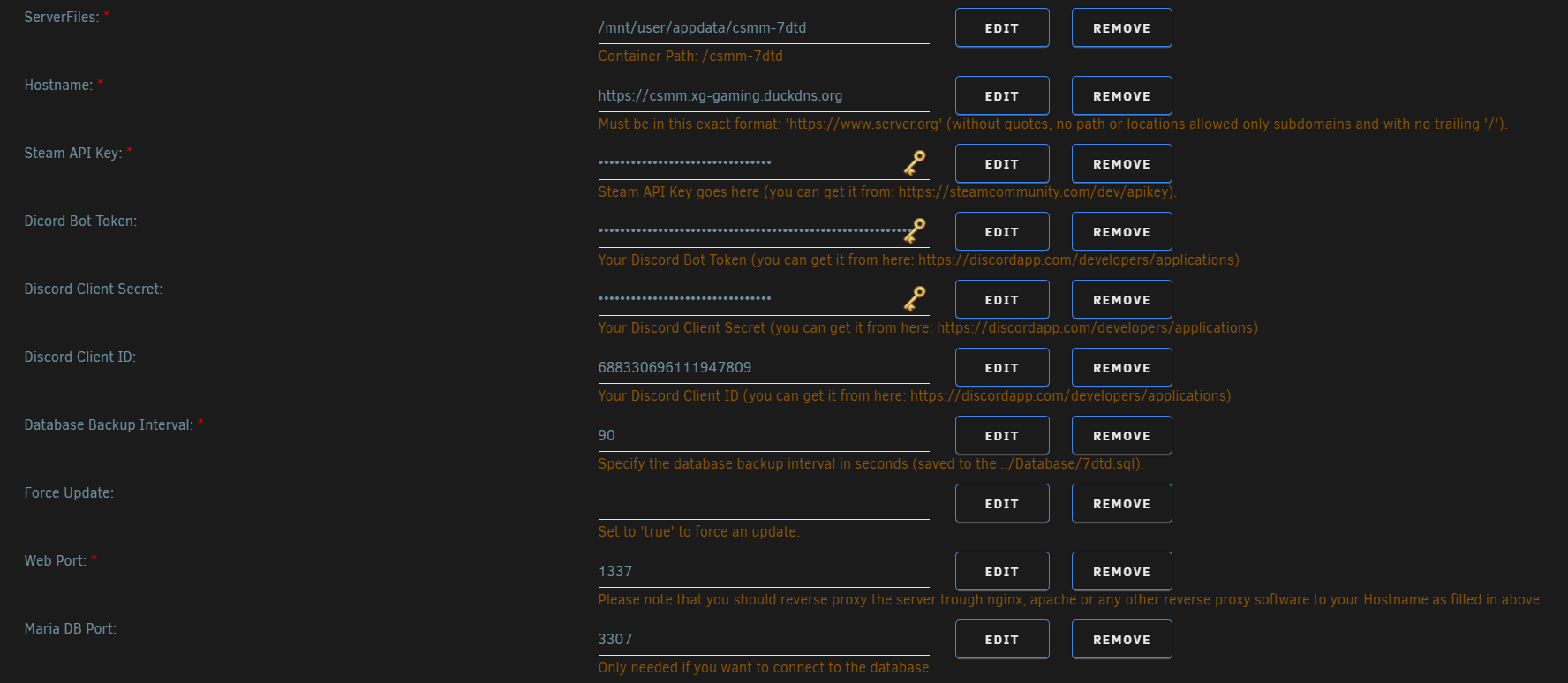

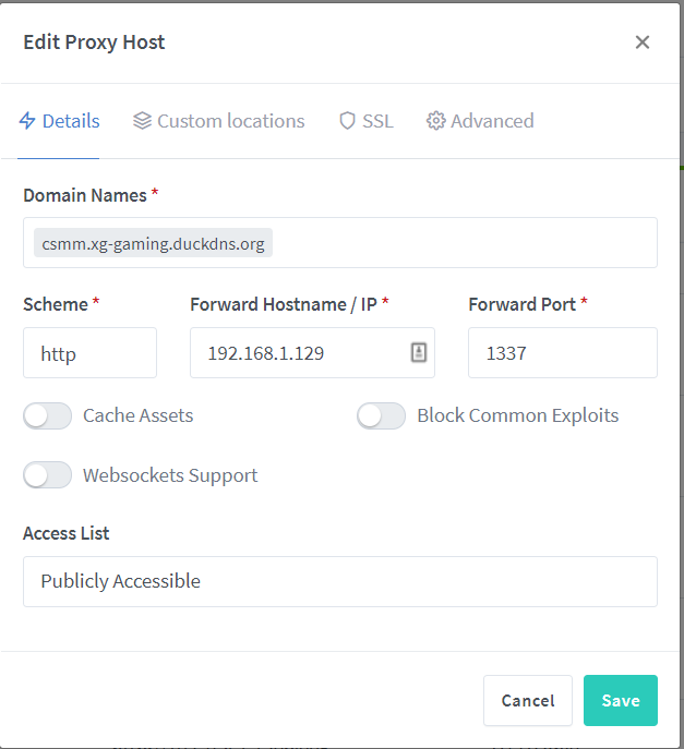

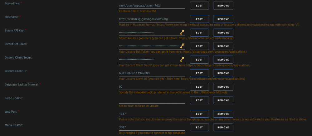

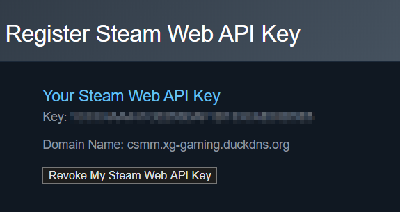

Edited by Natcoso9955
Added screenshots

1 hour ago, Natcoso9955 said:
I was using that as an example only. everything is set to csmm.xg-gaming.duckdns.org
In the template try 'http' instead of 'https'.
I changed to http, and also removed the cert from proxy ( and obviously removed the force SSL), still getting 502 error.
This is the address that is generated after clicking signin on steam. (i have broken each & parameter into a new line for easier reading) obviously as this comes from steam, this would be the default url generated by steam when a website has a signin with steam module, but even this appears to be going to the correct address (unless for some reason the return to is wrong, http%3A%2F%2Fcsmm.xg-gaming.duckdns.org%2Fauth%2Fsteam%2Freturn = http://csmm.xg-gaming.duckdns.org/auth/steam/return)
This is the url from the CSMM page with 502 error:
(again broken on & parameter for easier reading)
Sorry i've tried this with my domainname and it works flawlessly.
But i also use the Let's Encrypt container from Linuxserver.io with a reverse proxy.
What settings did you use?
And your saying you can sign-in with steam and it redirects back to csmm?

So looking in CSMM log, im 99% sure issue is with database. @ich777 should i be able to access db outside of the docker? ie using adminer docker?
Because i dont seem to be able to.
2020-05-22T04:47:45.130Z - warn: Error during steam auth!
2020-05-22T04:47:45.130Z - error:  message=Unexpected error from database adapter: ER_NO_SUCH_TABLE: Table '7dtd.user' doesn't exist, name=AdapterError, name=AdapterError, adapterMethodName=find, modelIdentity=user, code=ER_NO_SUCH_TABLE, errno=1146, sqlMessage=Table '7dtd.user' doesn't exist, sqlState=42S02, index=0, sql=select `createdAt`, `updatedAt`, `id`, `steamId`, `discordId`, `username`, `avatar`, `admin`, `banned` from `user` where `steamId` = '76561198024157322' limit 2, isOperational=true, stack=AdapterError: Unexpected error from database adapter: ER_NO_SUCH_TABLE: Table '7dtd.user' doesn't exist
    at Deferred._.extend._WLModel [as _handleExec] (/csmm-7dtd/CSMM/node_modules/waterline/lib/waterline/methods/find-or-create.js:220:15)
    at Deferred.exec (/csmm-7dtd/CSMM/node_modules/parley/lib/private/Deferred.js:286:10)
    at Deferred.tryCatcher (/csmm-7dtd/CSMM/node_modules/bluebird/js/release/util.js:11:23)
    at ret (eval at makeNodePromisifiedEval (/csmm-7dtd/CSMM/node_modules/bluebird/js/release/promisify.js:184:12), <anonymous>:14:23)
    at Deferred.toPromise (/csmm-7dtd/CSMM/node_modules/parley/lib/private/Deferred.js:572:19)
    at Deferred.then (/csmm-7dtd/CSMM/node_modules/parley/lib/private/Deferred.js:431:22)
    at process._tickCallback (internal/process/next_tick.js:68:7), adapterMethodName=find, modelIdentity=user, $ref=$["cause"]["raw"]
I have connected via the console and can see that the database is missing all the tables that it failed to inject. So the issue is with CSMM and how it tries to put data into the database.
MariaDB [7dtd]> use 7dtd;
Database changed
MariaDB [7dtd]> show tables;
| Tables_in_7dtd            |
| analytics                 |
| banentry                  |
| commandreply              |
| countryban                |
| cronjob                   |
| customcommand             |
| customcommandargument     |
| customdiscordnotification |
| customhook                |
| gblcomment                |
| gimmeitem                 |
| historicalinfo            |
| hookvariable              |
| player                    |
| playerclaimitem           |
| playerteleport            |
| playerusedcommand         |
| playerusedgimme           |
| role                      |
| sdtdconfig                |
| sdtdserver                |
21 rows in set (0.000 sec)
So I decided to look through the start.sh, which pointed to start-server.sh
Looking in here, i found the command to insert data into the database. (modified with full folder path below)
mysql -u "csmm" -p"csmm7dtd" 7dtd < csmm-7dtd/Database/7dtd.sql
When you run this manually you get an error.
ERROR 1064 (42000) at line 389: You have an error in your SQL syntax; check the manual that corresponds to your MariaDB server version for the right syntax to use near 'CHARS' at line 13
So i decided to rename the 7dtd.sql file and let it recreate.
However this time it is missing player and some other tables.
I think the timeout needs to be changed in the start-server.sh script, and/or how its set, as per below its using depreciated code.
(node:248) [DEP0095] DeprecationWarning: timers.enroll() is deprecated. Please use setTimeout instead.
(node:248) [DEP0096] DeprecationWarning: timers.unenroll() is deprecated. Please use clearTimeout instead.
Im going to assume that if it times out creating all the tables in DB then it doesnt work.
