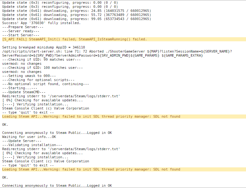

13 hours ago, ich777 said:
So everything is working now?
EDIT: Malbolgia is writing about the ARK Container and I think you are writing about the Terraria Container or am I wrong?
The ARK Conter functions completely different and there was an issue with the linux files on SteamCMD.
Yes everything is working now! 😁
Binaries were updated from linux point of view.
I have one additional question. If you click on the log of the docker server you will get this overview:

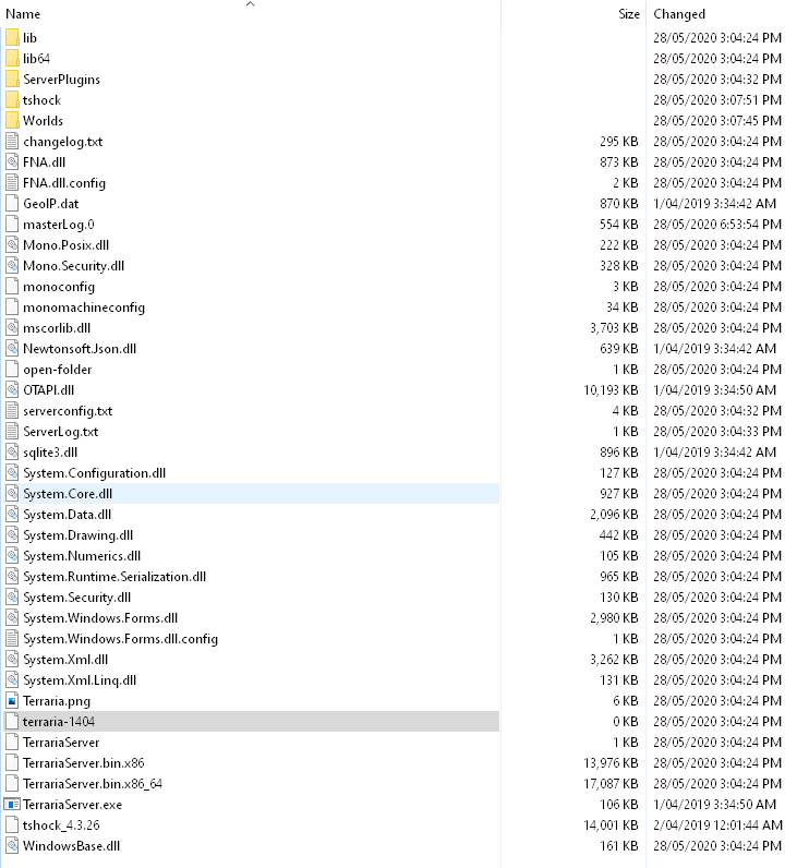

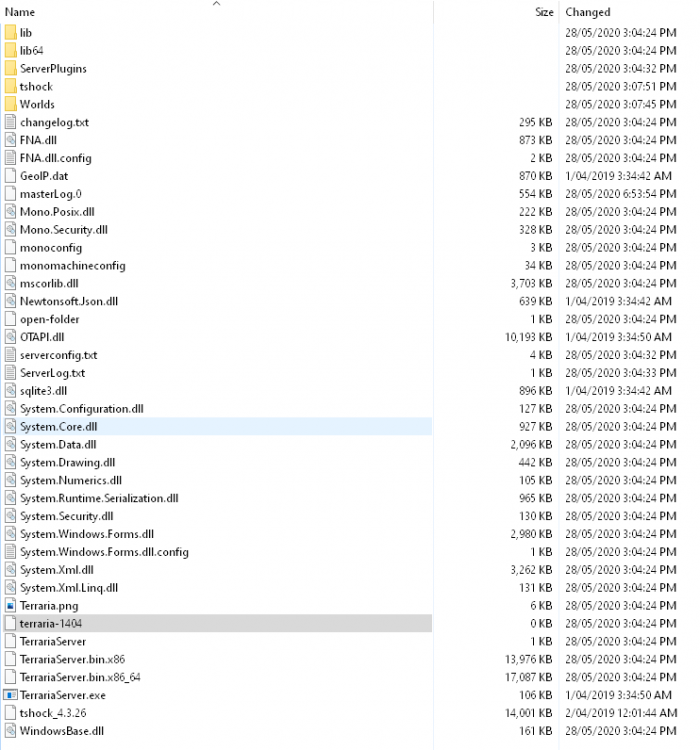

That's actually the TShock Mod. ;)
Can you send me a screenshot from your Terraria folder?
Also I currently have pulled Terraria TShock from the CA App since I personally don't own the game and can't test anything (will drop support and also pull it from the CA App for every game that I don't own and can't test if someone reports an error).
OH, hahaha (thats embarrassing. lol)
Im guessing the terraria-1404 is the file you where looking for.
Also id be willing to help pay for some of these games. (if im needing help getting it working, for instance, Terraria is only $15)
Don't get me wrong but if I had to buy every game...
Get not much Donations and without them I won't be able to support it and don't want to get a headache if I had to write with someone that's not in my timezone... :D
But if this file is in the main directory version 1.4.0.4 is installed, I think this has something to do with the TShock mod that it displays it wrong...

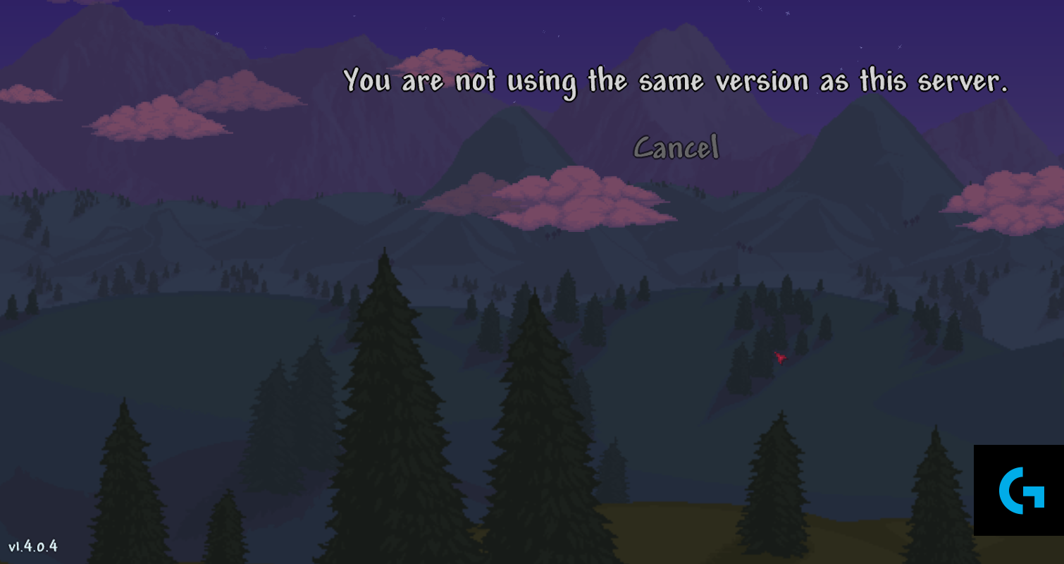

Im going to try and install manually (place zip in root and see what happens.)
If you only place it in the directory nothing will happen.
Same issue,
I think it's the TShock mod as i said. ;)
It reports always this verision...
I deleted all the files (except the world, and tshock folder) your script does a check for the terraria files, because it wasn't there but the zip was it extracts the zip.
Even the zip from terraria website gave me the version mismatch error. (In game when trying to join from client)
I am contemplating using the same zip but the windows version on my PC and seeing if I still get error if so, then I think it's a terraria issue.
Will keep you posted.
