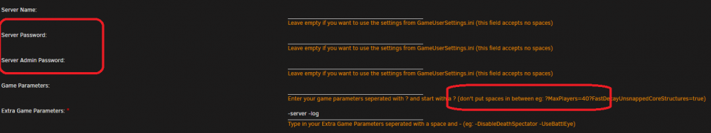

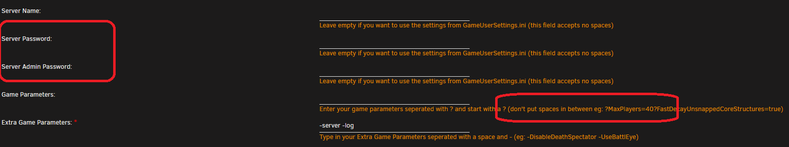

I have been running into some issues with the ich777 Ark: Survival Evolved docker selectively overwriting hand-edited portions of my GameUserSettings.ini, in particular:
[ServerSettings]
ServerPassword=SrvPass
ServerAdminPassword=SrvAdminPass
[/Script/Engine.GameSession]
MaxPlayers=70
I make sure to stop the docker before consoling into Unraid's file system, making and saving the updates, like setting MaxPlayers=10, and then start the docker, however the server then has MaxPlayers=70. I have run into this as well setting the above two passwords.
I can set these values in the "Server Password", "Server Admin Password", and "Game Parameters" in the Edit page of the docker, but am curious what I am doing wrong that is causing portions of my GameUserSettings.ini to be overwritten.
Thank you in advance!

@bubo Can you help please?
But i think the container overrides the values because you set them in the Docker template, have you also seen the Game Parameters, there you can set also all that you can do as in the config file. ;)

Thank you for the reply! I was seeing the overridden values in GameUserSettings.ini, even when the Docker template values for Server Password or Server Admin Password were blank. That being said, if I put my Server Password, Server Admin Password in the Docker template, and MaxPlayers in Game Parameters, the appropriate values are set in my server on the next startup. It's actually rather odd, it seems as though some parameters (like XPMultiplier) aren't overridden if I modify them in GameUserSettings.ini, as opposed to passing them through the Docker template Game Parameters.
I think they changed something how ARK works and what is overridden and what not.
