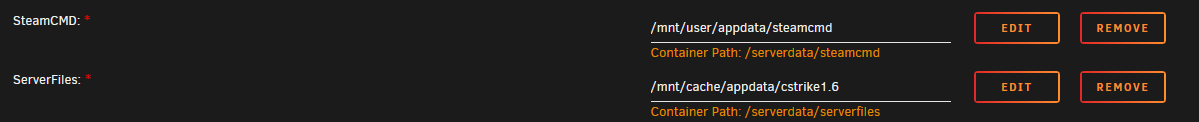

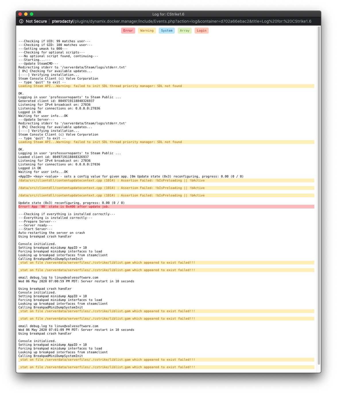

Trying to install CS 1.6. Any thoughts on this?
813031319_ScreenShot2020-05-06at7_04_28PM.thumb.png.f88a0e75fb358b8ba89d3b9ec1039541.png
Have you installed a cache drive in your server? If so please change the path from '/mnt/user/appdat...' to '/mnt/cache/appdat...' like in this example:
If not you have to specify the disk on wich your appdata folder with the containing CS1.6 is instead of the cache.
