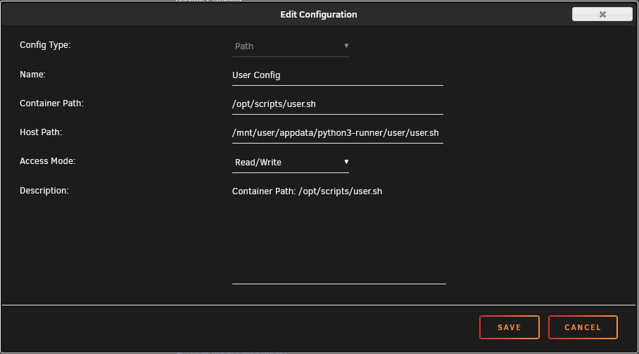

Yes, that's the problem with the collections and workshop ID's since with the ArmA3 container it is necessary that you own the main game and has nothing to do with the dedicated server.
I would not make this with another variable since the main game ID wouldn't change anytime soon...
With the Workshop ID's you have to don't use curl...
You can mount the file directly into the container like in this screenshot (also wouldn't recommend to use symlinks because they are not persistant if you change anything in the template or if i release a update):
Did you think it is necessary to do it with the Collections or would the Workshop ID's (sperated by SPACE) like in the Conan Exiles container be enough?
