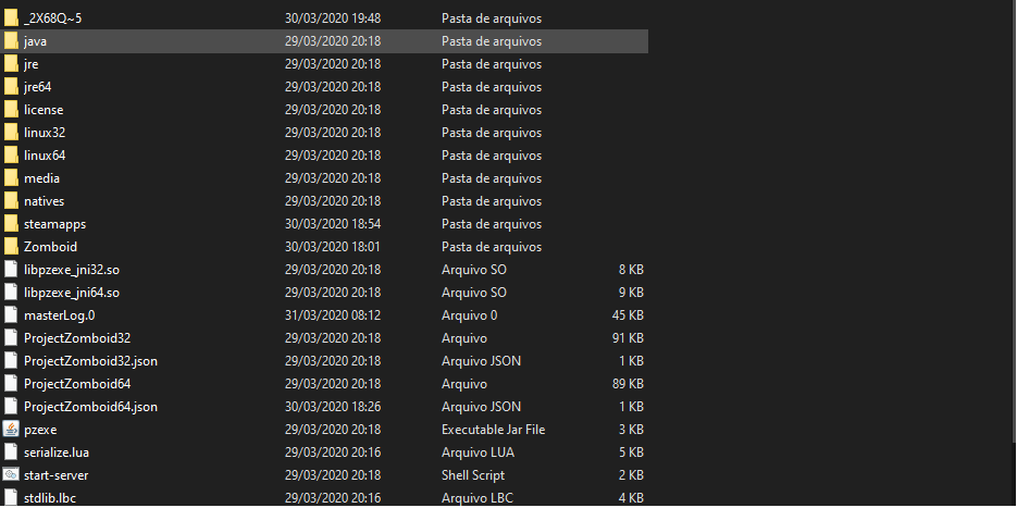

I'm having some trouble with the Project Zomboid docker, when it creates the server, he's building a blank template server.ini file, ignoring the server.ini I had editted and thus not implemeting the mods in-game. Any idea what it could be?
I will look into that when i got home.
So it overwrites your file or have you two server.ini files in the directory?
Can you try to edit the server.ini file that it creates or past the content from your server.ini to that?
It creates a new directory, that first one with new server files and run from that, ignoring the Zomboid folder and files in there. I can edit the file however it doesn't load the mods even after restarting the server.
Can you give me a link to a tutorial how to install mods on Zomboid? Which mods do you want to install so i can try it?

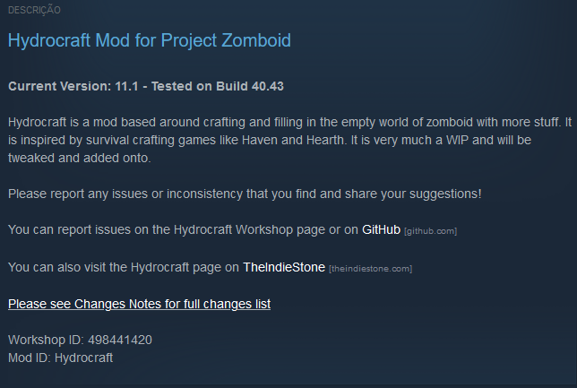

1 hour ago, ratosaude said:
Can't really give a link, since it's bits of information here and there, but it's quite simple. There's two lines inside server.ini that you need to fill that's modId and workshopItems. Usually they provide both in the steam workshop page of each mod, if it doesn't the workshopItem is in the address bar of the mod and the modId you would need to download in steam workshop than go to your steam instalation folder>steamapps>workshop>content>108600(PZ steam id)>mods and find the mod.info file which contains the modId. And inside the .ini you separate them with a ";" for each mod you want. There's 4 mods I want installed: hydrocraft, zombie loot extended, orgm and show damage.
How did you install the mods in the container with SteamCMD or did you copy over the mods from your windows/mac machine?
EDIT: The container download the file servertest.ini you have to edit this file (within your SERVERDIRECTORY/Zomboid/Server)
Edited by ich777
This goes back to my initial post, after I edit this .ini and run the server, it creates a ghost directory with new files running standard and ignore every other file I edited.
