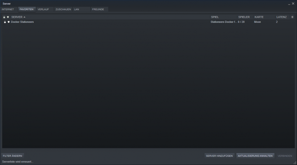

You can, go to View -> Servers -> Favorites -> Add Favourite -> Enter the IP:PORT -> Add server to list -> Refresh -> it now should show up
(I'm not 100% sure if it's named like this since i'm using Steam in german but you will probably find it)

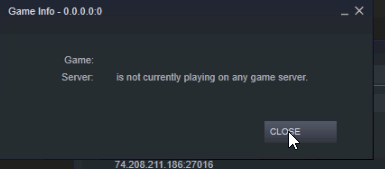

when i tried to connect from my pc
and when my friend tried to add it wont let him add it.
Have you clicked refresh? I know this error after adding the server and double clicking it bevor clicking refresh.
Sorry but i don't own the game and i will pull it from the CA App if you confirm once more that it doesn't work.
(Also i see you try to connect to 27016 in the background? Did you change the port?)

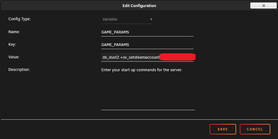

Every time I try running a Gmod server, even as a fresh install without any addons, it never starts and the log shows this:
Segmentation fault
Add "-debug" to the /serverdata/serverfiles/srcds_run command line to generate a debug.log to help with solving this problem

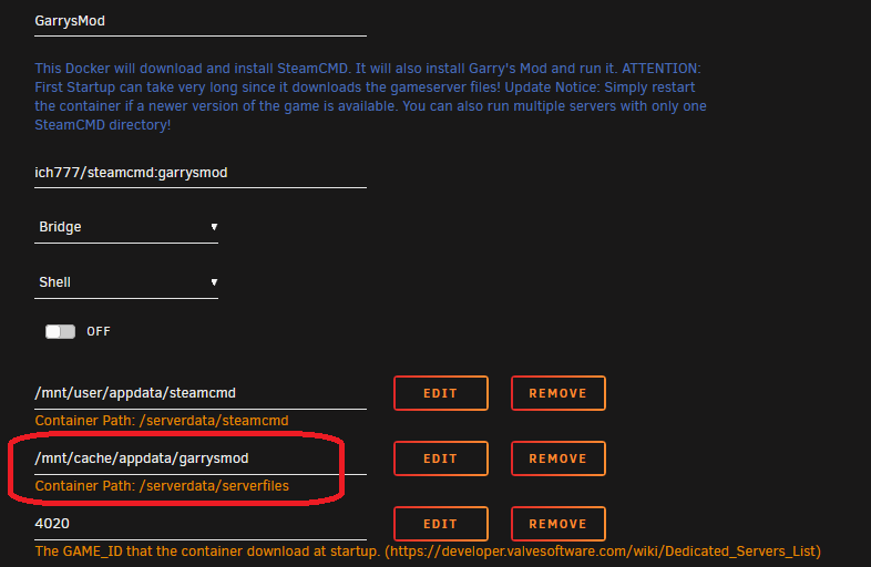

If you are on Unraid 6.8.2 or lower and you have a cache drive installed please change the path to the gamefiles to /mnt/cache/...
If you are on Unraid 6.8.3 everything should work without changing anything, i also attached a screenshot...
Edited by ich777

There is something wrong with the download of the gamefiles please check if the links in the docker template are working, many servers which host the exilemod go offline and i can't find a consistent hoster that hosts the files always...
(One thing is that you can try is that you change the GameFiles path to /mnt/cache/... -if you have a cache drive installed)
9 hours ago, spacecops said:
I am on the most recent version of Unraid, and I was not using a cache.
There is a good chance this is a Gmod issue, since your SCP server runs just fine with near identical settings on the same share (only difference being port)
There lies the problem, for some containers you must use a cache drive otherwise they will not work (Don't Starve Together is also such a container) i don't know why this is, this problem exists since Unraid version 6.8.0
Edited by ich777
Does it need the game files or server files?

I'm trying to host a CS:GO server.
I've got a static IP, I've port forwarded the port to my server, and it's not online.
I was sure where I was supposed to put in the login token (screenshot added).
I've added a screenshot of my setting.image.thumb.png.67b8dcbc443f16e4a00c1781845e744c.png
The docker log says this:
[S_API FAIL] SteamAPI_Init() failed; SteamAPI_IsSteamRunning() failed.
I've tried to look through everything. But I can't get it to work. Does anyone have a beginners guide to it?
30 minutes ago, Nanobug said:

So it should look like this, if my token as "1234":
+game_type 0 +game_mode 0 +mapgroup mg_active +map de_dust2 +sv_setsteamaccount1234
Is that correct?
I'm just trying to get it to work at first, then I will run it with a different IP.
Is that correct?
There is one space missing between '+sv_setsteamaccount' and your generated token (btw the token is much longer than 1234 like in my example)
eg: +game_type 0 +game_mode 0 +mapgroup mg_active +map de_dust2 +sv_setsteamaccount 1234567890ABCDEFGHIJ1234567890AB
Also it should be possible to see it in the steam server browser if you run the server on your network (see a few posts above)
Like in this post but please be sure to change the ip and port to your configuration:
