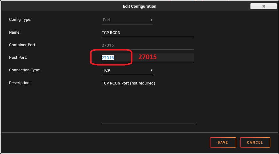

Trying to get rcon working in CSGO, I've tried a few differnet additions to the game parms +rconpw PASSWORD and +rcon_password PASSWORD but i cant seem to access it when playing, not sure if i'm doing this correct. I also tried adding a server.cfg file to /appdata/csgo/cfg folder, but didnt seem to make a difference....any advice?
I would set it in the server.cfg file not as an extra startup parameter, also did you forwarded the TCP port for rcon?

Yes, Port Set below, I will remove it from the GAME_PARAMS section, reboot and see if it works. there was no server.cfg generated by the server when I installed it, so i created my own....it only has rcon_password my_server_rcon_password in it

I have a question, i am running the csgo docker and I can connect to the server and all. But I do not know how to send commands to the server? The console dropdown in the docker tab doesnt show anything, I cant get RCON to work and I even tried to install sourcemod/mettamod to try to send commands to the server this way. Do you have any clue on what I am doing wrong here?
So i investigated the "problem" first of all there were a typo in my template you must change the RCON Port to the follwing:
And the second thing to you have to do is that you have to append '-usercon' (without quotes) to your 'GAME_PARAMS' in order to enable RCON.
(Sorry was completely my mistake since i've taken the old startup server commands from old windows server and copied them over to the container and not enter them properly in the container).
Template is allready fixed and should be available in the next few hours if you see that the port is fixed and the option '-usercon' is added if you download it again from the CA App.
Thanks for the quick fix and finding your time to help me, this indeed fixed the issue about not being able to Rcon into the server. But now I do have some more questions.
