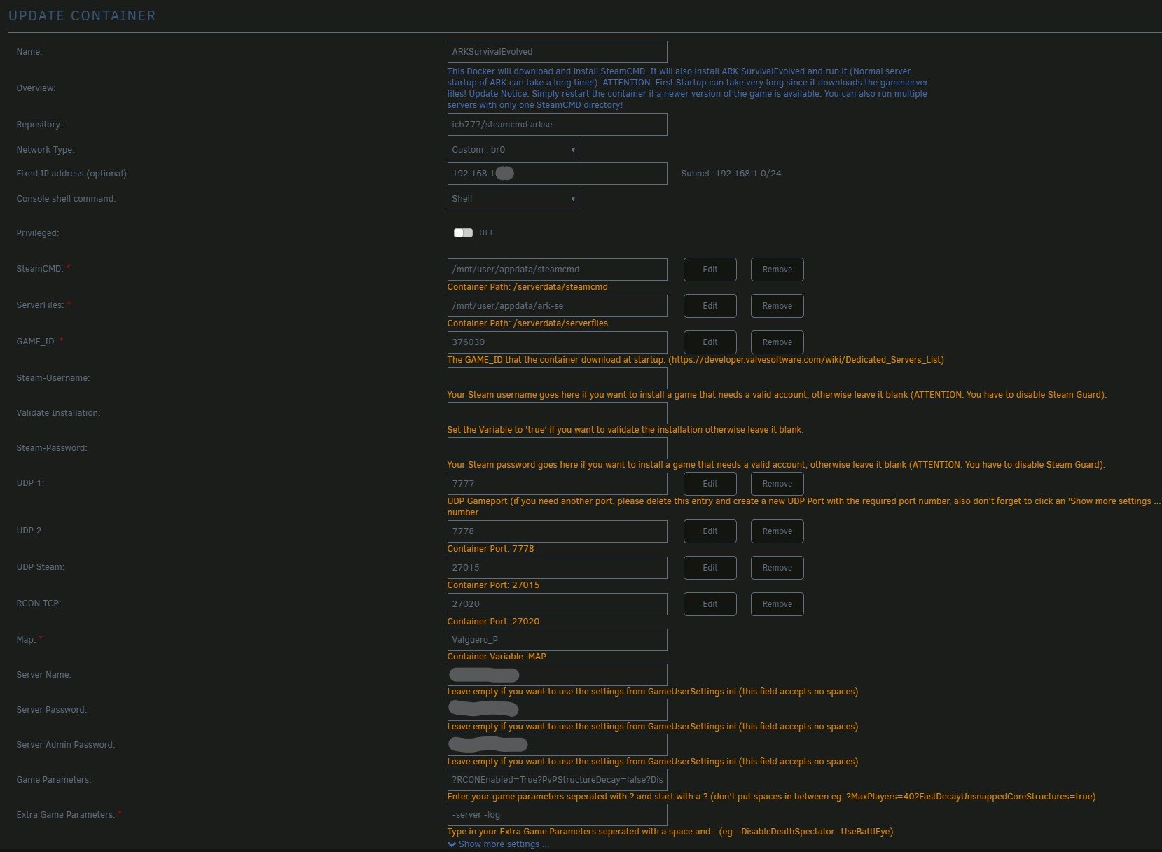

Which is any of the containers (Please specify the containers that are not working)? I got 3 running and have no problem at all.
Can you also post a screenshot of the template page?
Right, Sorry! :D
I have 3 Ark-SE containers and they are all stuck in boot loop.
2 of them I've had a couple of months (since before x-mas) and the third is new since today when I first noticed the problem.
Is this the info you are looking for?
