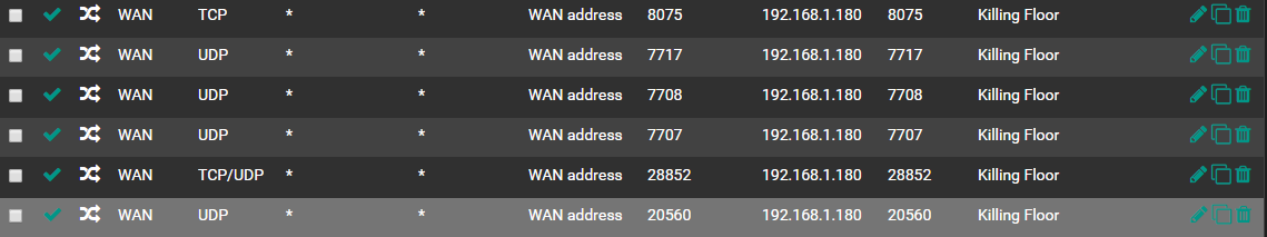

Hey. Trying to get a killing floor server running but I'm running into some issues accessing it anywhere but from my LAN. I have it set up and running with the default configuration and I can query and connect to it using my server's local IP address but no luck connecting from outside.
Here is my relevant NAT configuration if it helps (pfSense)
Is there anything I'm missing? From my understanding this should just be accessible outside of my network, right?

This looks all correct and should be working, are you sure that your ISP doesn't block some ports?
On which port did you connect to the container from outside? Have you already tried to connect through the steam server browser? Have you got a static IP v4 or a dynamic?
Since i'm not very familiar with pfSense (i'm using IPFire) i really can't help if there is anything misconfigured.

As far as I know my ISP isn't blocking anything. I have inbound and outbound NAT set up on my router so those ports should be fine.
As far as what's working, I can connect to the server on my lan using port 7707, and I can view it in the steam server browser using the query port 28852.
If I try to connect/query using those same ports on my public IP (or through my DNS that resolves the address correctly) I haven't had any luck. I also can't see the server in the ingame server browser but I'm sure that a symptom of whatever the problem is.  I'm kind of at a loss because I have a reverse proxy set up through letsencrypt and duckdns and have had no problem connecting to the service that I have running on it. Is it possible that letencrypt is affecting something? I think my IP is dynamic but even using the DNS doesn't seem to help.
Also, I tried hosting another server (sven coop) and ran into the same problem, was able to connect/query locally but couldn't access the server on the public IP after forwarding the required ports.

But i hope you don't reverse proxy the ports through letsencrypt....
I can tell you that the sven coop server works perfectly fine over the internet since i have one on my server running.
I will create a killing floor server on my unraid server, please write me a short pm so that i can give you the ip adress and you can try to connect.

The ports are not on the reverse proxy. I'll shoot you a pm and try to connect when I get home.

I think you should contact your ISP for further details since you can connect to my server...
