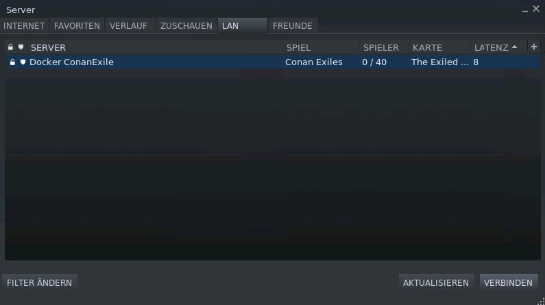

Hey ich777. First of all thanks for all the work you've done with these dockers. I started having an issue with Conan Exiles docker. I believe they changed something in their dedicated server app and now it's not working. I saw some people having similar issues with pc dedicated server app too.
 I'm getting 002b:fixme:wininet:InternetSetOptionW Option 77 STUB and it keeps going on like that. It used to work a month ago or so and didn't change anything on my machine. I also did a clean install but still getting the same issue. Is it possible for you to take a look at it when you have the time? Many thanks in advance!
I will look into this.
Only for info, this is actually a WINE warning (since this container runs with WINE).
EDIT: No problem here, attached the log and also a screenshot where it shows that is up and running. Can also connect to the server without no problem. Please report back if the problem persists for you (Also get that warning from WINE but that can be ignored).
Log: Conan.log
Screenshot:
EDIT: I dug in more and apparently it's a issue on the game's end. Server does not show up on sever list in-game and it's not possible to connect using steam connect BUT if you go in-game and direct connect using the server ip, it connects.
Thanks for looking into it so quickly. It's still not working. I can see it on steam servers list but not in game. When I click on connect from steam, I get the error "Unable to connect to server, app id specified by server is invalid"  I checked the game_id on the docker and compared it with the steam server list. It is correct so kinda stuck again. I attached my log here too. Thanks again.log.txt
