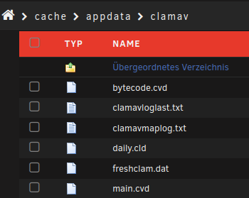

Here the Files from the appdata Folder.
# ls -la /mnt/user/appdata/clamav/
total 361649
drwxrwxrwx  2 nobody users           9 Feb  5 22:06 ./
drwxrwxrwx 33 nobody users          33 Nov  3 21:38 ../
-rw-r--r--  1    100 console    291965 Apr  7  2023 bytecode.cvd
-rw-r--r--  1 root   root          990 Feb  5 18:00 clamavloglast.txt
-rw-r--r--  1 root   root          895 Feb  5 18:00 clamavmaplog.txt
-rw-r--r--  1 root   root          215 Feb  5 18:00 clamavtargets.txt
-rw-r--r--  1    100 console 198986752 Feb  5 18:00 daily.cld
-rw-r--r--  1    100 console        69 Apr 24  2022 freshclam.dat
-rw-r--r--  1    100 console 170479789 Apr 24  2022 main.cvd
Edited by Revan335
