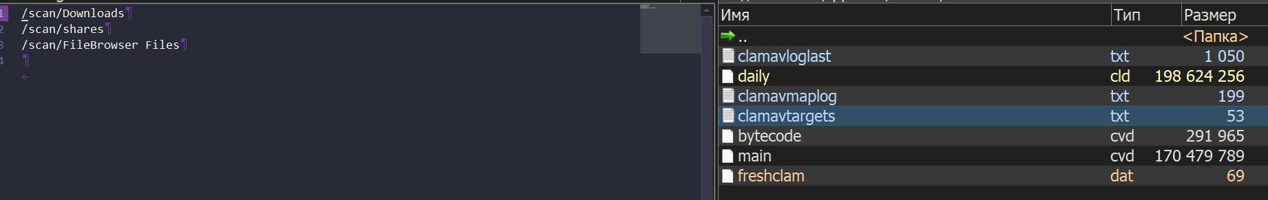

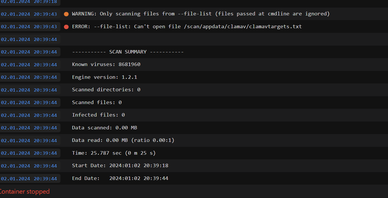

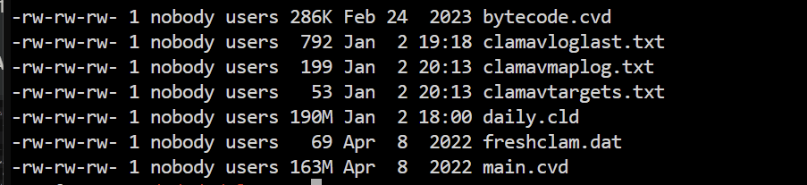

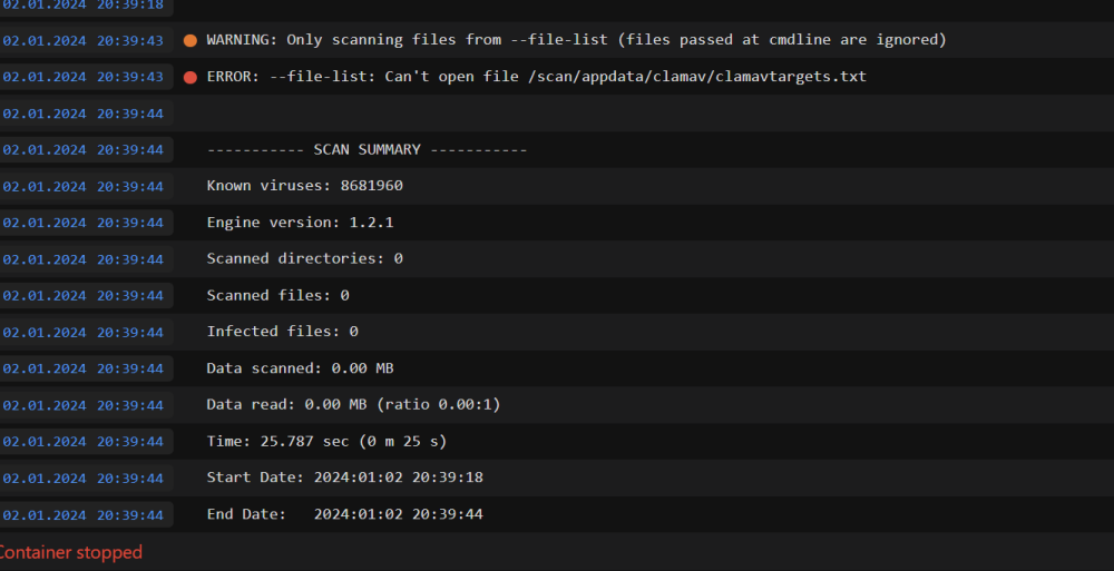

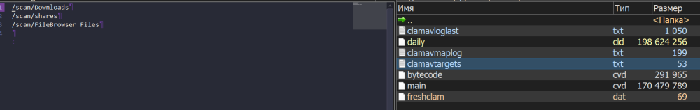

i Found a container has error , but worked befor , using user script and when just running container
had other perrmision but changed to chmod 666 , and added --file_list instead -f , but nothing changed
it seems that appdata not avalible from container when its hard linked and not bind mounted
Fixed by changing to
--file-list=/var/lib/clamav/clamavtargets.txt

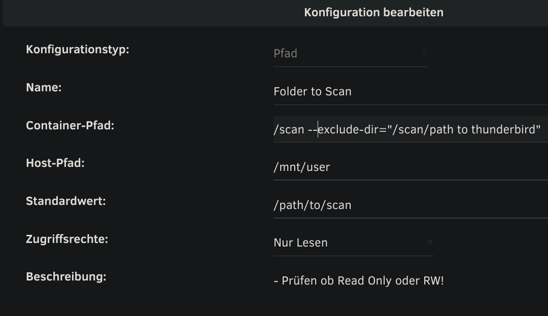

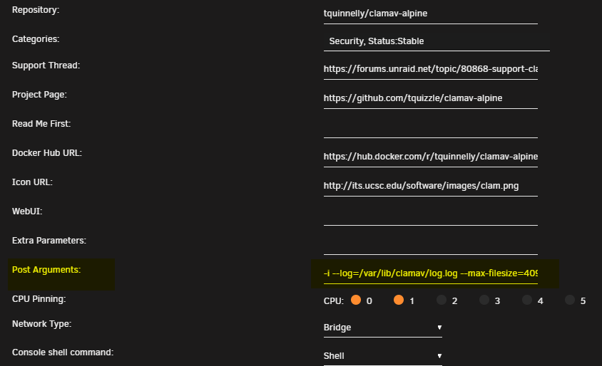

You will need to use post arguments. by default /scan is the target for av to scan.
By default, /mnt/users is set to /scan in the docker.
so add this clamav scan option
--exclude-dir="/scan/path to thunderbird"
Edited by bmartino1

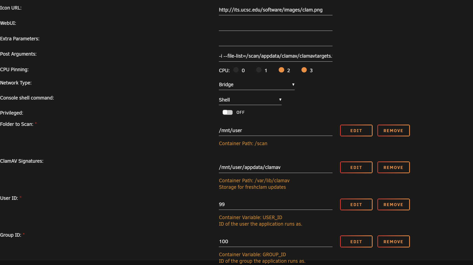

Do you mean this?Screenshot_20240115-095553_Firefox.thumb.png.e498f9850ea164d3a2addddd9a4f0dc2.png
Edited by Revan335
It's further up on the screen.

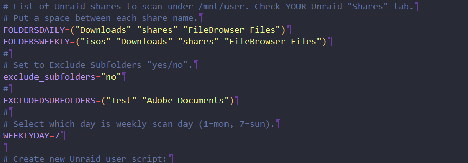

I'm working on script to add subfolders exclude, will post here and in github. Thank you for original script
@Refrigerator @Revan335
Updated script to exclude subfolders, no need for post arguments :
Please check and confirm that working Fine who is needed.
# Set to Exclude Subfolders "yes/no".
exclude_subfolders="yes"
EXCLUDEDSUBFOLDERS=("Test" "Adobe Documents")
@Masterwishx How can i scan all Folders with your Scripts? With "*" or * on the Folders Parameters? For example can all under /mnt/user without the excluded Folders (from the excluded Folders Parameters).
Is this the correct Arguments for that?
-i --max-filesize=4096M --max-scansize=4096M -f /scan/appdata/clamav/clamavtargets.txt
This is not required? Why the Script have a log Parameter/Function.
--log=/var/lib/clamav/log.log

Hint: The database directory must be writable for UID 100 or GID 101
An error occurred (freshclam returned with exit code '2')
Why have the Docker Template the UID 99 and GID 100 when we must have 100 and 101?
You should only set file-list parametr for scan like this:
-i --file-list=/var/lib/clamav/clamavtargets.txt --max-filesize=1024M
the script put the folders you want to scan in this file ,also made log files ,so no need for log parametr
So in script you need to add Folders you want to Scan and if you need to exclude add subfolders and set "yes" for exclude_subfolders:

 Please try with this
# Get a list of all folders in your specified directory
FOLDERSDAILY=($(ls -d $HOSTSCANDIR/*))
Edited by Masterwishx
Can you fix this in the template? @TQ

Do you have 99:100 permissions for Folder clamav As in container?
