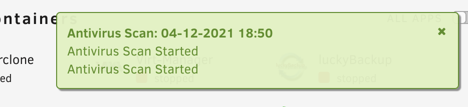

On 4/18/2021 at 8:32 AM, SmokeyColes said:
Great thank you, "Antivirus Scan Started" and the schedule is set in User Scripts.
I am a little confused - what is it actually scanning?  Every disk in the array or just dockers?
Once it finds a file, does it inform you and does it treat it?
Thanks
Chris

OK, I used an infected testfile but I get no notification.
ClamAV 0.103.3/26373/Sat Dec 4 09:32:50 2021
Scanning /scan
LibClamAV Warning: Bytecode run timed out in interpreter after 5000 opcodes
LibClamAV Warning: Bytecode 78 failed to run: CL_ETIMEOUT: Time limit reached
/scan/data/2_read/.sync/Archive/eicar_com.zip: Win.Test.EICAR_HDB-1 FOUND
/scan/data/2_read/eicar.com: Win.Test.EICAR_HDB-1 FOUND
----------- SCAN SUMMARY -----------
Known viruses: 8581021
Engine version: 0.103.3
Scanned directories: 32429
Scanned files: 133491
Infected files: 2
Data scanned: 95934.23 MB
Data read: 2209284.16 MB (ratio 0.04:1)
Time: 15151.955 sec (252 m 31 s)
Start Date: 2021:12:04 17:50:13
End Date: 2021:12:04 22:02:45
is it only me with and my setup is wrong?
Do you get a notice when ClamAV detects a virus?
